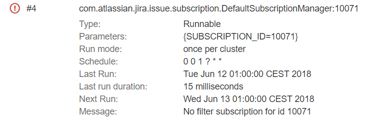

Under Administration Setting > System > SYSTEM SUPPORT > Scheduler details we see an error in some of the schedulers, after clicking Show more we observe an error like "com.atlassian.jira.issue.subscription.DefaultSubscriptionManager:XXXX"

We face this error when the subscription ID is not present in JIRA database but JIRA is still try read it. Due to this, it shows an error in the Scheduler Administration section.

We have to remove the Scheduler entry (for the invalid subscription) from JIRA Database.
  • To verify the entry
1 select * from clusteredjob where JOB_ID like '%XXXX%';
ℹ️ For each error replace XXXX with the entry we see in the error "com.atlassian.jira.issue.subscription.DefaultSubscriptionManager:10071" .
  • To delete the entries
1 DELETE from clusteredjob where JOB_ID like '%XXXX%' and ID = ZZZZ;
ℹ️ Replace ZZZZ with the ID we get from the first query.
