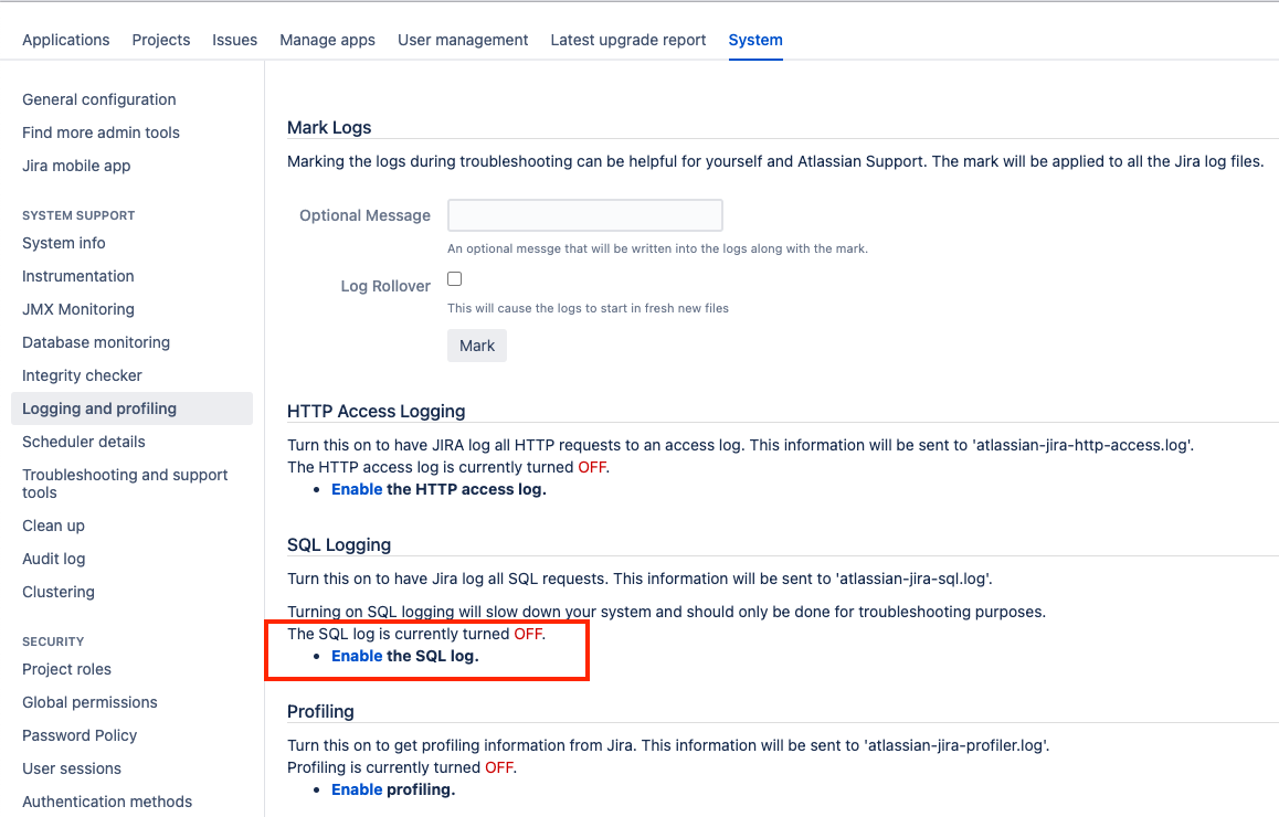

  3. OfBiz:
    1. Enable SQL logging below:
      Enable SQL Logging
    2. The resulting logs will be in <JIRA HOME>/log/atlassian-jira-sql.log.

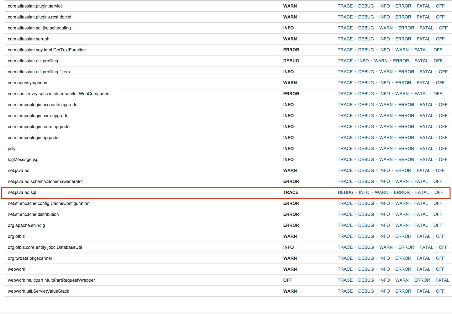

  4. Active Objects:
    1. Search for net.java.ao.sql and set it to TRACE:
      AO SQL

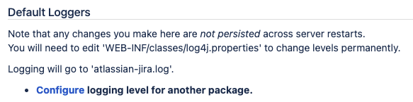

    2. In the logging page, click at the Configure option as shown below. Add the package com.querydsl.sql and set it to TRACE:
      Default Logger Jira
    3. The resulting logs will be in <JIRA HOME>/log/atlassian-jira.log.
