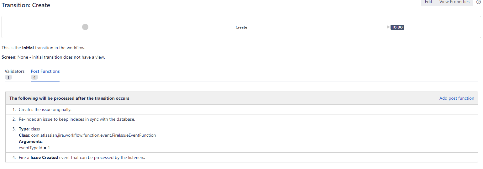

  1. When viewing the post function of the affected transition, you can see multiple post functions firing the same event
    1. In the above example, there are 2 post functions firing events. Post function #4 is firing an 'Issue Created' event, while post function #3 is firing an event of typeID=1.
