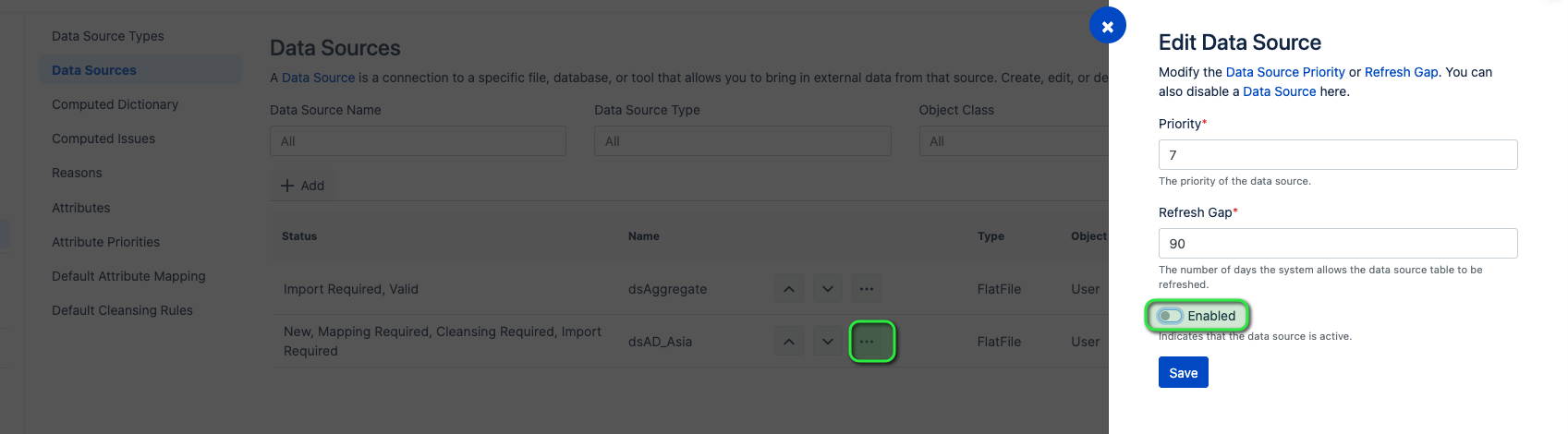

How to disable a data source:
  1. Access the link https://YOUR-SITE.atlassian.net/jira/servicedesk/assets/data-manager/#/basedata/datasource
  2. Find the data source to be disabled and click the three dots.
  3. Turn off the "Enabled" button.
