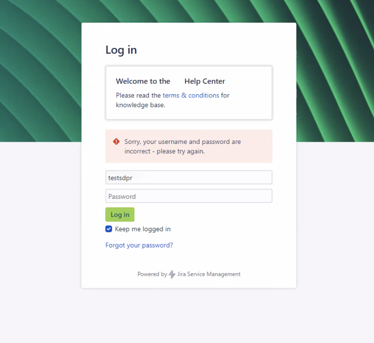

All local Jira Service Management customers and agents, including local admin accounts, are not able to log into Service Management at all. The following error is seen on-screen:
1 Sorry, your username and password are incorrect. Please try again.
The following generic authentication error appears in the atlassian-jira.log:
1 2014-10-30 13:06:41,806 http-bio-9000-exec-3 anonymous 786x735516x1 1j5qh57 198.76.89.7,184.28.17.74,204.156.15.149,127.0.0.1 /servicedesk/customer/portal/13/user/login login : 'servicedeskcustomer' tried to login but they do not have USE permission or weren't found. Deleting remember me cookie.

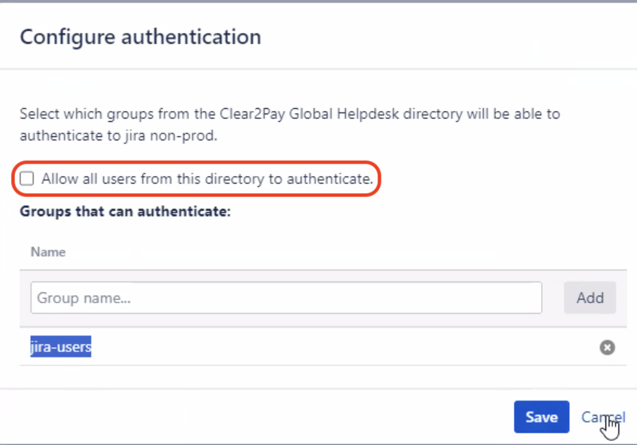

In Crowd:
  • Make sure the directory associated with the Jira application has the option Allow all users from this directory to authenticate set to true. To do this:
    • Log into the Crowd application
    • Click on the Applications menu from the Top Bar Menu
    • Search for the Jira application and click on it
    • Locate the right directory, and click on the "X group" link in the Who can authenticate column
    • Tick the option Allow all users from this directory to authenticate and save the changes
      This ensures that customers created through Jira Service Management are created properly in crowd and can authenticate even though they are in no groups.
