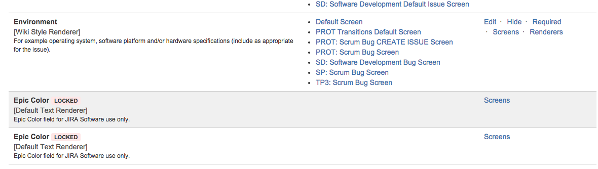

  1. For example, screenshot below shows an example of 2 Epic Color fields in the same Field Configuration:
  2. It is possible to have multiple custom fields with the same name. However this problem relates to a single field having multiple configs in the Field Configuration. Hence the duplication of the config also needs to be verified from the database side.
