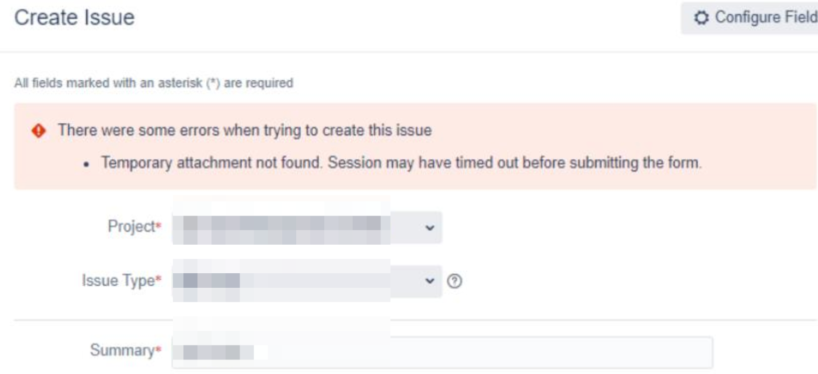

The following error is displayed when creating a Jira issue: "Temporary attachment not found. Session may have timed out before submitting the form.".

  • Issue gets created successfully even if the error message is displayed.

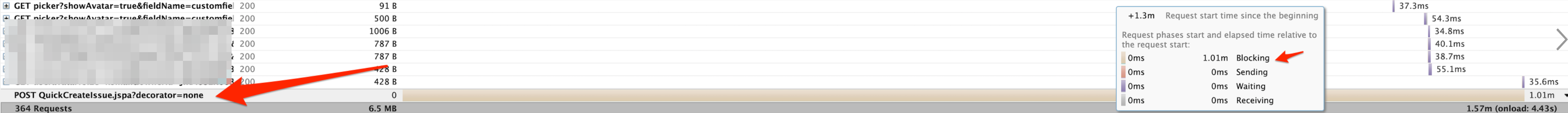

  • Generating a HAR file and analyzing web requests shows the following result:
    • QuickCreateIssue.jspa?decorator=none request timeout after 60 seconds:

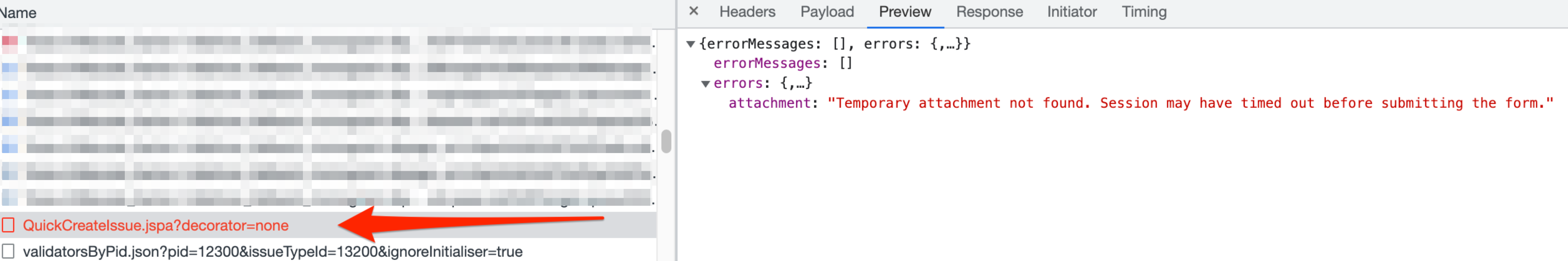

    • Error can also be seen on the HAR response:
