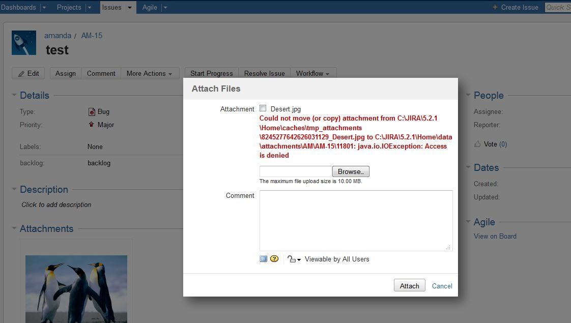

When attaching files to an issue, a java.io.java.io.IOException: Access is denied is thrown and the below error appears in the browser:
The following appears in the atlassian-jira.log:
