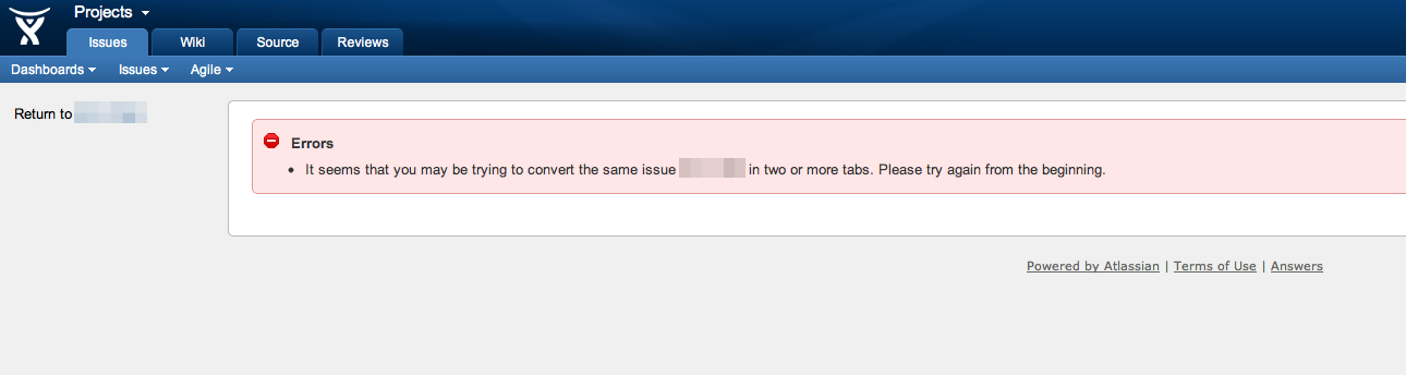

In some cases, you may come across an issue when you are converting an issue to a sub-task. One of the possible messages you may encounter is the following:
It seems that you may be trying to convert the same issue XXX-YYYY in two or more tabs. Please try again from the beginning.
