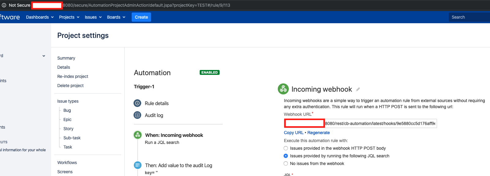

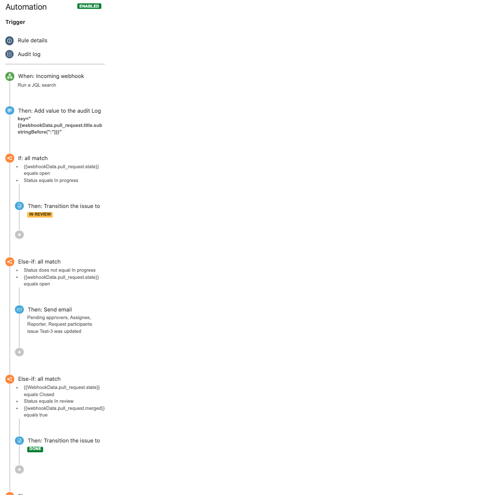

We need to configure an incoming webhook rule in automation for Jira, which can trigger a notification if the status is matched or unmatched with a custom notification when a pull request is triggered with respect to an issue.
Below is a sample rule that will receive a webhook from Github and then strip out the Issue Key. The rule will check the status of the issue. If the pull request is open and the status of the issue is In Progress, then the issue is transitioned to In Review. If the pull request is open and the issue status is not equal to In Progress, then an email will be sent out. If the issue is in In Review status and the Pull request is being merged, then the issue can be transitioned to Done.
