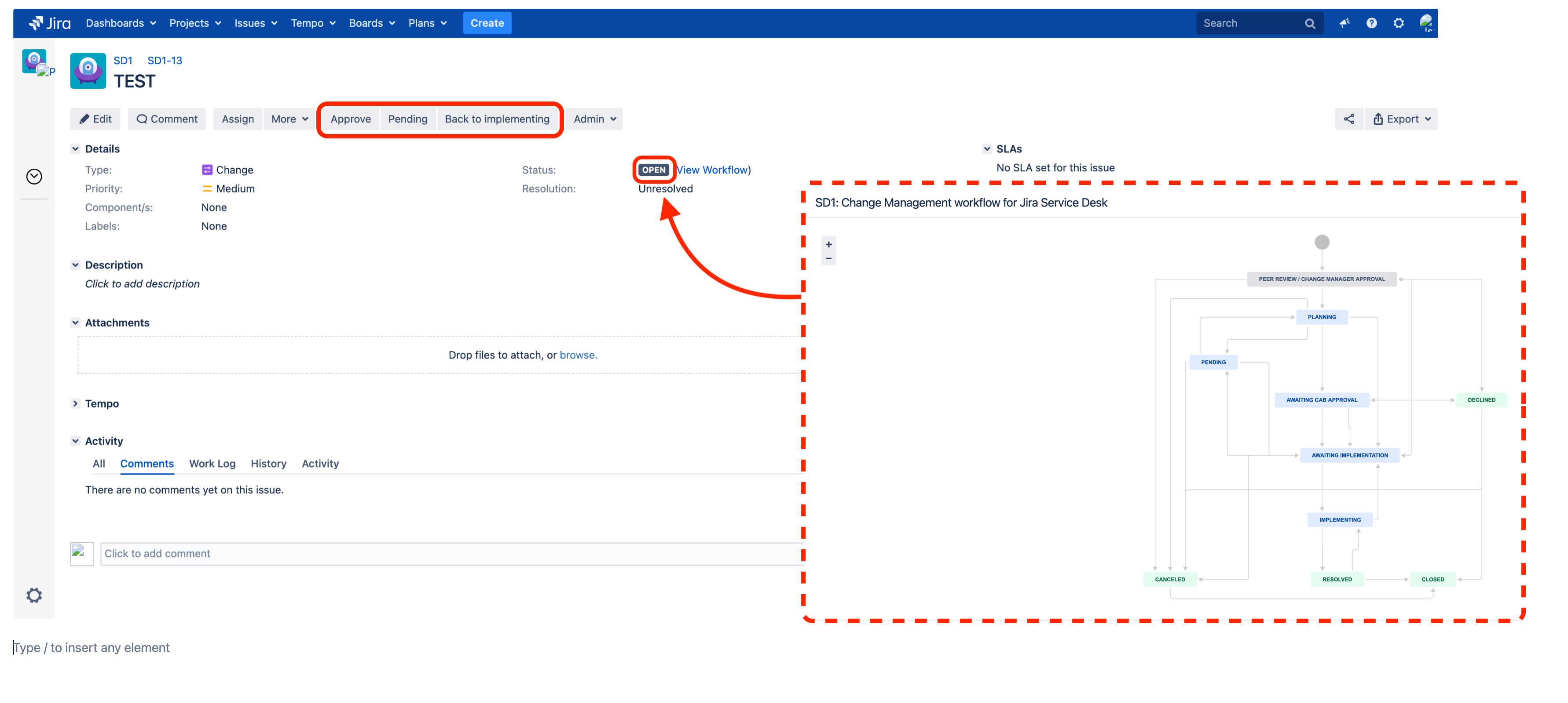

When we update Jira issue type via automation rule, the issue type seems to be updated but the workflow transitions are missing/incorrect and the issue still associated with the previous workflow status from the issue view.

  • There's no error in the logs but the trait to this, is that the issue status does not match the current associated workflow and the workflow transitions are missing/incorrect despite user has permission to transition the issue.

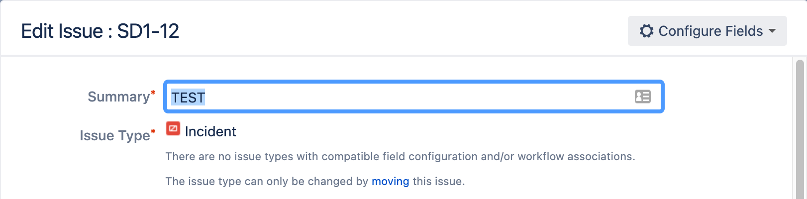

When we attempt to manually update the Jira issue according to the same use case (Incident → Change) via Edit issue, Jira reminds us that there are no other issue type sharing the same workflow. If there are other Issue types sharing the same workflow, it will be listed as options to change.

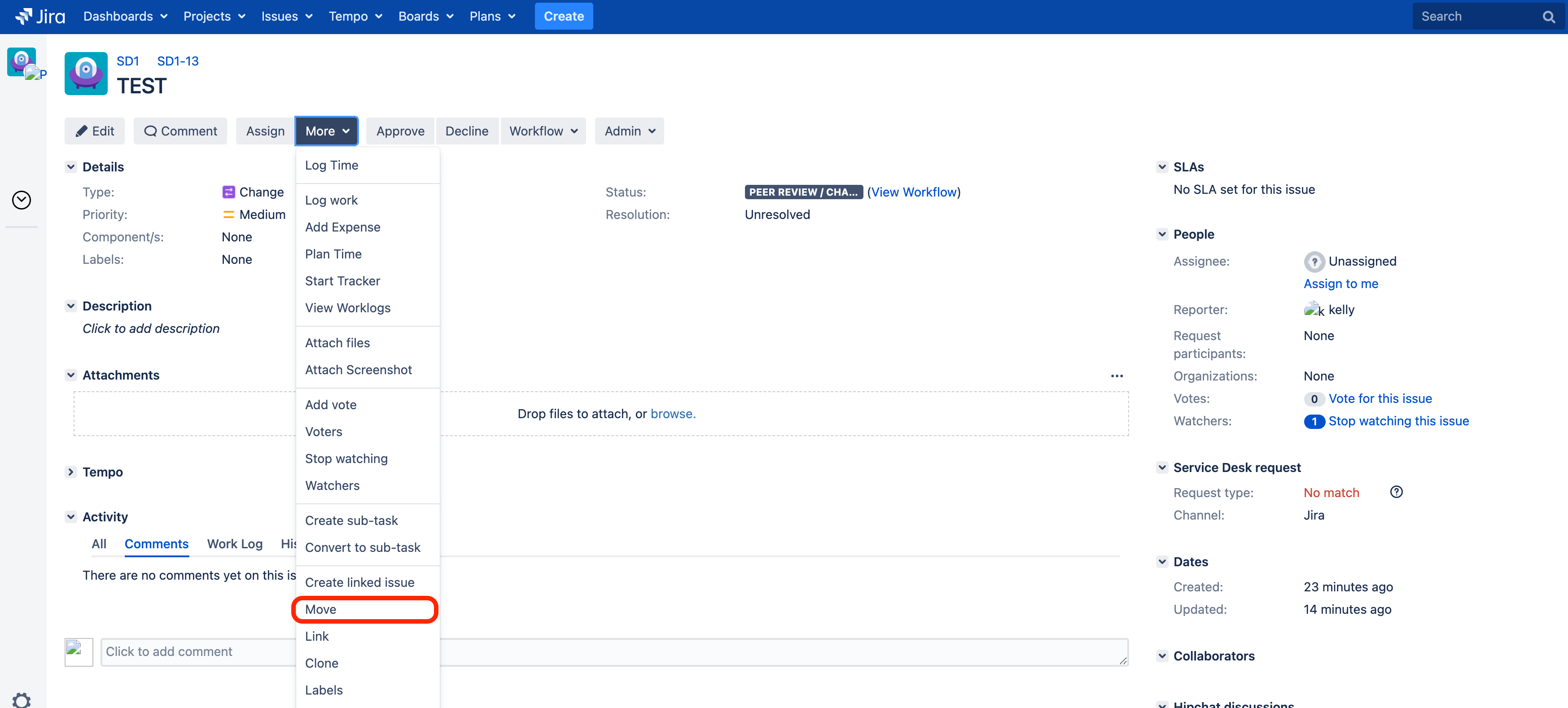

    The correct approach to update the Jira issue type is to move the issue across to different issue type via the Move option:
    Follow the step-by-step wizard to move the issue across to a different issue type associated to different workflow.

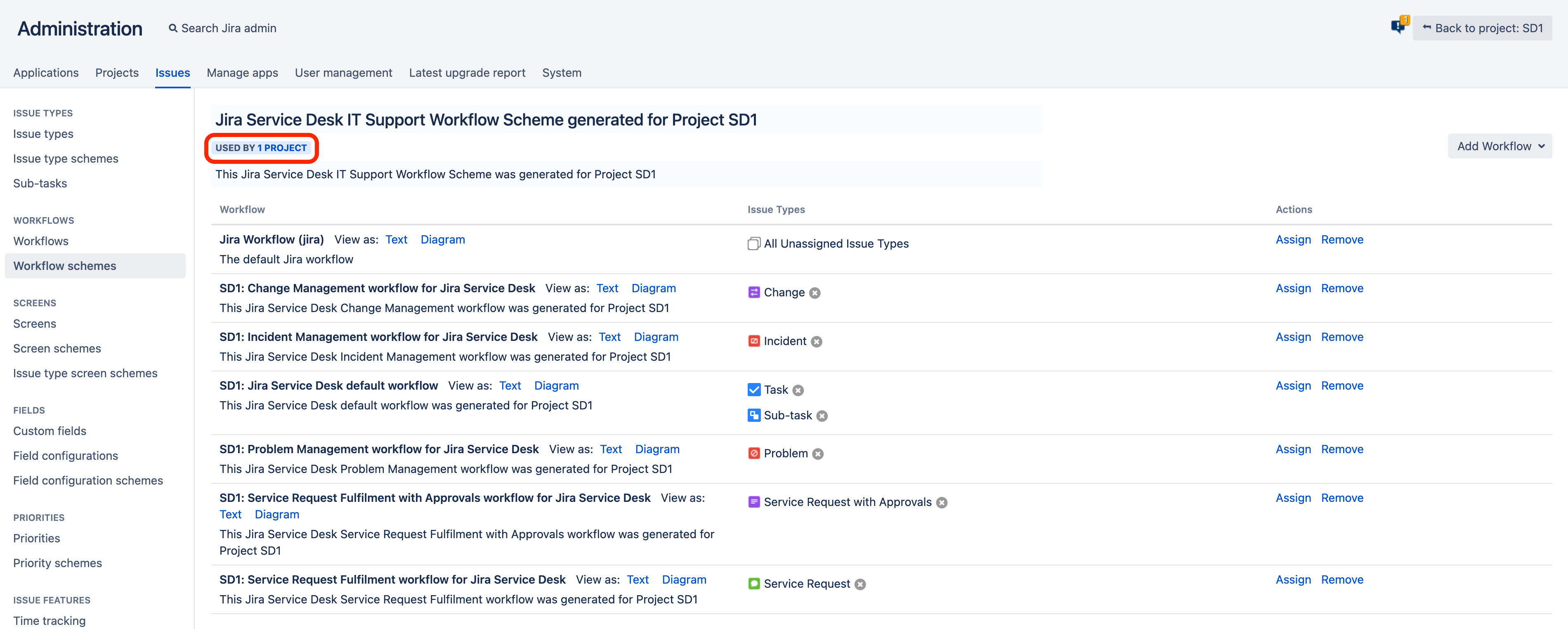

  2. Navigate to the Jira Administration » Issues » Workflow schemes and edit the workflow scheme associated to the project where the problematic issues are from.
    ℹ️ Be aware of the impact of the workflow scheme update by checking how many project is associated to this workflow scheme. If required, we can copy this workflow scheme and make this copy specific to this project to minimise the impact of the updates.

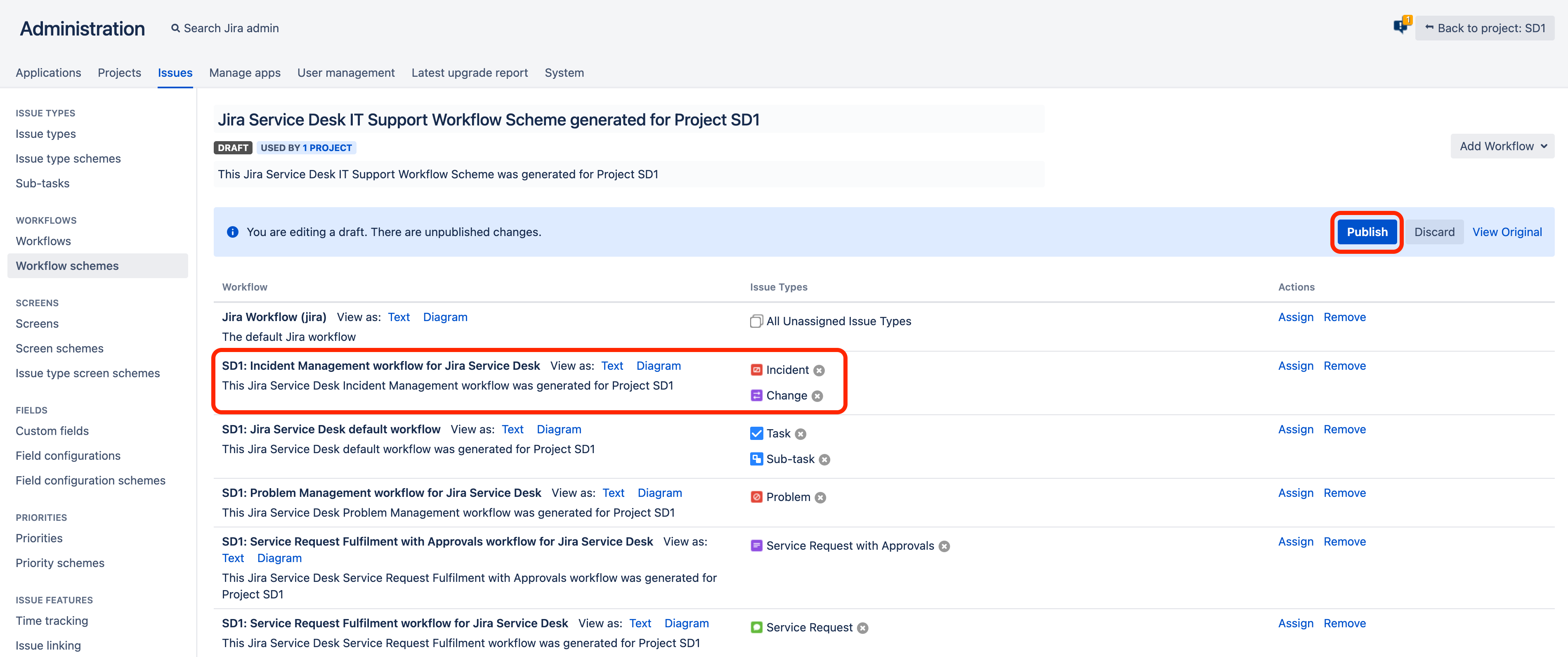

  3. Assign the new issue type with the original issue type's workflow.
    For example: The issue was originally associated to Incident issue type and now it's changed to Change issue type. So I assign Change issue type to use the same workflow as Incident issue type. As we published the change, the step-by-step wizard will guide us in mapping the workflow status from one to another accordingly.
  4. Once done, we can then Add Workflow » Add Existing or Assign the new issue type back to its intended workflow. As we published the change again, the step-by-step wizard will guide us in mapping the workflow status from one to another accordingly.

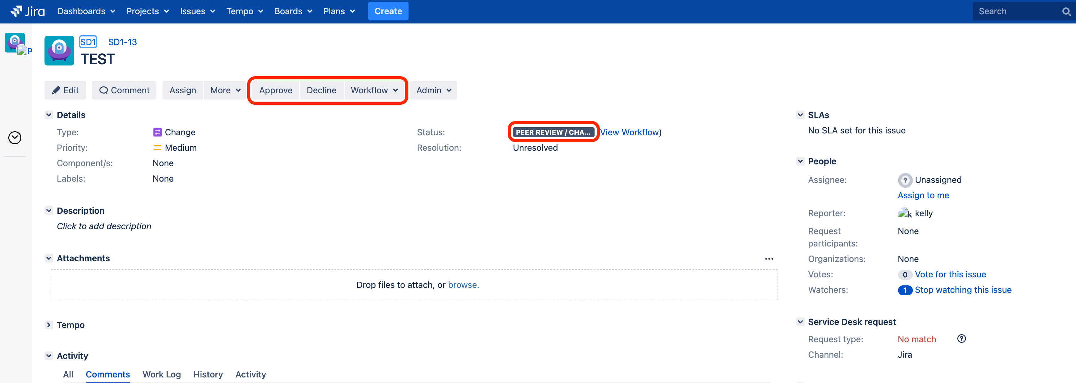

  5. Now the problematic issue should be associated to the correct workflow status and with the correct workflow transitions.
