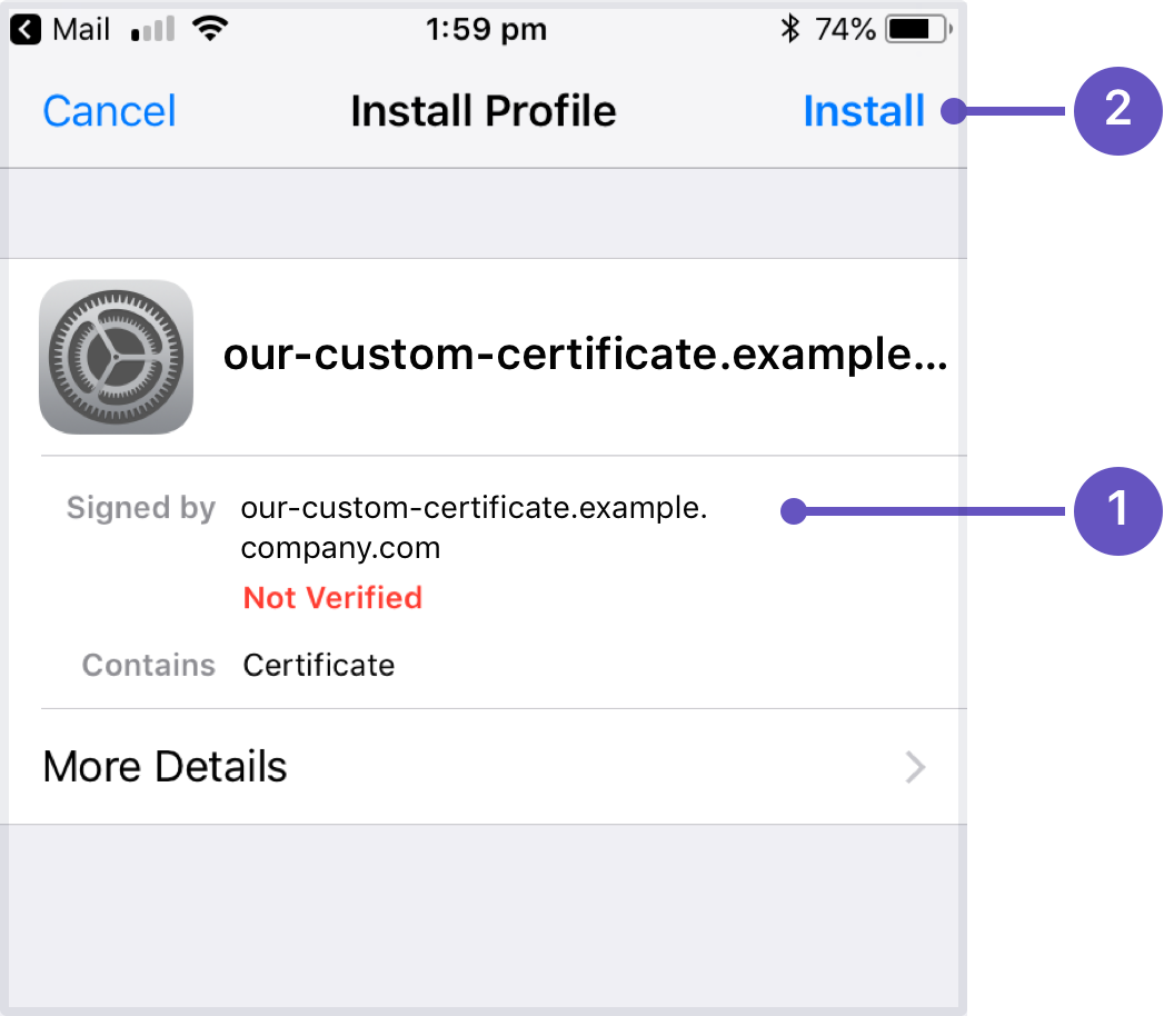

  2. The Install Profile screen will appear. Check the certificate details are correct (1) then tap Install (2).

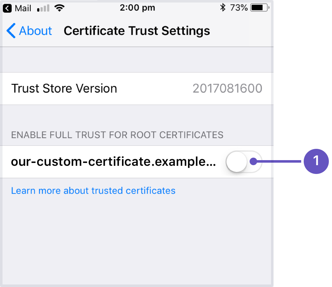

  5. On your device go to Settings > General > About > Certificate Trust Settings
  6. Your new certificate will be listed. Tap to enable it (1).

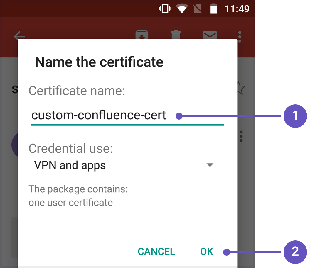

  2. When prompted, name the certificate (1). This example is for Confluence, but the steps are the same.
  3. Follow the prompts to install the certificate (2).
