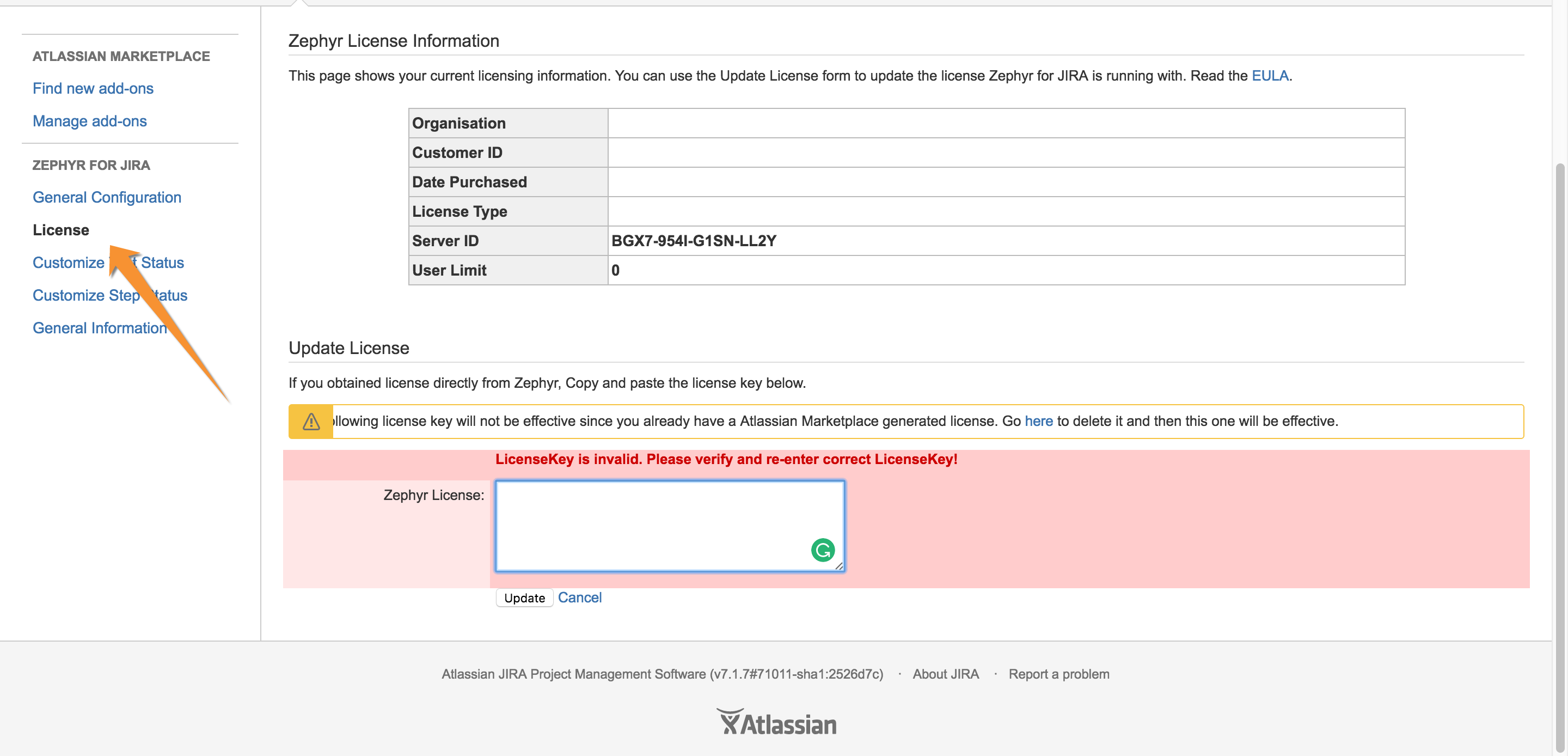

Trying to update license from Zephyr plugin License as below:
results in an error and fails to update.

Cause
The exact cause is not known, the error seems to be with the Zephyr client.
Workaround
The workaround is to update the license from manage-Add on as mentioned in the documentation How to Update Your Add-on License
Resolution
The workaround mentioned above is the solution for the moment.
