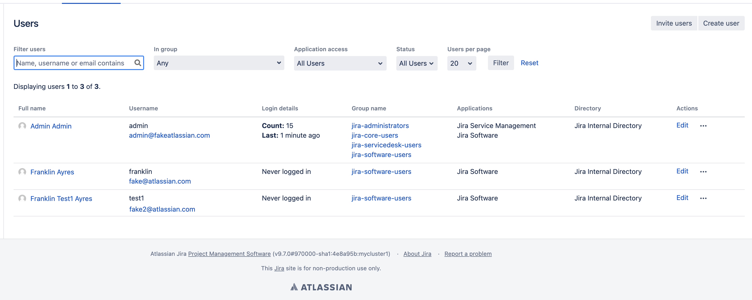

From the Jira UI, we can see 3 users with different values to the username and email address
Users Directory

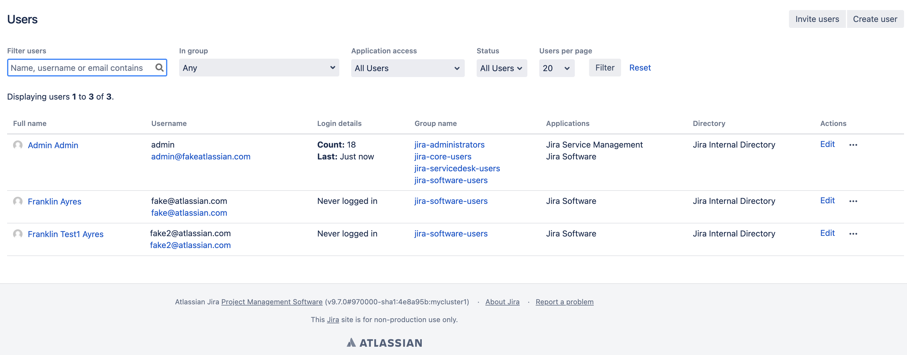

  6. As a result, the user information changed will be printed in the terminal or command prompt. In this case, 2 users were updated:
    {"self":"https://instenv-83061-pyaa.instenv.internal.atlassian.com/rest/api/2/user?username=fake@atlassian.com","key":"JIRAUSER10100","name":"fake@atlassian.com","emailAddress":"fake@atlassian.com","avatarUrls":{"48x48":"https://www.gravatar.com/avatar/b6621b81cf475d12b6791c2819bd938e?d=mm&s=48","24x24":"https://www.gravatar.com/avatar/b6621b81cf475d12b6791c2819bd938e?d=mm&s=24","16x16":"https://www.gravatar.com/avatar/b6621b81cf475d12b6791c2819bd938e?d=mm&s=16","32x32":"https://www.gravatar.com/avatar/b6621b81cf475d12b6791c2819bd938e?d=mm&s=32"},"displayName":"Franklin Ayres","active":true,"deleted":false,"timeZone":"UTC","locale":"en_US","groups":{"size":1,"items":[]},"applicationRoles":{"size":1,"items":[]},"expand":"groups,applicationRoles"} {"self":"https://instenv-83061-pyaa.instenv.internal.atlassian.com/rest/api/2/user?username=fake2@atlassian.com","key":"JIRAUSER10101","name":"fake2@atlassian.com","emailAddress":"fake2@atlassian.com","avatarUrls":{"48x48":"https://www.gravatar.com/avatar/ea5d658ea0d2e5e29830df291616e089?d=mm&s=48","24x24":"https://www.gravatar.com/avatar/ea5d658ea0d2e5e29830df291616e089?d=mm&s=24","16x16":"https://www.gravatar.com/avatar/ea5d658ea0d2e5e29830df291616e089?d=mm&s=16","32x32":"https://www.gravatar.com/avatar/ea5d658ea0d2e5e29830df291616e089?d=mm&s=32"},"displayName":"Franklin Test1 Ayres","active":true,"deleted":false,"timeZone":"UTC","locale":"en_US","groups":{"size":1,"items":[]},"applicationRoles":{"size":1,"items":[]},"expand":"groups,applicationRoles"}
    And by refreshing the Jira user management page the updated usernames will be displayed:
user directory atlassian
