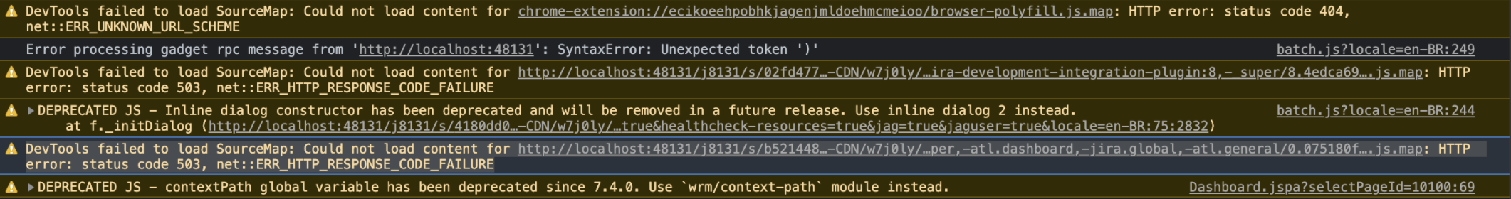

If the browser is requesting a SourceMap for Jira, and Jira assumes that it's not needed, Jira won't provide the sourcemap requested. It may come with a 404 or 503 HTTP status code:
1 2 DevTools failed to load source map: Could not load content for <<LOCATION/FILE.js.map>>: HTTP error: status code 503, net::ERR_HTTP_RESPONSE_CODE_FAILURE DevTools failed to load source map: Could not load content for <<LOCATION/FILE.js.map>>: HTTP error: status code 404, net::ERR+UNKNOWN_URL_SCHEME
