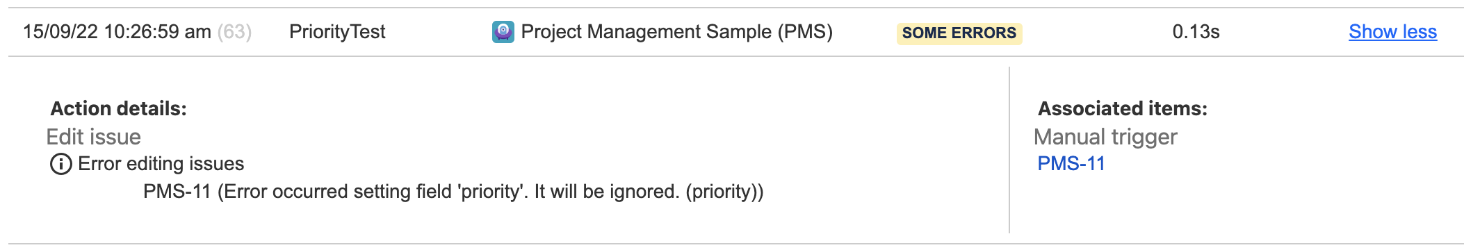

When trying to adjust the 'Priority' from an issue through an Automation for Jira rule, you may encounter the following result on the Audit logs:
ℹ️ Using the base level logging of Jira, nothing will be shown on the atlassian-jira.log.
