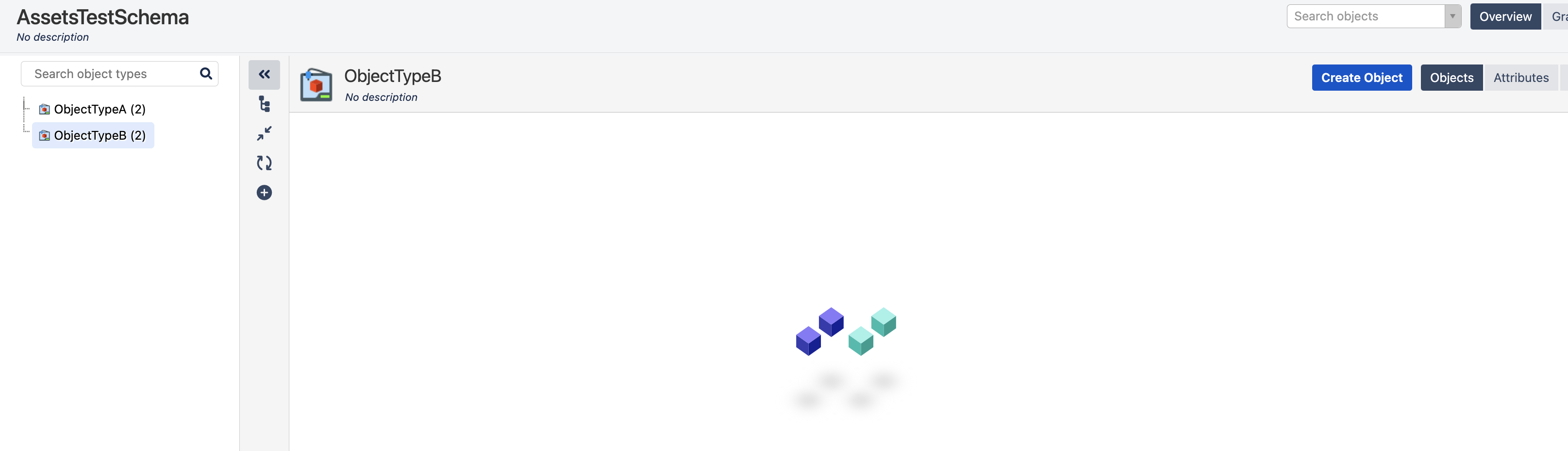

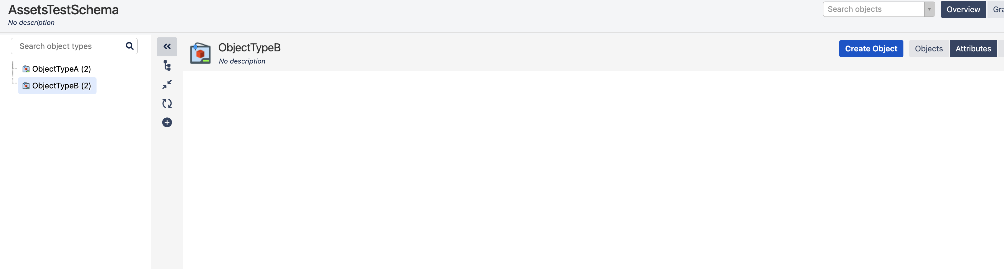

The objects and attribute details of an Object Type are not loading on the Assets schema view. The screen just continues to load forever or shows a blank screen. The issue is with only one object Type where other Object Type attributes and objects are loading fine.

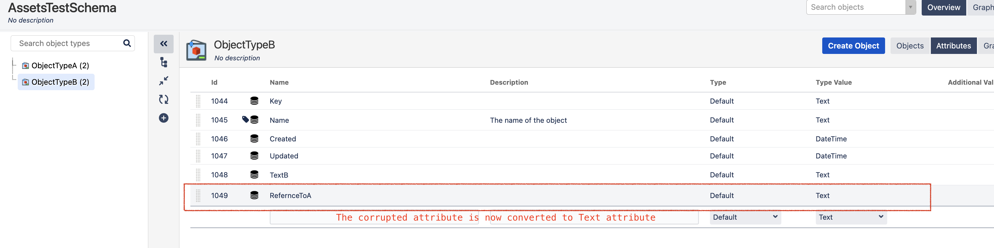

In order to convert the attribute to Text, please run the SQL as below.
Change the attribute to Text type
update "AO_8542F1_IFJ_OBJ_TYPE_ATTR" set "DEFAULT_TYPE_ID" = 0 , "TYPE" = 0 where "ID" = <XX>

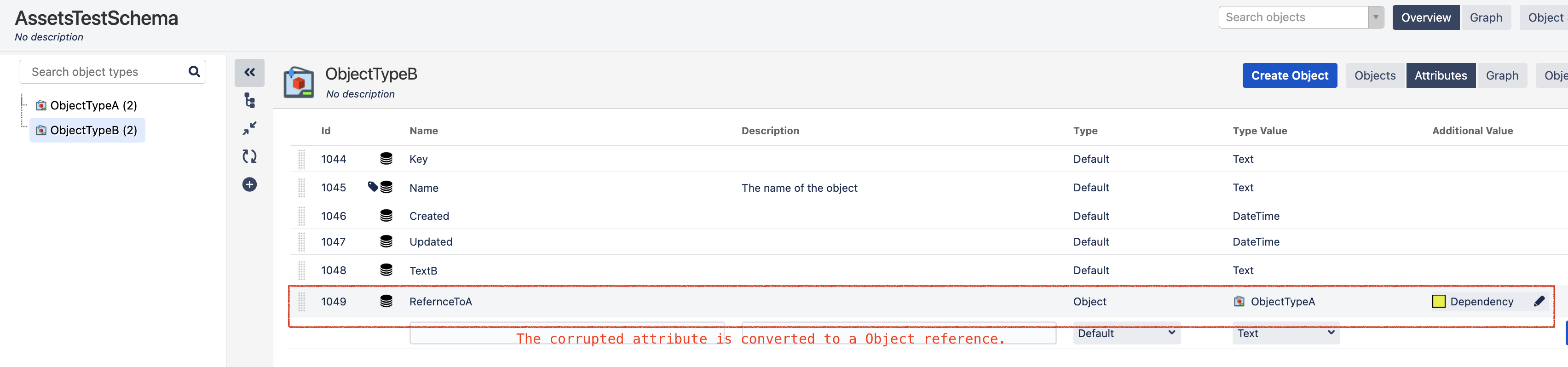

In order to convert the attribute to an object reference, please run the SQL as below.
Change the attribute to a reference. ( Type Object)
update "AO_8542F1_IFJ_OBJ_TYPE_ATTR" set "DEFAULT_TYPE_ID"= -1 ,"TYPE" = 1 , "REFERENCE_OBJECT_TYPE_ID" = <EXAMPLE> , "REFERENCE_TYPE_ID" = <LINKTYPEID> where "ID" = <XX> ;

If the corrupted attribute is converted to Text type, the attributes appear like below:
If converted to a Reference attribute, the attributes appear as below:
