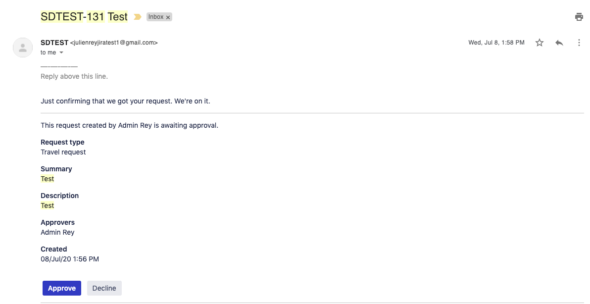

Expected behavior
A customer notification of type Approval Required should be sent to all the approvers defined in the request:
A travel request email awaiting approval. The request is titled SDTEST-131 Test and was created by Admin. The summary and description both read Test.
