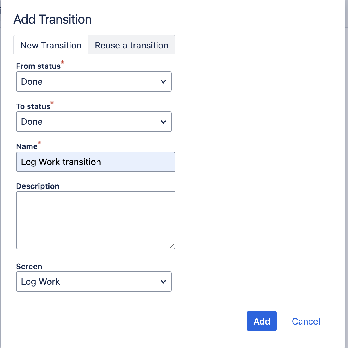

  • We will need to create a self-reflecting transition, transitions back to itself, not a different status. Lets name it as Log Work transition.

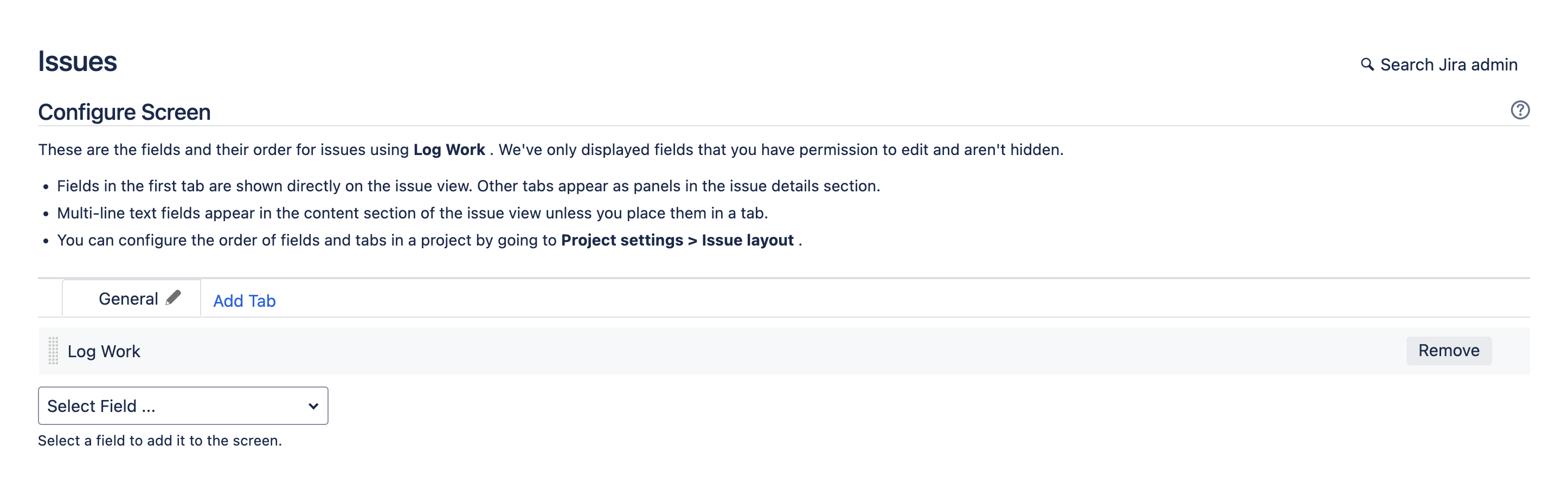

  • In this transition, we will need to add a separate screen with Log Work field and we will not put any workflow property in this transition.

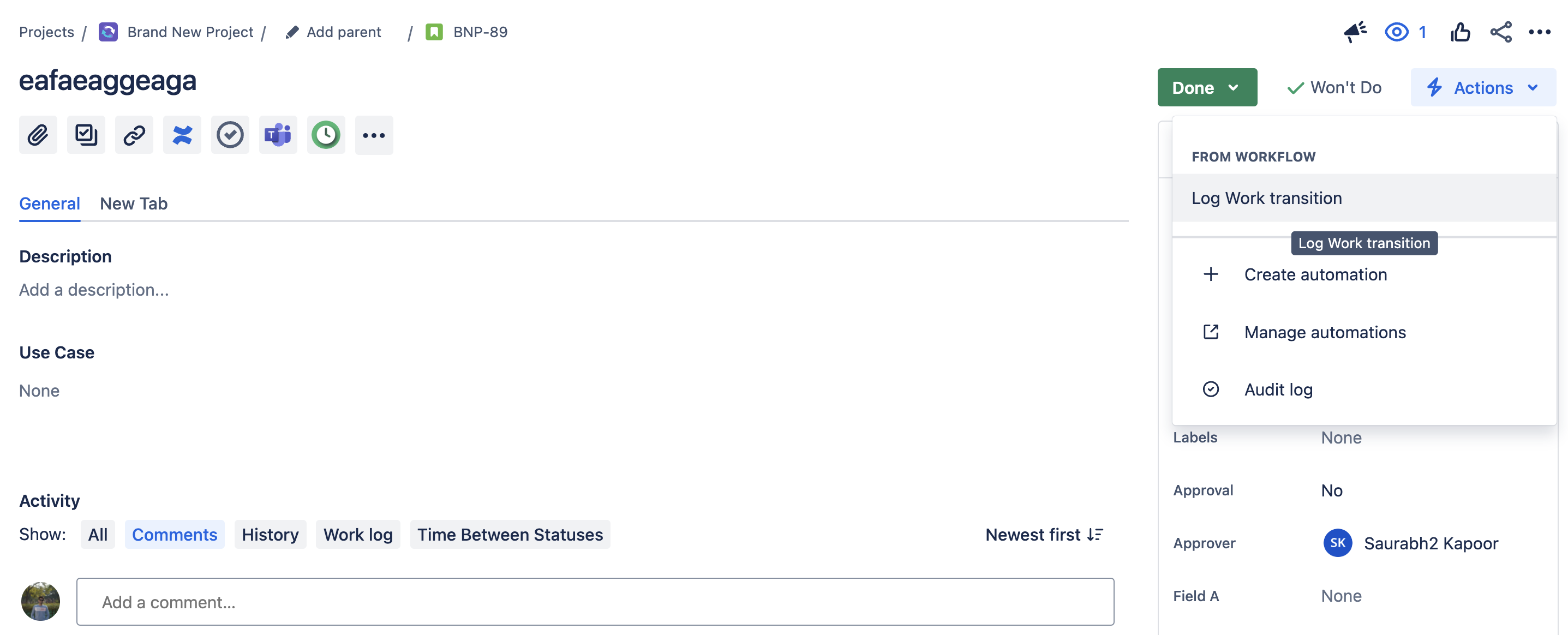

  • When the users reach the 'Done' status, they will see another transition in the issue screen named as Log Work transition under the Actions tab next to the Resolution code which will only allow logging work keeping the issue in the same status 'Done'
