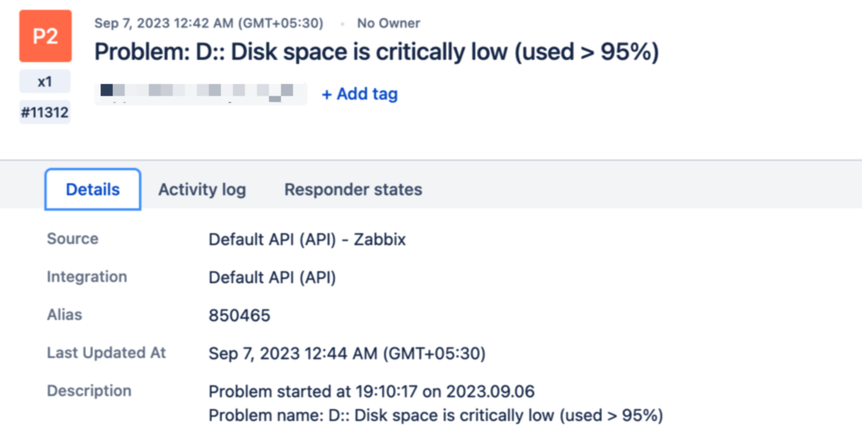

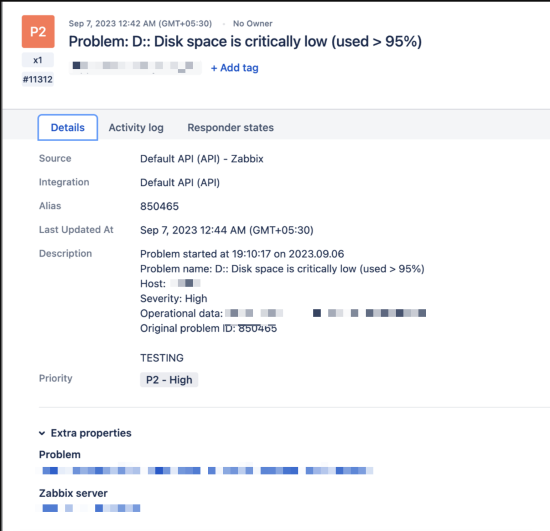

The Source field in an Alert created via Zabbix integration shows Default API instead of Zabbixintegration and also ignores the filters in the Zabbix integration.

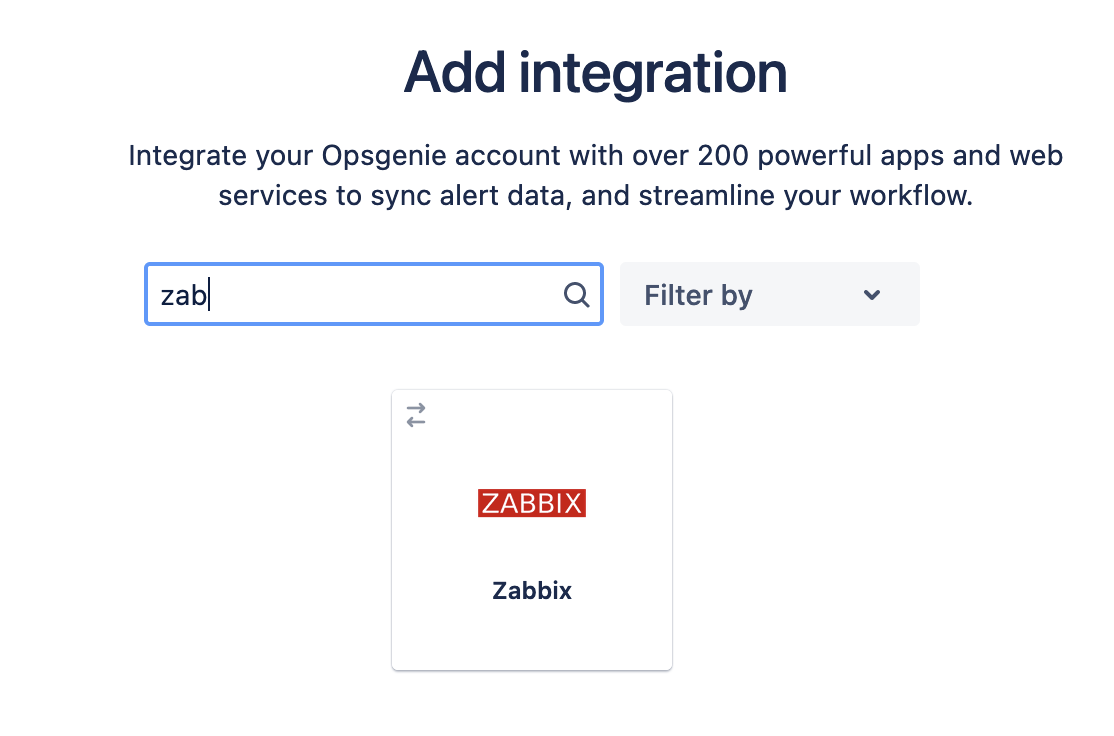

  1. An integration offered by Opsgenie
    • This isoffered by Opsgenie and it uses a separate plugin to send alerts from Zabbix to Opsgenie. This sends payloads from Zabbix to the /v1/json/zabbix endpoint with a specific format.

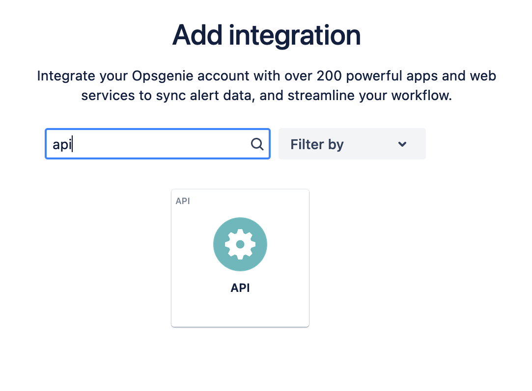

  2. An integration offered by Zabbix
    • This is owned by Zabbix and is now available natively in Zabbix. This was built using Opsgenie's public Alert API endpoint /v2/alerts.
You will see alerts using “Default API” as the source integration when you setup integration using Option#2 from the above.
The Zabbix integration in Opsgenie is intended to be used with Option#1 from the above.
