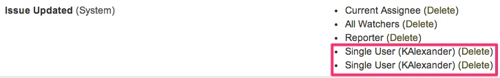

JIRA was recently upgraded and some specific users that were included with Single-User notification to the notification scheme don't receive mail notifications. The Notification helper shows they will not get notifications, although the user is listed in the notification scheme.
Upon re-adding the individual user in the notification scheme, the notifications work again, but the user shows up as a duplicate entry in the scheme.
