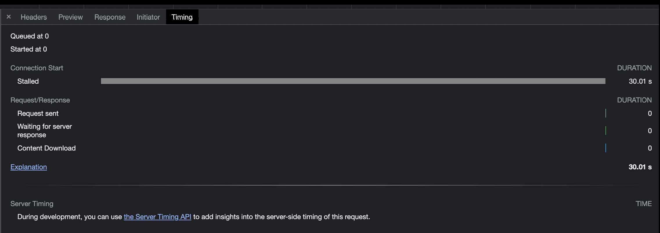

Collecting a HAR file from the browser when attempting to access the URL will reveal within the 'Timings' tab that the Connection Start is stalled:
