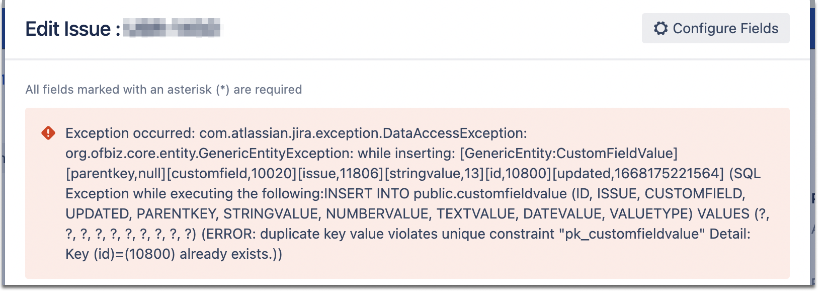

SQL exceptions when adding the sprint, to an issue on the Edit Issue screen.

While editing an issue, when a sprint is added to the Sprint field, it throws DataAccessException on the screen and update doesn't persist.
The following errors may appear in the atlassian-jira.log
2022-11-11 10:55:39,565+0000 http-nio-8080-exec-16 ERROR recovery_admin 655x1880x1 hof4jk 172.29.179.133,172.50.0.2 /secure/QuickEditIssue.jspa [c.a.j.bc.issue.DefaultIssueService] Exception occurred editing issue: com.atlassian.jira.exception.DataAccessException: org.ofbiz.core.entity.GenericEntityException: while inserting: [GenericEntity:CustomFieldValue][parentkey,null][customfield,10020][issue,11806][stringvalue,13][id,10800][updated,1668164139557] (SQL Exception while executing the following:INSERT INTO public.customfieldvalue (ID, ISSUE, CUSTOMFIELD, UPDATED, PARENTKEY, STRINGVALUE, NUMBERVALUE, TEXTVALUE, DATEVALUE, VALUETYPE) VALUES (?, ?, ?, ?, ?, ?, ?, ?, ?, ?) (ERROR: duplicate key value violates unique constraint "pk_customfieldvalue" Detail: Key (id)=(10800) already exists.)) com.atlassian.jira.exception.DataAccessException: org.ofbiz.core.entity.GenericEntityException: while inserting: [GenericEntity:CustomFieldValue][parentkey,null][customfield,10020][issue,11806][stringvalue,13][id,10800][updated,1668164139557] (SQL Exception while executing the following:INSERT INTO public.customfieldvalue (ID, ISSUE, CUSTOMFIELD, UPDATED, PARENTKEY, STRINGVALUE, NUMBERVALUE, TEXTVALUE, DATEVALUE, VALUETYPE) VALUES (?, ?, ?, ?, ?, ?, ?, ?, ?, ?) (ERROR: duplicate key value violates unique constraint "pk_customfieldvalue" Detail: Key (id)=(10800) already exists.)) at com.atlassian.jira.ofbiz.DefaultOfBizDelegator.createValue(DefaultOfBizDelegator.java:299) at com.atlassian.jira.ofbiz.WrappingOfBizDelegator.createValue(WrappingOfBizDelegator.java:172)

jira=# SELECT MAX(id) FROM customfieldvalue; max ------- 13500 (1 row) jira=# SELECT * FROM sequence_value_item WHERE seq_name = 'CustomFieldValue'; seq_name | seq_id ------------------+-------- CustomFieldValue | 13200 (1 row)
As evident from the customfieldvalue table, the MAX(id)is 13500 for this case, whereas the seq_id for seq_name of CustomFieldValue is smaller than that.
Cause
This has been observed in Instances migrated from Jira Cloud to Jira Server:
  • If the value of MAX(id) in the customfieldvalue table is higher than the seq_id of CustomFieldValue from sequence_value_item table, it causes this problem.
