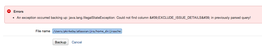

There are some functions of JIRA requiring database operations which may fail and present the above message. Below you will find an example of the problem affecting the XML Backup/Restore process.
The following can be seen in the browser:
The issue can also manifest itself when setting up JIRA from scratch, it will basically fail to add an Administrator user to the database logging the same exceptions as quoted below.
