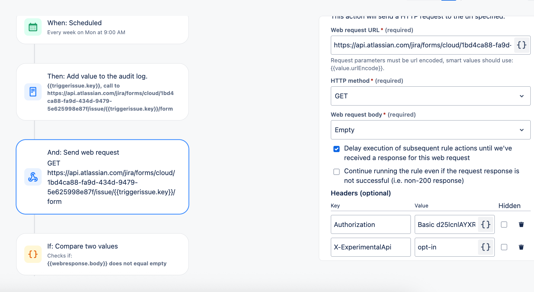

Second step - Getting a list of forms on the work item
Now, we must list all the forms we have on a given work item. For that, we can use the following API call along with a 'Send Web Request' action:
GET https://api.atlassian.com/jira/forms/cloud/{cloudId}/issue/{WorkItemIdOrKey}/form
Needed Headers:
Authorization: Basic <token> X-ExperimentalApi: opt-in
Enable "Delay execution of subsequent rule actions until we've received a response for this web request" so the returned values are available to later actions.
Screenshot of a Jira automation rule configuration, showing a scheduled trigger, adding a value to the audit log, sending a web request to the Jira Forms API, and comparing the response body.

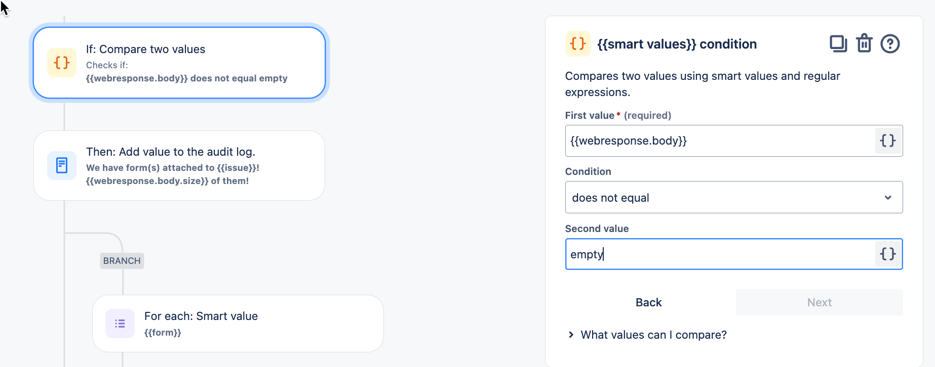

As you can see, we have three forms attached here. There is a simple check you can add to make sure the rule will only proceed if the work item has at least one form attached to it:
A screenshot of a rule configuration in a workflow automation tool. The rule compares two values: {{webresponse.body}} and empty. If the web response body is not empty, a value is added to the audit log.

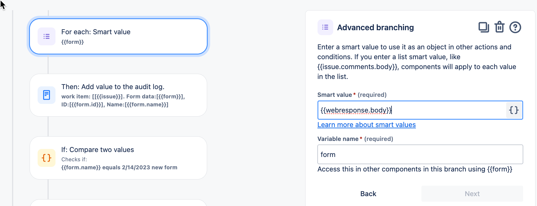

Now, we will add a branch action to loop through each of the forms (If you are sure that your work item will have only one form, this is not needed):
Screenshot of advanced branching configuration in a workflow automation tool.  The branch uses {{webresponse.body}} as the smart value and assigns it to the variable form.

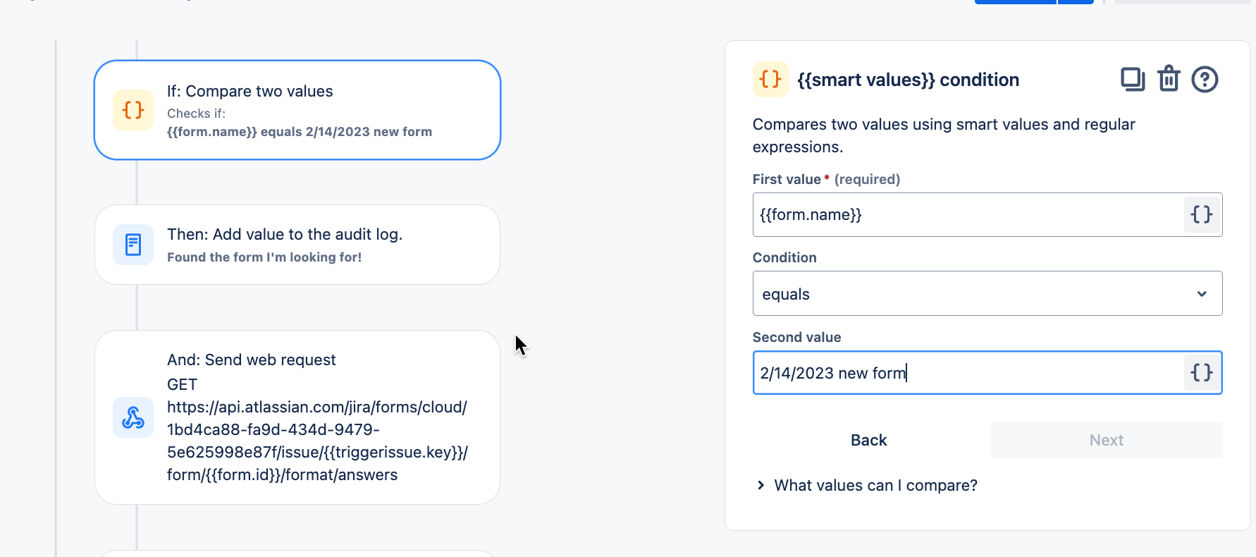

In this example, we're looking for a specific form named '2/14/2023 new form', so we will add a simple smart values condition to proceed only with the form we need:
Screenshot of a rule configuration comparing two values. The rule checks if {{form.name}} equals 2/14/2023 new form. If true, it adds a value to the audit log and sends a web request.

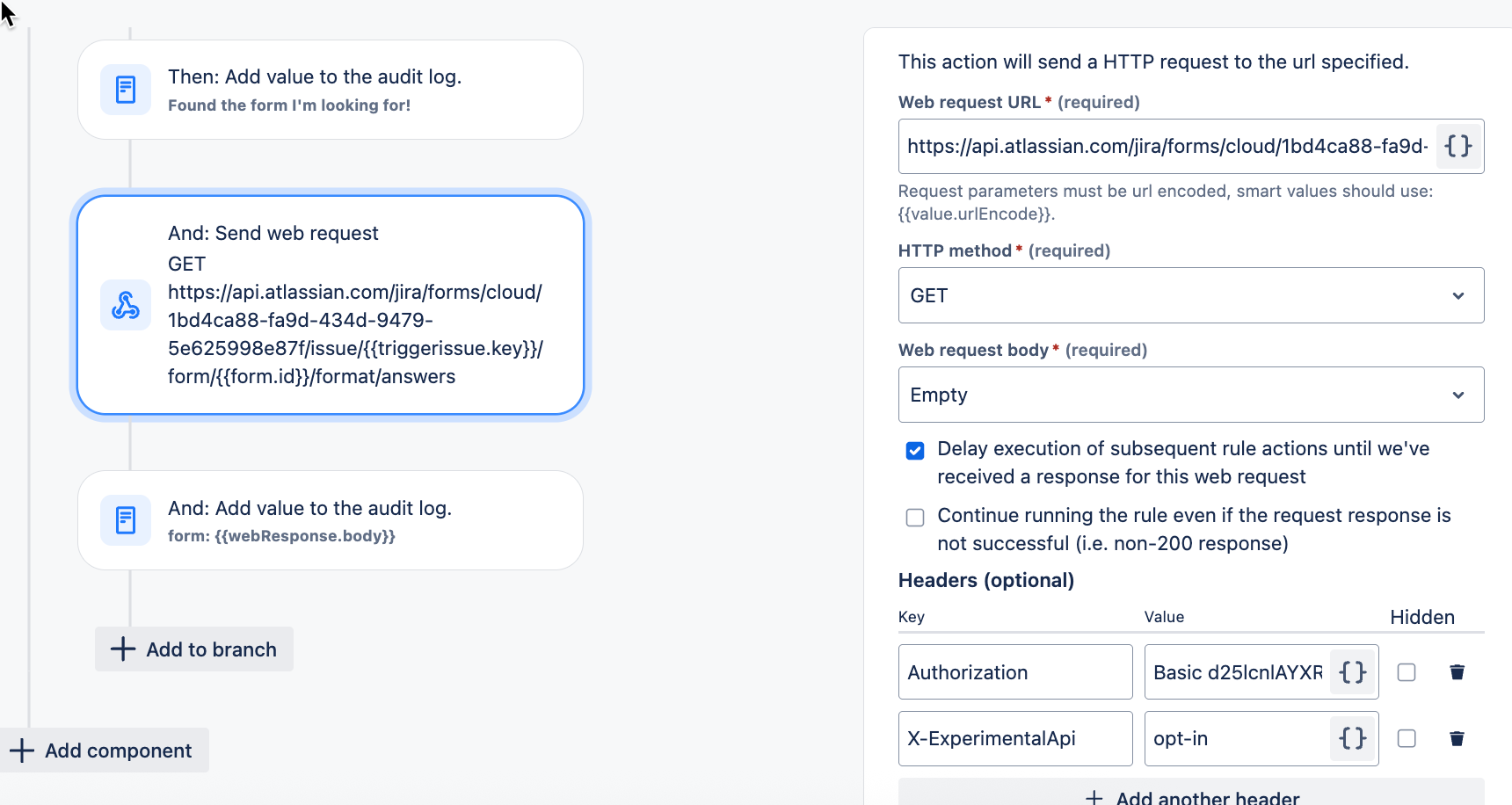

Last step: Getting the form values
There is a simplified call that we can now make to get the form answers directly: Get form answers API
Screenshot of a "Send web request" action configuration. The action sends a GET request to a Jira Forms API endpoint. The configuration includes authorization and experimental API headers, and delays subsequent actions until a response is received.
