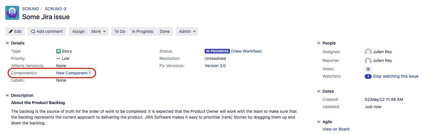

  • In the screenshot below, we can see that the user julien3 is does not seem involved in the issue SCRUM2-3 as first glance (the user is not a reporter/assignee/watcher), although there is a component set in the issue:

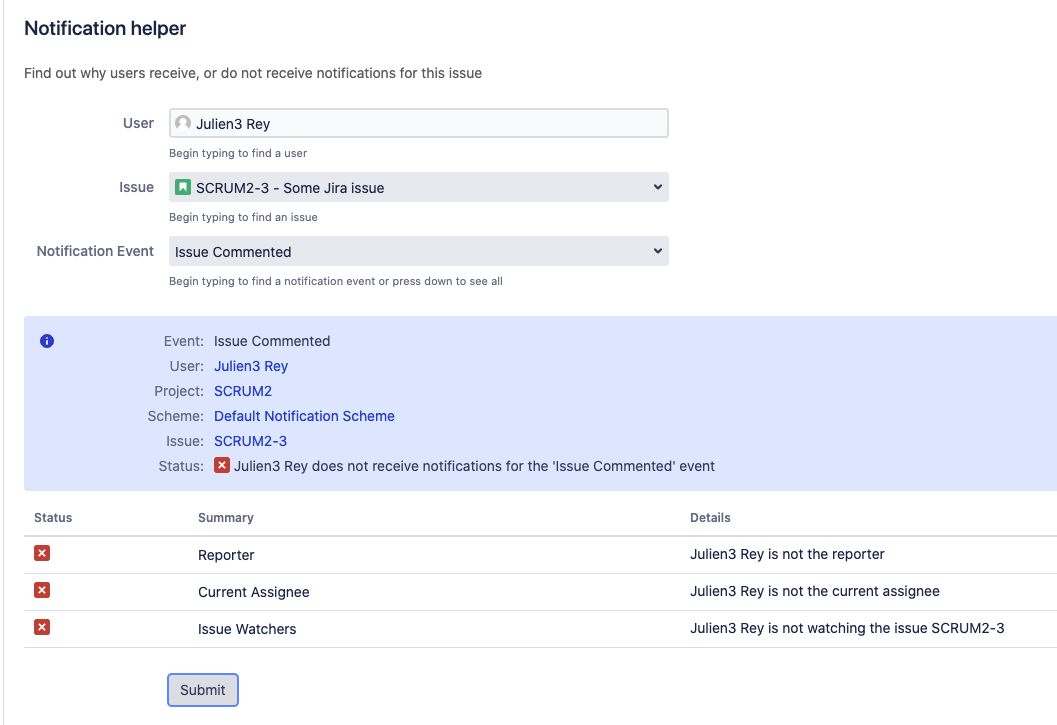

  • The Notification Helper shows that this user should not receive notifications from the Issue Commented event:

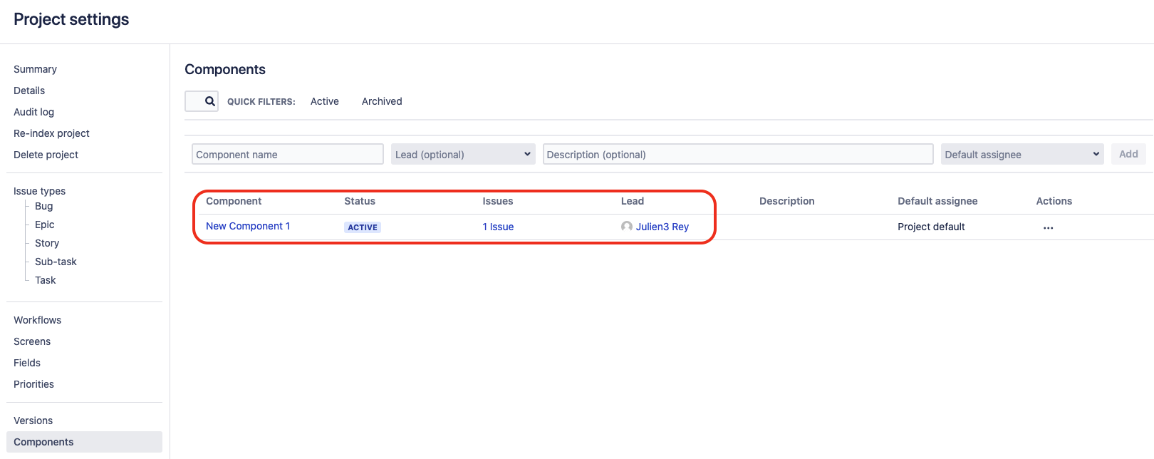

  • Checking the Components configuration in the Project the issue belongs to, we can see that julien3 is the component lead:

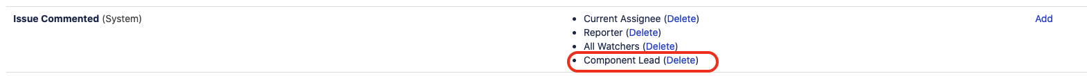

  • Checking the Notification Scheme configuration in the Project the issue belongs to, we can see that the component lead is a recipient of the Issue Commented event, which explains why julien3 should receive notifications whenever a comment is added to the issue SCRUM2-3:
