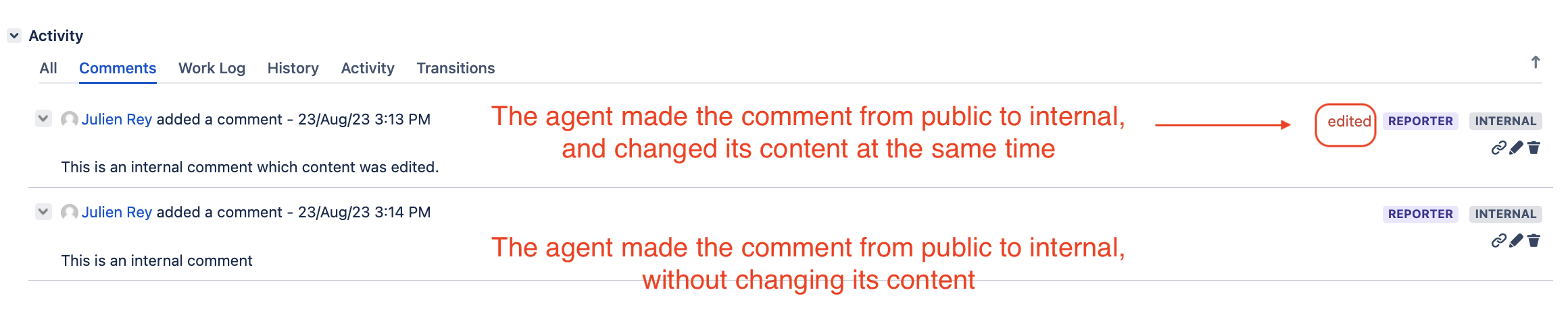

Even though the comment is showing as internal in a JSM ticket, it is possible that the agent who added this comment added it first as a public comment by using the button Share with customer, then realize the mistake and edited the comment to make it internal.
In such case, the customer will receive a JSM customer notification of type Public Comment Added, since the comment was public at first.
How to identify this scenario
It is very difficult to verify if the notification was sent for this specific reason, since there will be no indication in the JSM ticket (or the Jira logs) that the comment was first added as "public" before being made "internal":
  • if the agent made the comment public at first and then internal without changing the content of the comment, there will not be any edited flag next to the comment
  • however, if the agent made the comment public at first and then internal while changing the content of the comment, then there will an edited flag next to the comment
In the case the agent made the comment internal after making it public without changing the content of the comment, there will not be any edited flag next to the comment, so it is not possible to tell from the UI if the agent made a change to the comment or not (whether the visibility was changed or the content). For this specific case, the only way to tell if an agent made some change to a comment (by changing its visibility or by changing its content) is to check the Tomcat Access logs.
