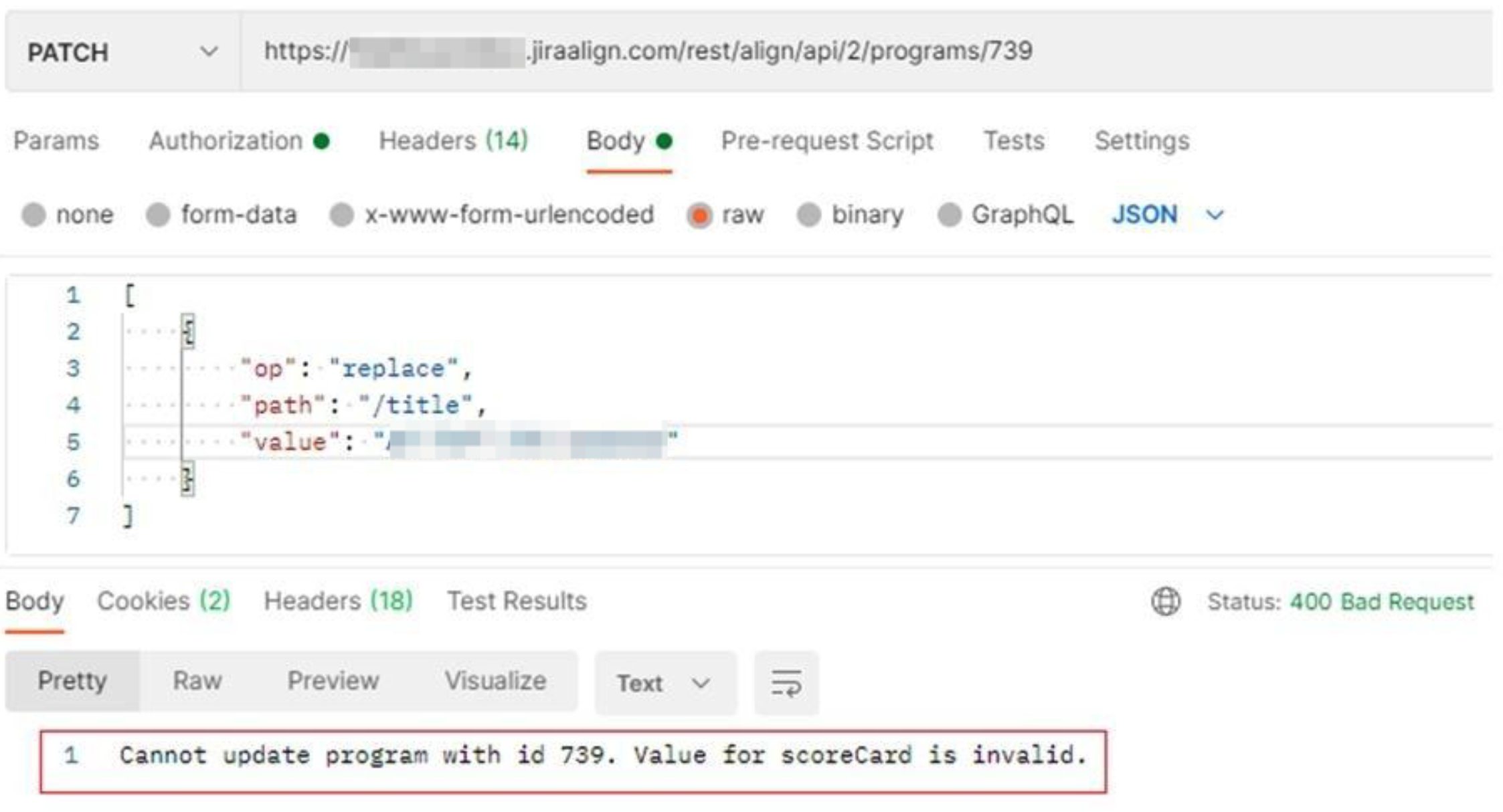

When updating the Program Name via a PATCH API call, the error “Cannot update program with id ###. Value for scoreCard is invalid” is returned.
As can be seen on the screenshot (using the Postman API client) below:

Checking the Audit LOG for the affected Program, we can see an entry like the one below, that points to when it was created and the ScoreCard it used:
Score Card: Use {12_S} Score Card
Where “{12_S} Score Card” is the Portfolio Score Card.
Checking the Scorecard Configuration, there is no “{12_S} Score Card” (neither Portfolio Score Card) in the Edit Scorecard dropdown menu.
Checking back the Audit LOG, there is another entry showing the Score Card changed from "NULL" to "Default Scorecard"
Score Card Changed - From [ ] To [ Default ScoreCard ]
It's an "automatic internal" change as, at this moment, the “{12_S} Score Card” doesn't exist anymore.
Despite this apparent change in the Audit LOG, internally the Score Card value keeps "NULL".
