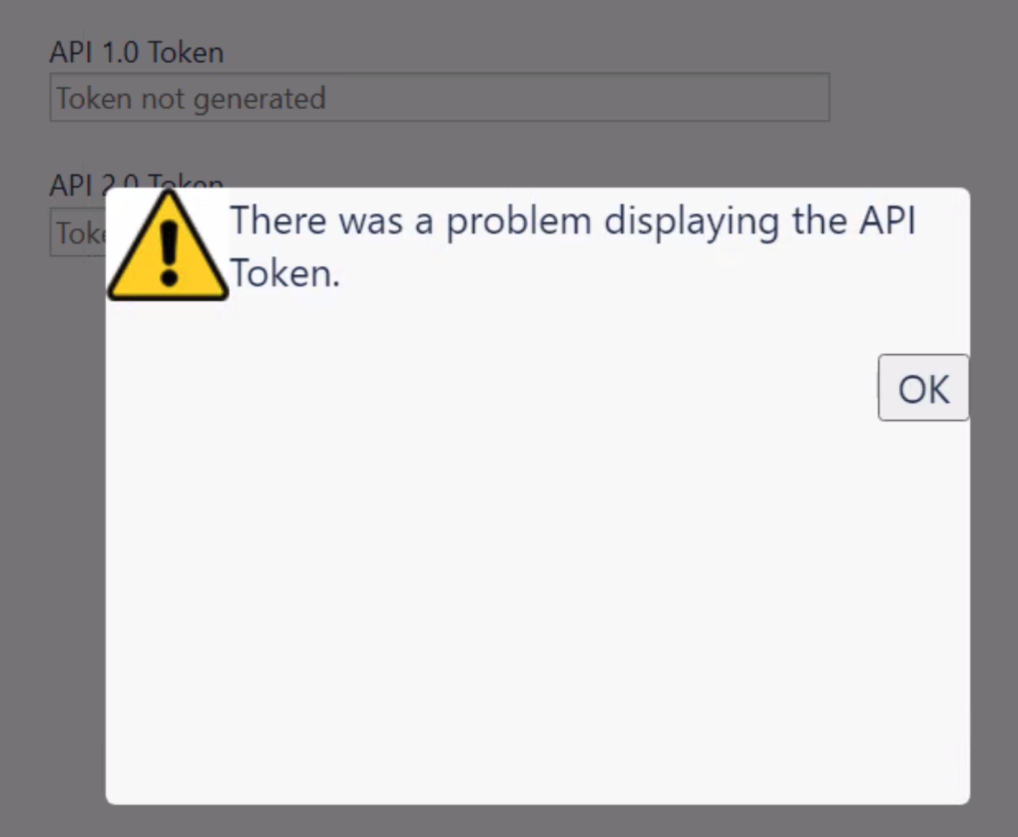

When working in an On-Premise Jira Align instance, clicking Generate API Token (in the User Profile), errors with the following message:
“There was a problem displaying the API Token”
Additionally, clicking the OK button in the message pop-up does not show the details of any newly created tokens, resulting in users being unable to make REST API calls

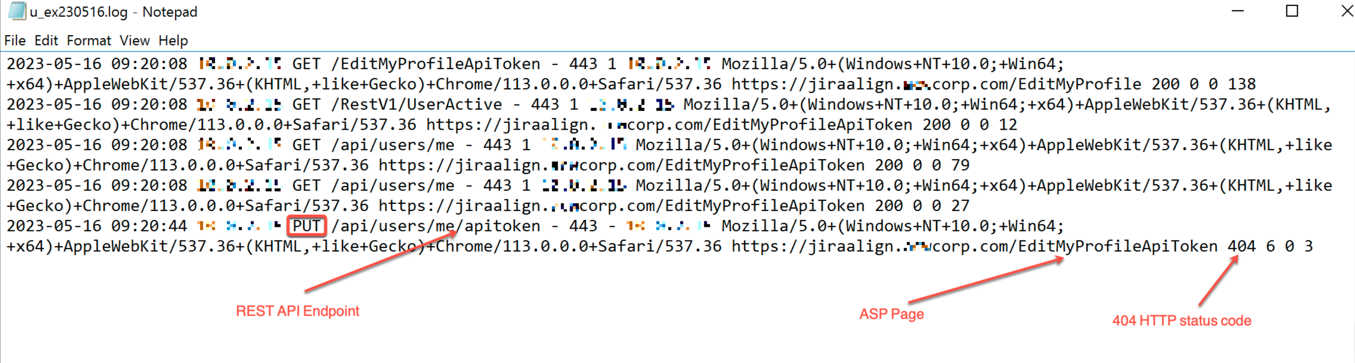

  • The Internet Information Services (IIS) u_ex*.log files did capture a 404 HTTP status code, against PUT requests to the /api/users/me/apitoken endpoint made by EditMyProfileApiToken.asp. The following text and image is an example of the specific log entry:
2023-05-16 09:20:44 xxx.xxx.xxx.xxx PUT /api/users/me/apitoken - 443 - xxx.xxx.xxx.xxx Mozilla/5.0+(Windows+NT+10.0;+Win64;+x64)+AppleWebKit/537.36+(KHTML,+like+Gecko)+Chrome/113.0.0.0+Safari/537.36 https://jiraalign.XXXcorp.com/EditMyProfileApiToken 404 6 0 3
  • HTTP 404 status codes are in indication that communication with the server was successful but that the requested item could not be found (or could not be accessed) - the substatus code of 6 that follows the 404 code is also important (see cause section below)
  • Further troubleshooting using Postman identified that GET requests were successful, however all PUT requests made into the Jira Align instance failed with a 404 error

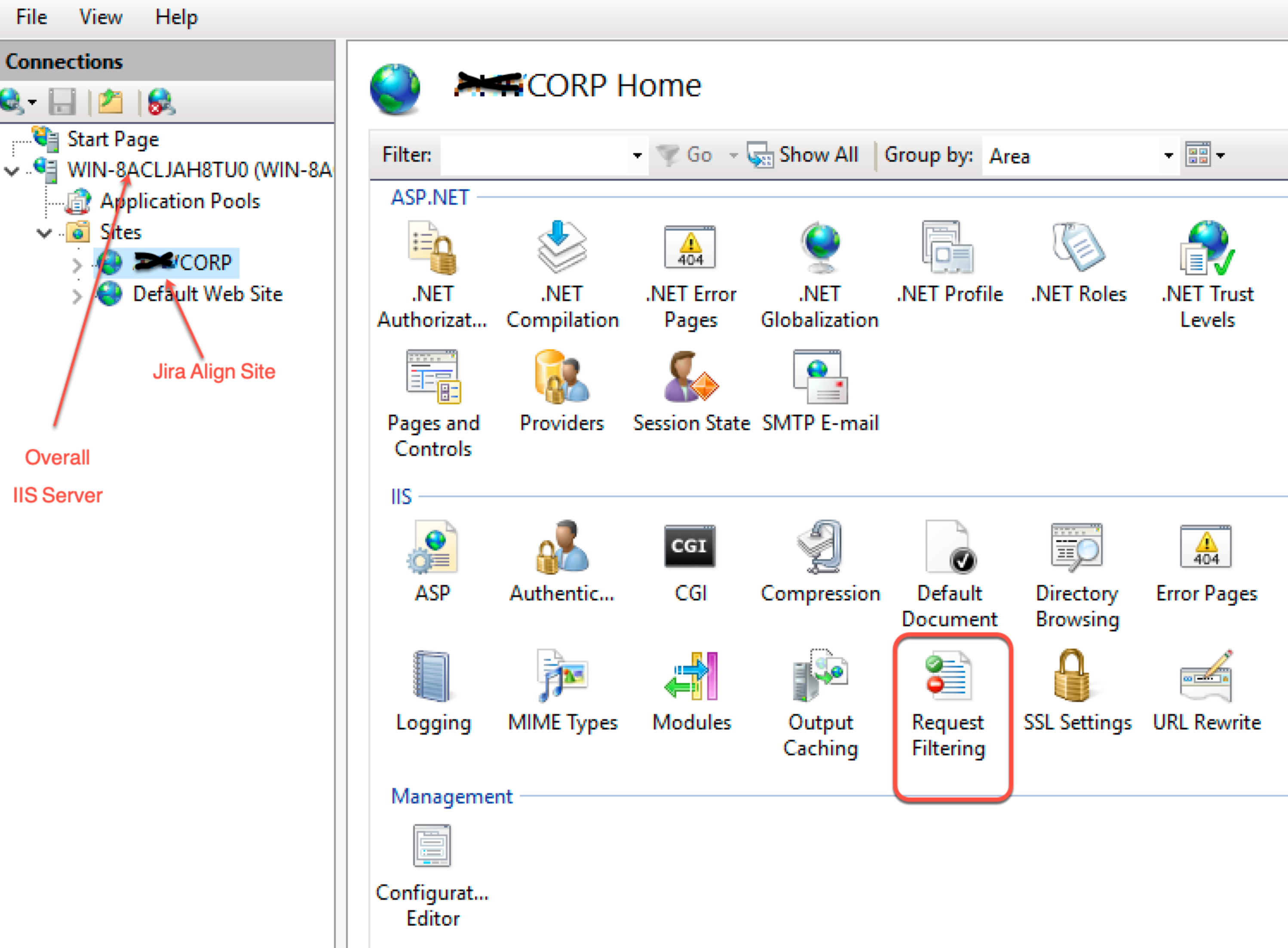

  4. Open the IIS Manager console
  5. Click on the Jira Align Site and then open Request Filtering (found in the IIS section)

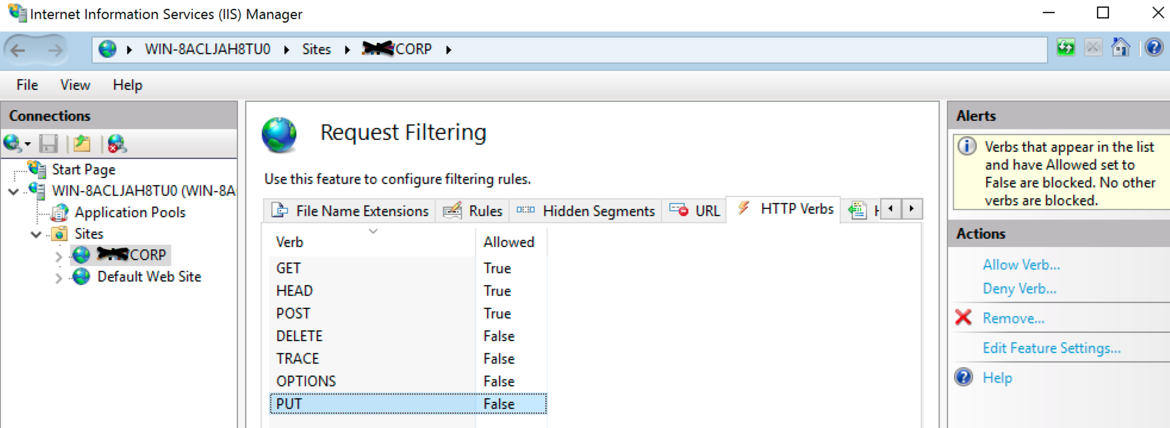

  6. Click on the HTTP Verbs tab
  7. Remove all filters for verbs (whether Allowed = True or False) so that the screen looks like the below image

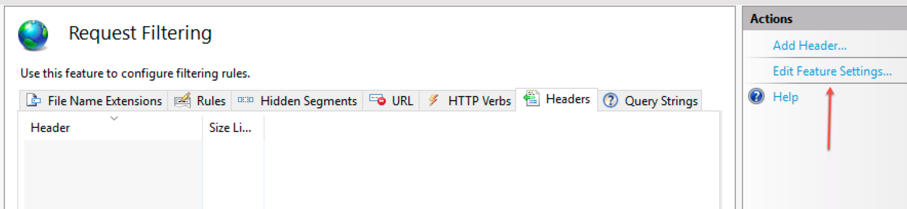

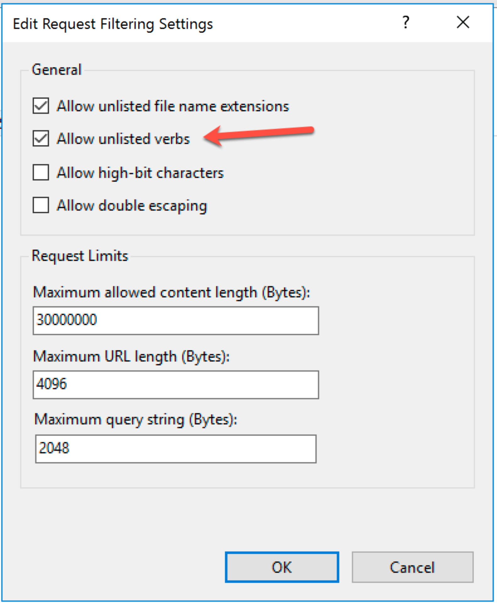

  8. In the right side Actions Menu on the same screen, click on Edit Feature Settings… and make sure that Allow unlisted verbs is checked/enabled (correct this and click OK if it is not)
  9. Repeat from Step 5 but select the Overall IIS server instead of the Jira Align Site
  10. Restart the IIS Server (select the Overall IIS server again and use the Restart option near the top of the right side bar)
