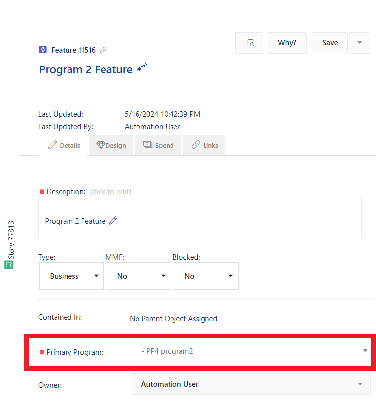

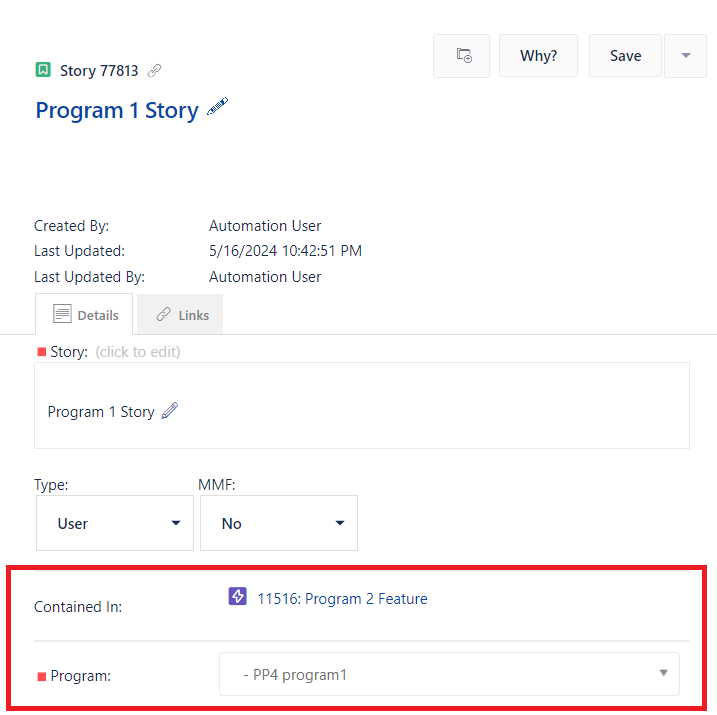

a. The Story belongs in Program 1 and is contained in Program 2 Feature
b. The parent Feature belongs to Program 2 and does not have additional programs

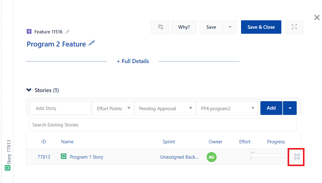

a. Was the association of parent Feature to child Story a mistake? If so, have them unlink the Story from the parent Feature. They can now update the Story via API.

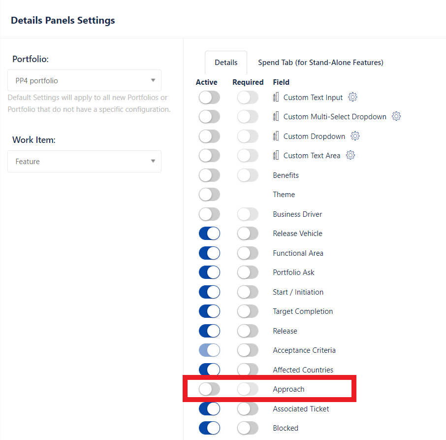

i. To prevent their data from entering this state again, verify that the Approach toggle is Off for their Portfolio:

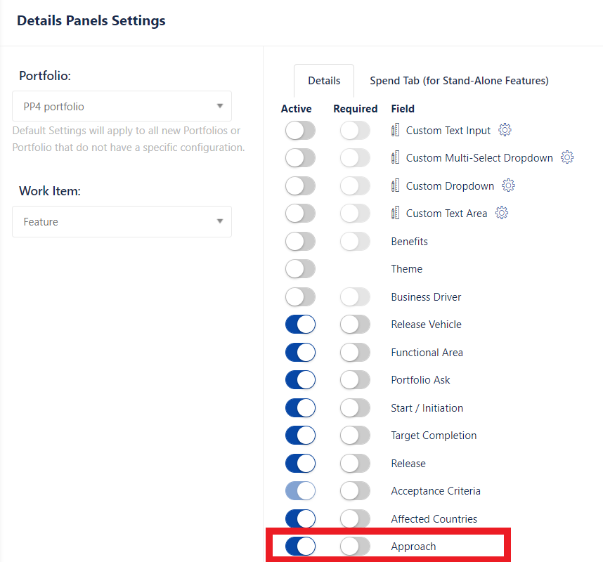

b. Does the customer want to use a multi-program approach? Note that Advisory Services recommends against this as multi-program approaches cause problems for reports and data rollups.
i. If the customer wants multi-program in spite of the risks, they can enable it in Settings > Details Panels Settings: Approach

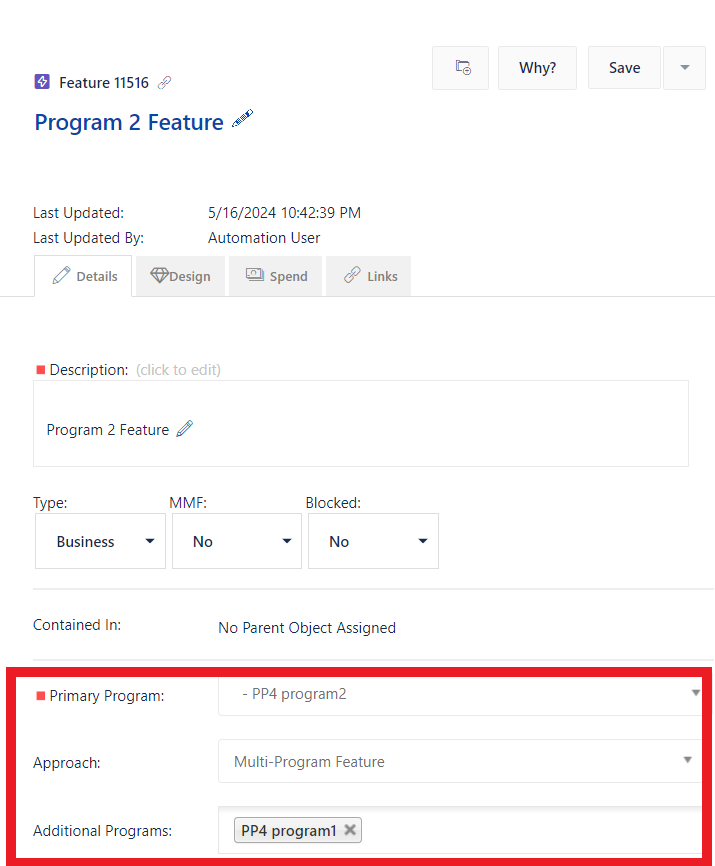

ii. They can then set a Multi-program Feature on the parent Feature and add the child Story’s Program as an Additional Program:
iii. Going forward, with Approach enabled, the connector will add the Story’s Program as an Additional Program to the parent Feature.
