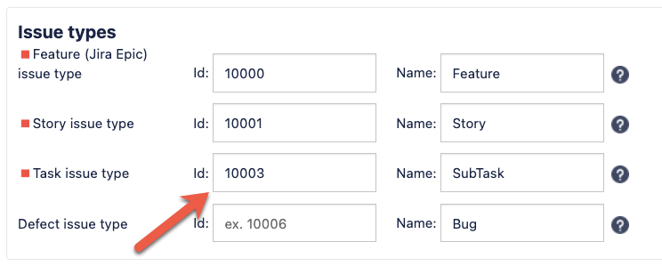

  3. What has been set in Settings / Administration > Jira Settings > Jira Setup > Task issue type? Does the numeric ID refer to Jira Tasks or Jira Sub-Tasks
  4. What has been set in Settings / Administration > Jira Settings >Custom Issue Types? Are there entries for either Jira Tasks or Jira Sub-Tasks configured
Either Jira Software Tasks or Sub-Tasks can be mapped from Jira Software to become Jira Align Tasks. Usually, the connector is configured to map Jira Software Sub-Tasks to the Jira Align Tasks but optionally it is possible to map BOTH Jira Tasks and Jira Sub-Tasks into Jira Align, with Jira Software Tasks becoming Jira Align “Stories of Type Task”. Knowing what the desired behaviour is and checking the diagnosis points mentioned above can assist with identifying the solution.

  • The numeric ID of the Task issue type may be set incorrectly (point 3 in the diagnosis notes above)
  • If synching both task types from Jira then the numeric ID configured in the entry in the Custom Issue Types tab may be set incorrectly (point 4 in the diagnosis notes above)
  • The same numeric ID has been configured for both the Task issue type and the entry that maps the Custom Issue Type

  2. Configure Settings / Administration > Jira Settings > Jira Setup > Task issue type so that the numeric ID for "Task issue type" is set correctly (while it is only a on screen text reference, also set the Name appropriately)
  3. If the requirement is to sync both Jira Tasks and Subtasks then the above setting should be configured for Jira Sub-Tasks and then use the Custom Issue Type tab to set the mapping for Jira Tasks to Jira Align Stories of Type Task. Checking that the numeric Jira ID for Tasks is correct. This is configured under Settings/Administration > Jira Settings > Custom Issue Types
  4. Make sure that the same numeric ID for either the tasks or sub-tasks has not been configured as both a Task issue type and a Custom Issue Types entry
