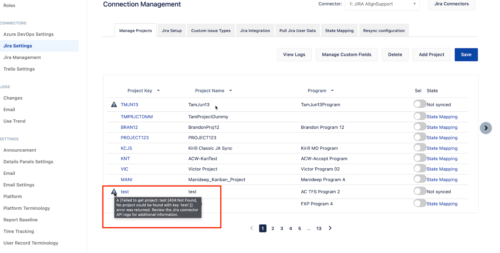

While trying to add a new Jira Project in the Jira Align Jira Settings > Manage Projects page, we see an alert on the same row. When we mouse over the error alert, we see an error message" Failed to get Project(xxxx): 404 not found"

  3. In Jira Align, go to Admin > Jira Settings > Add project
  4. Provide the Jira Project key, Jira Project name, and Jira Align program name. Click on Save

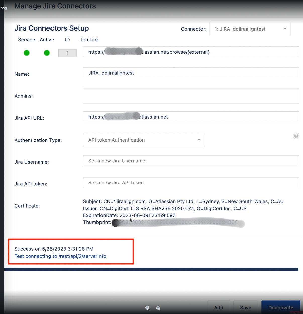

  • Check Jira Connector settings on Jira Align. On Admin > Jira Settings > click on Jira Connectors
    • Verify correct Jira Link added and that the REST API test connection is successful.

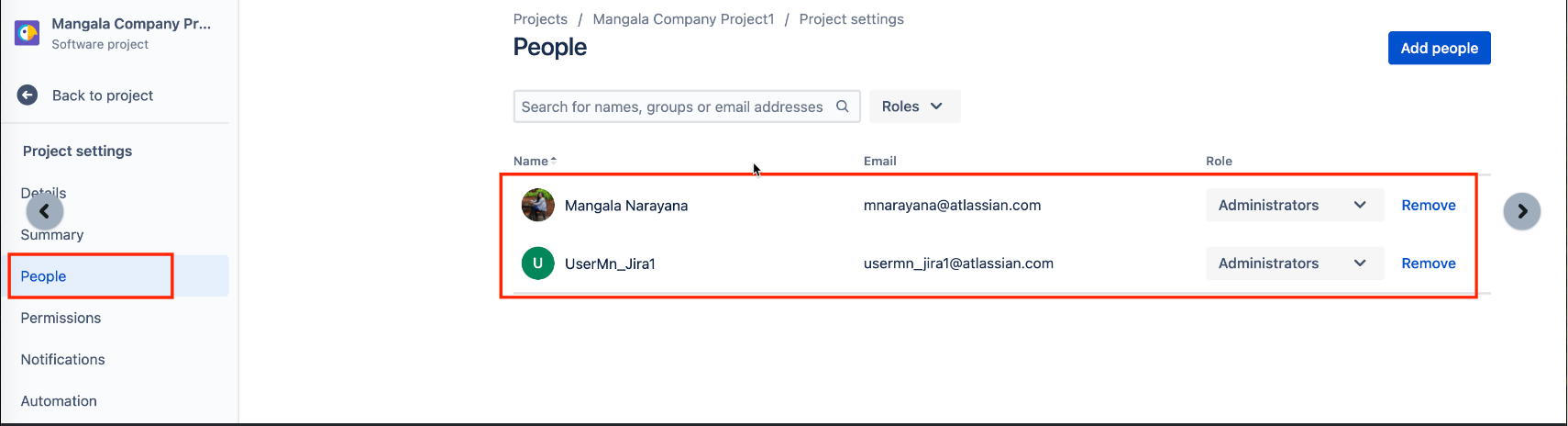

  1. Identify the user mapped in Jira Align Connector and have permission to the Jira project.
    1. If unsure of the username mapped in Jira Align Connector, go to https://xxxxx.atlassian.net/jira/projects and select the project you are trying to configure.
    2. Go to Project Settings > People and note down the user.
    3. (Auto-migrated image: description temporarily unavailable)
