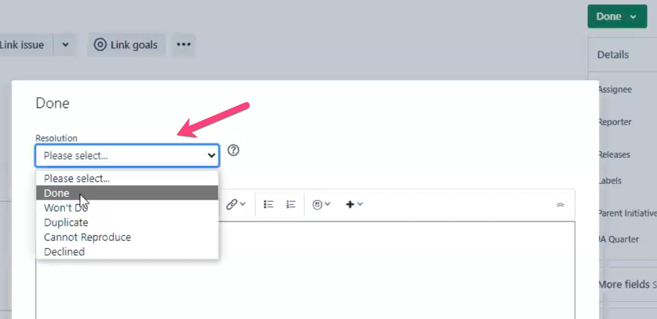

Setting the Done Status (or equivalent ) in the Jira work item did successfully result in the related Jira Align work item being set to Accepted but during the process it was seen that, in Jira, a pop-up screen appears that defaults to a Resolution of "Please select..."

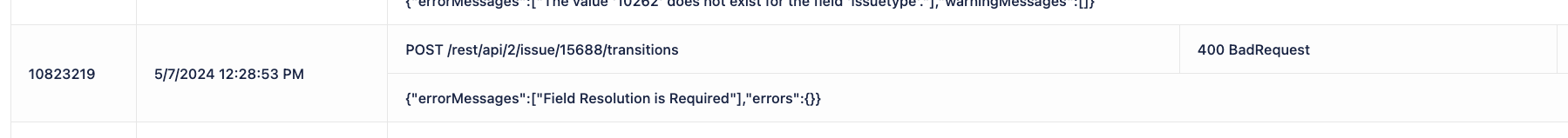

The Jira API log ( Settings > Jira Settings > View Logs > set Item dropdown to Jira API ) records that a POST call to a transitions endpoint (/rest/api/2/issue/...../transitions) has failed with Response: 400 Bad Request
⚠️ The exact text shown in the "errorMessages" parameter, as seen in the above example may differ as it is configurable in Jira

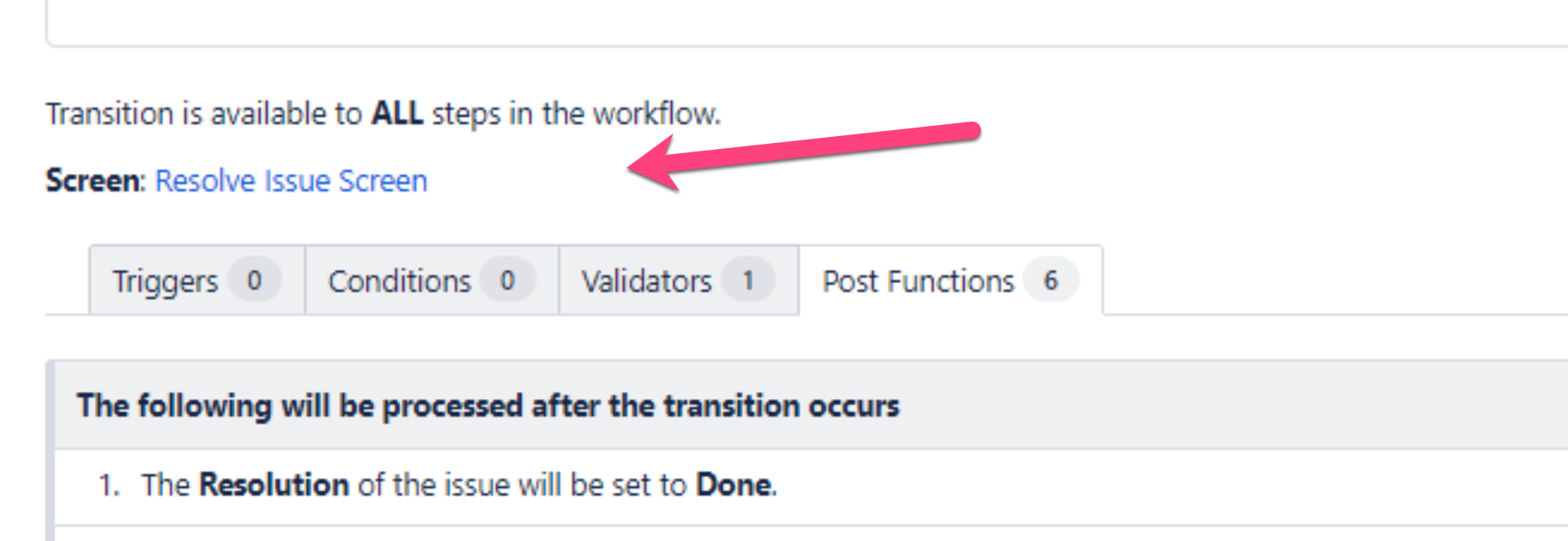

In Jira, the transition to Done in the Workflow of the affected Jira Projecthas a Resolve Issue Screen enabled
ℹ️ Use of such a screen is discussed in this KB article: Jira issues need a resolution

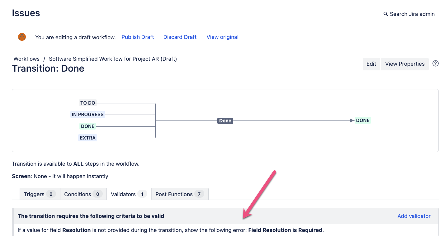

In Jira, the transition to Done in the Workflow of the affected Jira Project has a Validator configured containing a rule where the Resolution is Required
ℹ️ Use of such a validator is discussed in this Community article: How to make the Resolution field mandatory in the Resolve issue screen

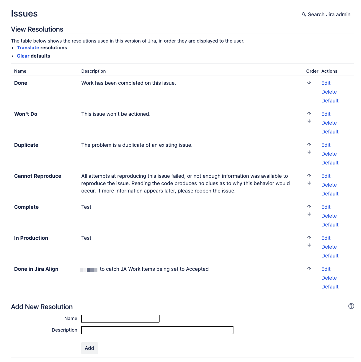

In Jira there is no Default Resolution set in Settings > Issues > Issue Attributes > Resolutions. In the following image, all of the Resolution rows show a link to Default in the Actions column. If the default link is not shown against one of the rows, then this row is the current default. Note: Clicking the Clear defaults link allows no default to be defined.

If the Validator is set to Resolution Required BUT no default Resolution is set in Jira, then setting Accepted in Jira Align will fail triggering the error text configured in the validator settings as the Connector does not provide a Resolution and Jira cannot set the default.
If no Validator is set AND no default Resolution is set in Jira, then setting Accepted in Jira Align will work as the resolution is set to Done. Note: the setting to Done in this situation happens at a point in the Jira process that is after when any validators are checked, hence it does not apply when a Validator rule has already failed.
ℹ️ Use of the Resolve Issue Screen itself does not cause the issue, however it is mentioned in this article as customers that are trying to enforce that Jira users manually set a Resolution when choosing the Done status will be using a Resolve Issue Screen

Set a Default Resolution in the Jira settings (leaving the Validator rule enabled). This will require training any user that marks work items as Done in the Jira Project that they must always check that the Resolution is correct, when the pop-up screen appears. If a specific default Resolution that identifies as Resolved by Jira Align is created , then it is more likely that a Jira user will notice that they need to change it, and there may be a benefit of being able to report, in Jira, on which issues were resolved within Jira Align.
Remove the Validator for requiring a Resolution from the Transition to Done in Jira (with no default Resolution). This will require training any user that marks work items as Done in the Jira Project that they must change the Resolution from "Please select..." to something appropriate when the pop-up screen appears.
