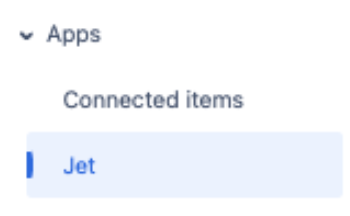

  • Select “Project Settings”
  • Expand “Apps“ and select “Jet“

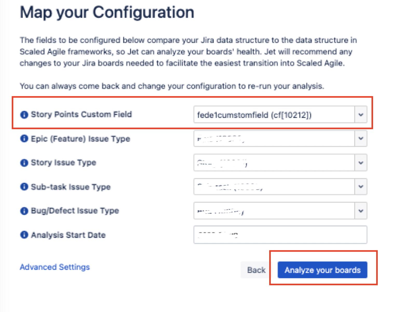

  • Select the board you want to scan and click 'Next'
  • Select the “fede1cumstomfield(cf[10212])“ that is the 'text' type for the “story Points Custom Field“

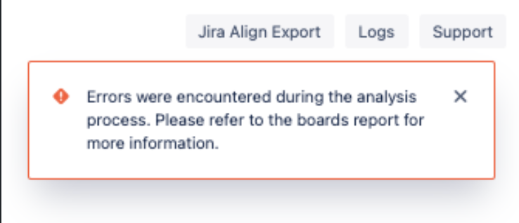

  • Click “Analyze your board” and you will see this
  • An error occurred when the "Map your Configuration" field had a wrong custom field for the "story point custom filed" that is not associated with the Screen associated with the project or the custom field type is text instead of a numerical
Solution
Select the appropriate custom field in the "Map your Configuration" section for the "story point custom field" linked to the project screen.
