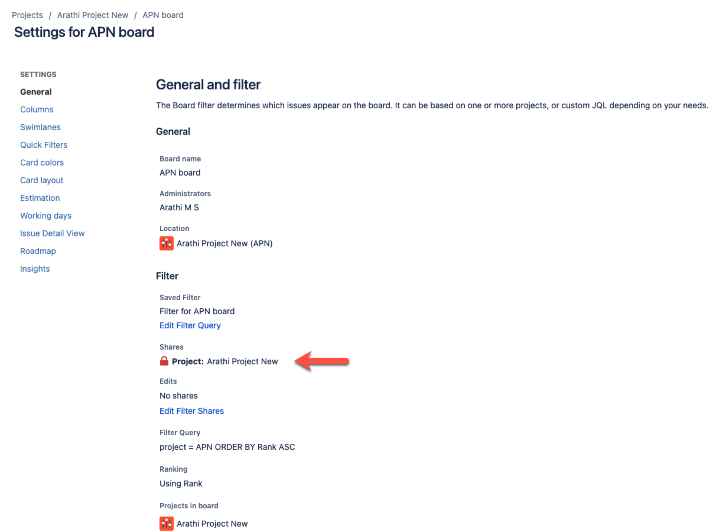

  2. Navigate to Jira board settings in Jira:
    • Open the Jira Board.
    • Access the three dots in the upper right corner.
    • Open the Board Settings.

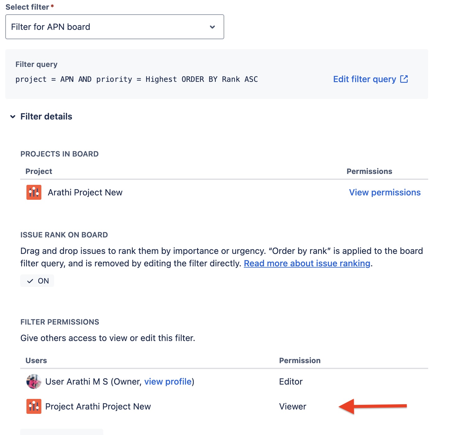

  3. Check the Filter share option and ensure the Jira Board filter share includes the board's parent project, does not include any other projects, and is a Viewer share, NOT an Editor Share. The image below shows only a single project share listed in the correct location for a Viewer share. If the project share shows in the Edits section just below, then this can cause the error and needs correcting by clicking "Edit Filter Shares" and setting the project up as a Viewer Share (but also removing any Editor Shares)
Single project share listed in the correct location for a Viewer share.
The error will resolve itself after setting the board's filter share to include its parent project after the completion of the next automated board sync via the connector.
