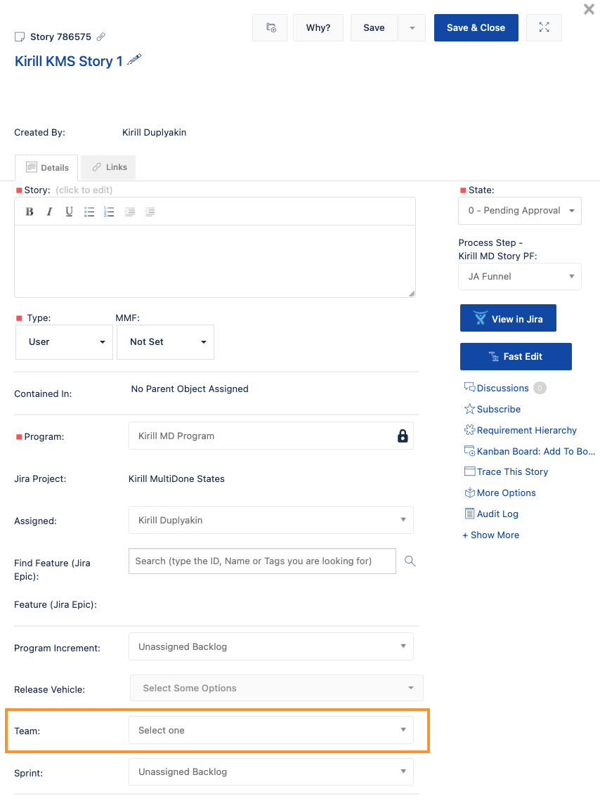

The Jira Team is not being automatically assigned to the newly created JA work items.
OR The Jira Team is assigned incorrectly in Jira Align.

The JA work item team field is empty or incorrect.

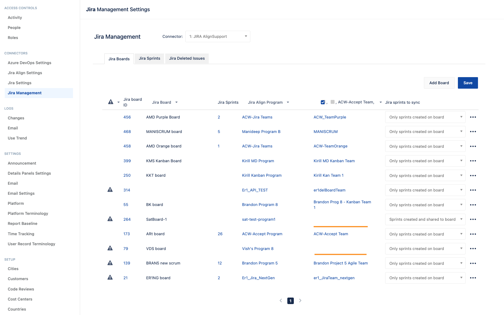

  1. Team is not mapped for the project board in Administration > Jira Management > Jira Boards

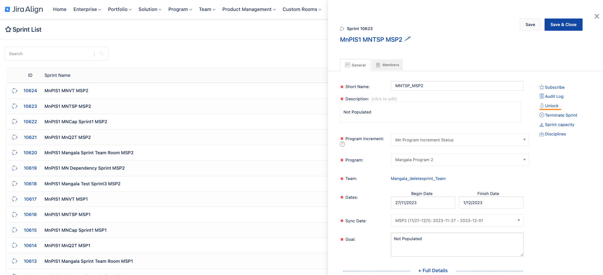

  4. The work item was assigned to a sprint that has been locked in Jira Align.

  1. Check that the Jira project board is listed in JA Administration > Jira Management > Jira Boards and that the correct Team has been assigned to it. Sometimes spelling errors occur, as it is not a dropdown field.

  4. Check if the Sprint is locked and try unlocking it
