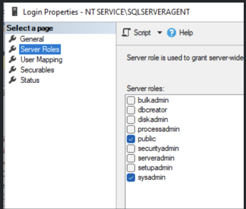

  3. Open the SQL Server Management Studio being used, log into the DB
  4. On the Left Panel > Security > Logins: find the user in question > right-click > Properties (if the user is built-in Local System, on the DB it will correspond to "NT AUTHORITY\SYSTEM”)
  5. On the Server Roles tab, mark the sysadmin option
  6. (Auto-migrated image: description temporarily unavailable)
  7. Return to the SQL Server 20xx Configuration Manager> SQL Server Services try to start the service
