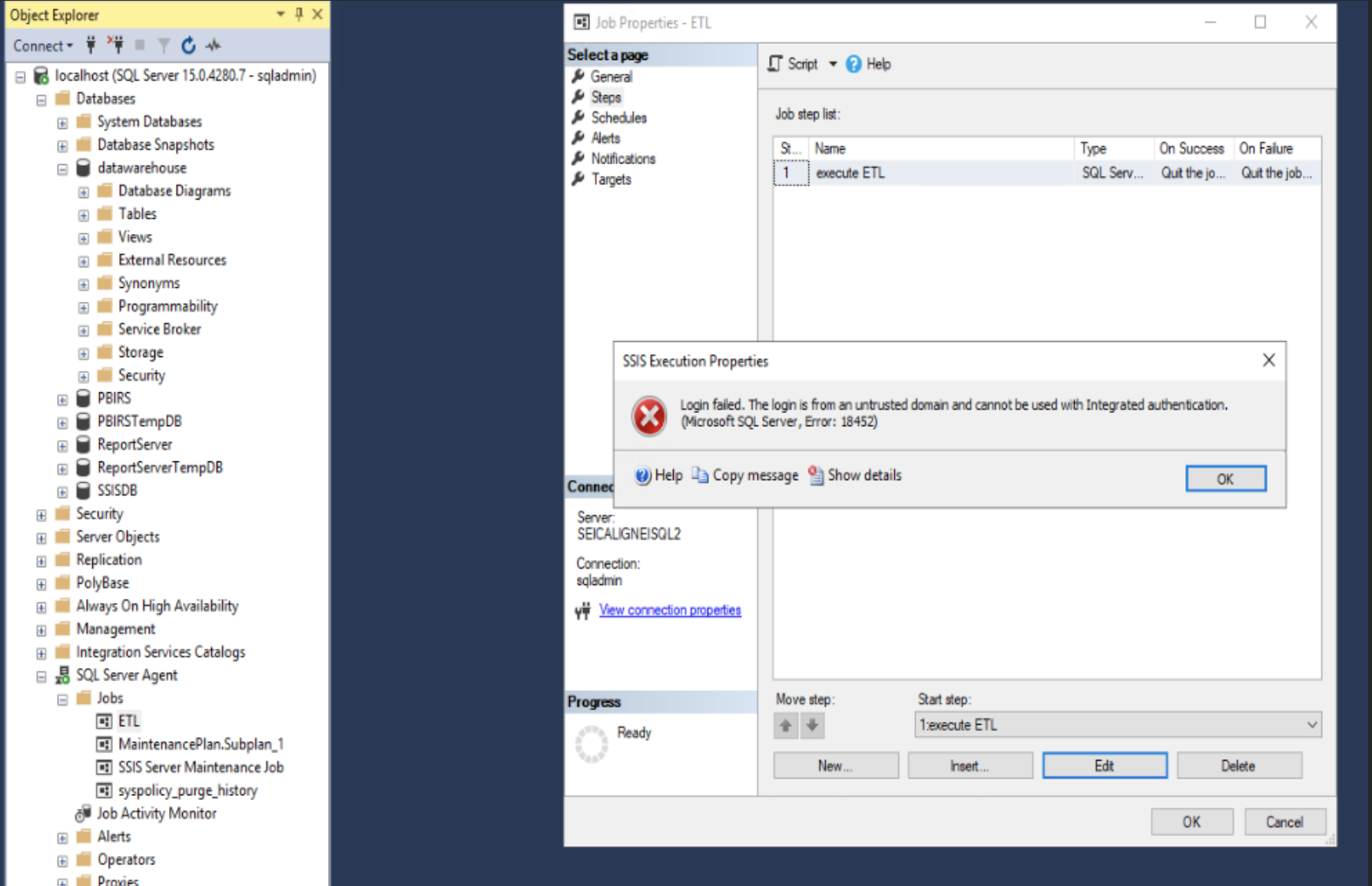

Going to the server of Enterprise Insights, we can get the logs of the Windows Event Viewer and ETL logs from the SQL Server.
On the Windows Event View, we will be able to see the following error:
SSPI handshake failed with error code 0x8009030c, state 14 while establishing a connection with integrated security; the connection has been closed. Reason: AcceptSecurityContext failed. The operating system error code indicates the cause of failure. The logon attempt failed [CLIENT: 10.200.6.50]
The user can check that the main issue is that the SQL Job is not working. We can go to SQL Server > SQL Server Agent > Jobs and confirm that the Job is not starting and it is triggering the error "The job failed. The job was invoked by user<user>. The last step to run was step1".
Expanding the error detail, we were able to see the error message: "Login failed. The login is from an untrusted domain and can't be used with Integrated authentication. (Microsoft SQL Server, Error: 18452)"
The full message of the errors:
Login failed. The login is from an untrusted domain and cannot be used with Integrated authentication. (Microsoft SQL Server, Error: 18452)
The job failed.  The Job was invoked by User sqladmin.  The last step to run was step 1

Regarding the error "The login is from an untrusted domain and cannot be used with Integrated authentication. (Microsoft SQL Server, Error: 18452)". That would typically indicate an issue with the authentication mode used by MS SQL Server. Integrated authentication means Windows Authentication and the login attempt originates from a domain that is not trusted.
https://learn.microsoft.com/pt-br/sql/relational-databases/errors-events/mssqlserver-18452-database-engine-error?view=sql-server-ver16
This message comes from the ETL job created, and it is worth mentioning that the user account that is indicated during the installation script is linked to the job.
 So, this error is related to that user linked to the Job. Since the job was created and related to a user, the only way to change it is to run the EI script again to override the ETL job created.

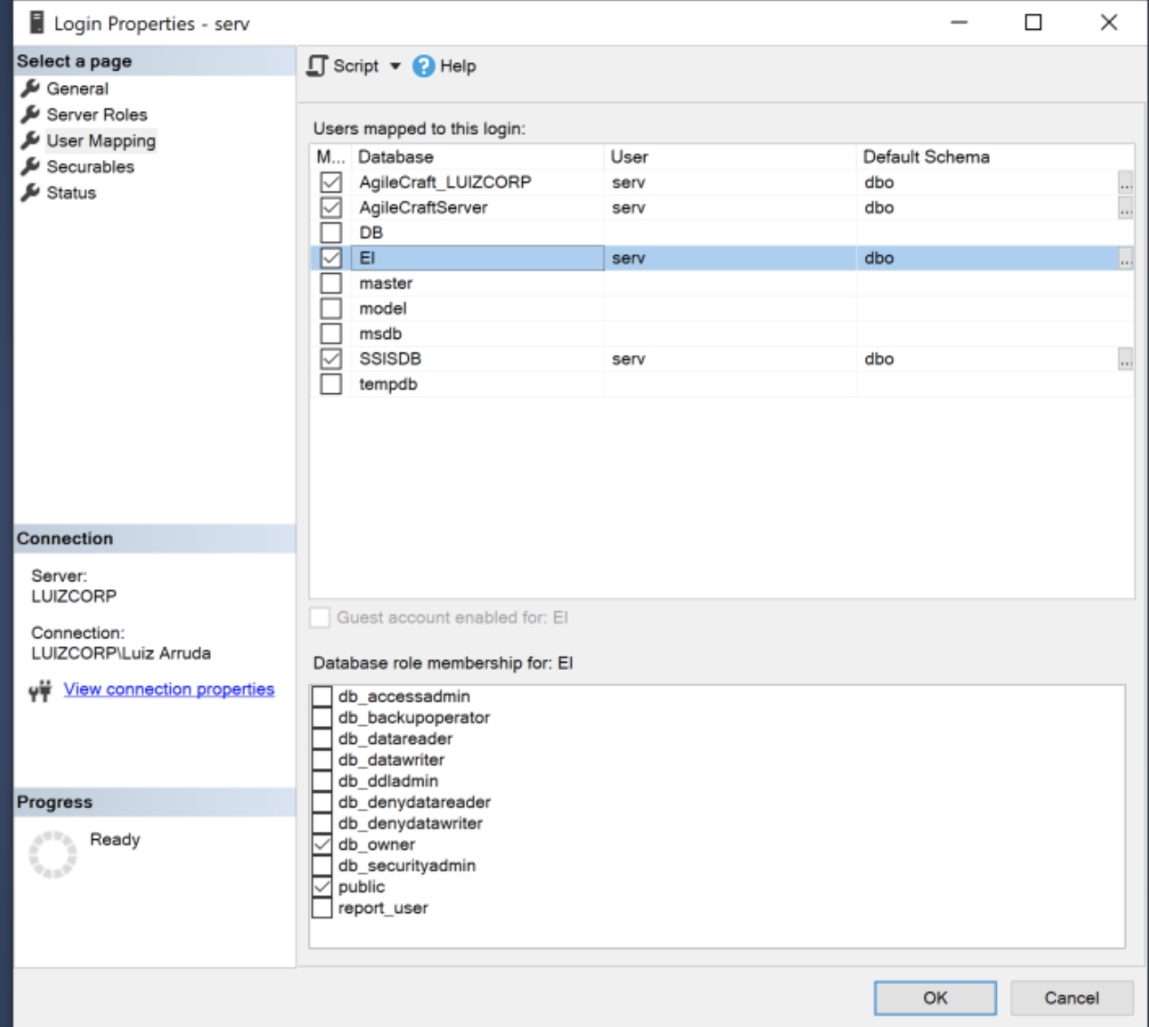

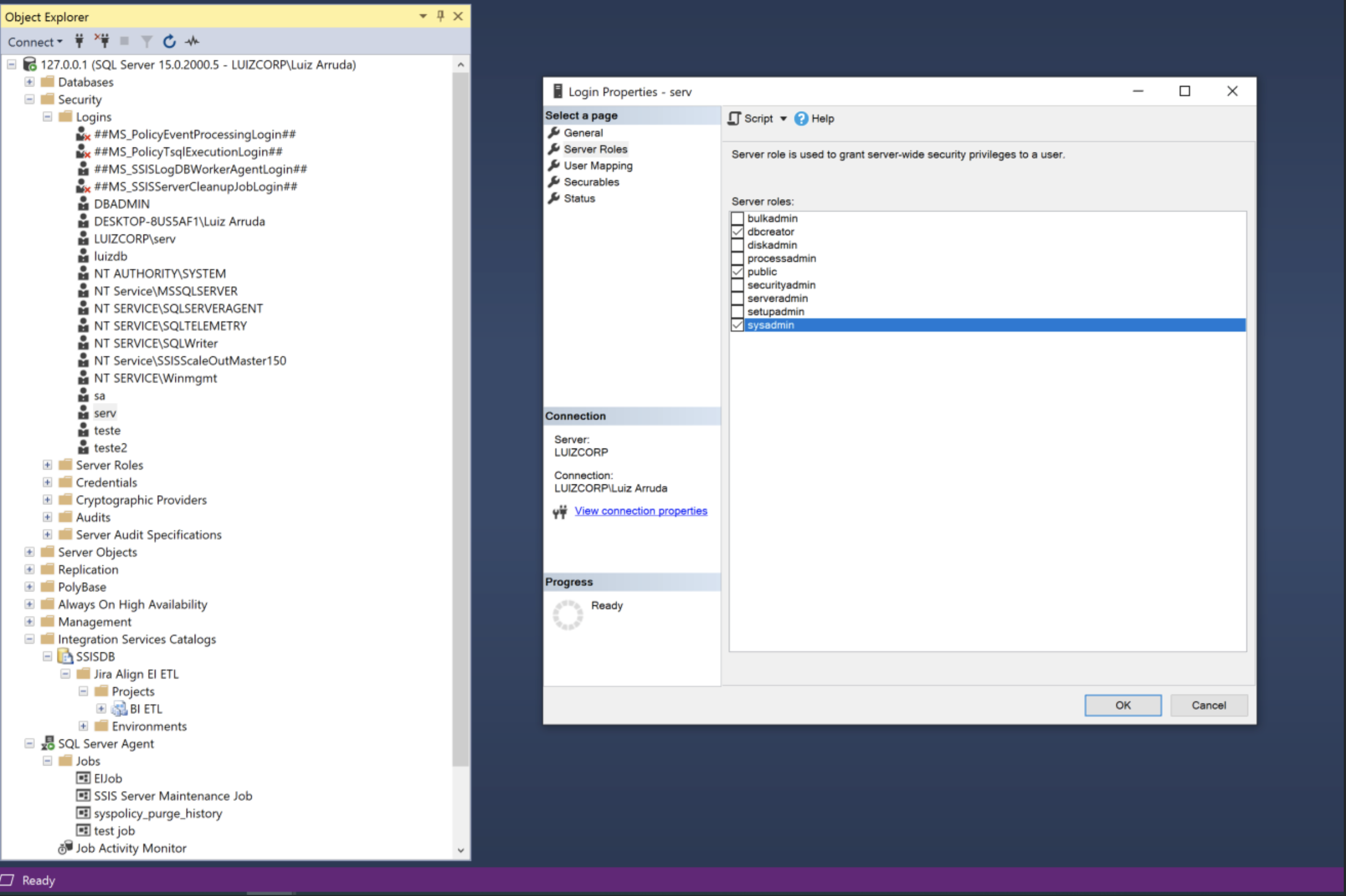

Regarding the error "18452 - The login is from an untrusted domain and cannot be used with Integrated authentication", the user has to go to SQL Server > Security > Logins and:
  1. Check if the Windows user is added to log into the SQL Server and the instance of EI.
  2. Suppose the server role is sysadmin. For that, the user can right-click on the login user and go to the "Server Roles” tab.

  4. On the “User Mapping” tab, the user account has to be checked for the Jira Align tables, EI table, and SSISDB table.
  5. (Auto-migrated image: description temporarily unavailable)
  6. Note that the table of user accounts explains which role each user has to be. For the EI table, it is db_owner.

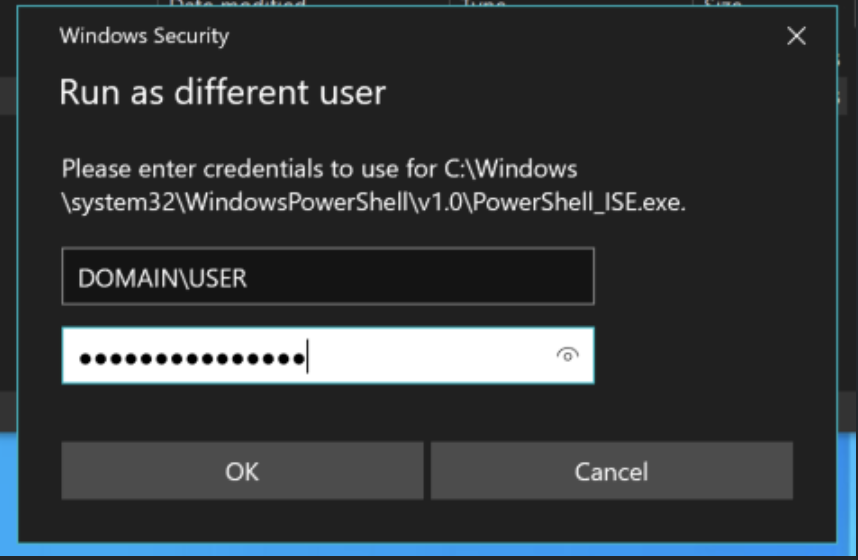

After checking the user's account, we can follow the script, and when running the script, the user must be sure to use a Windows account inserted into the System Admin group. This Windows user must be in the same Domain as the SQL Server server.
To make sure of it:

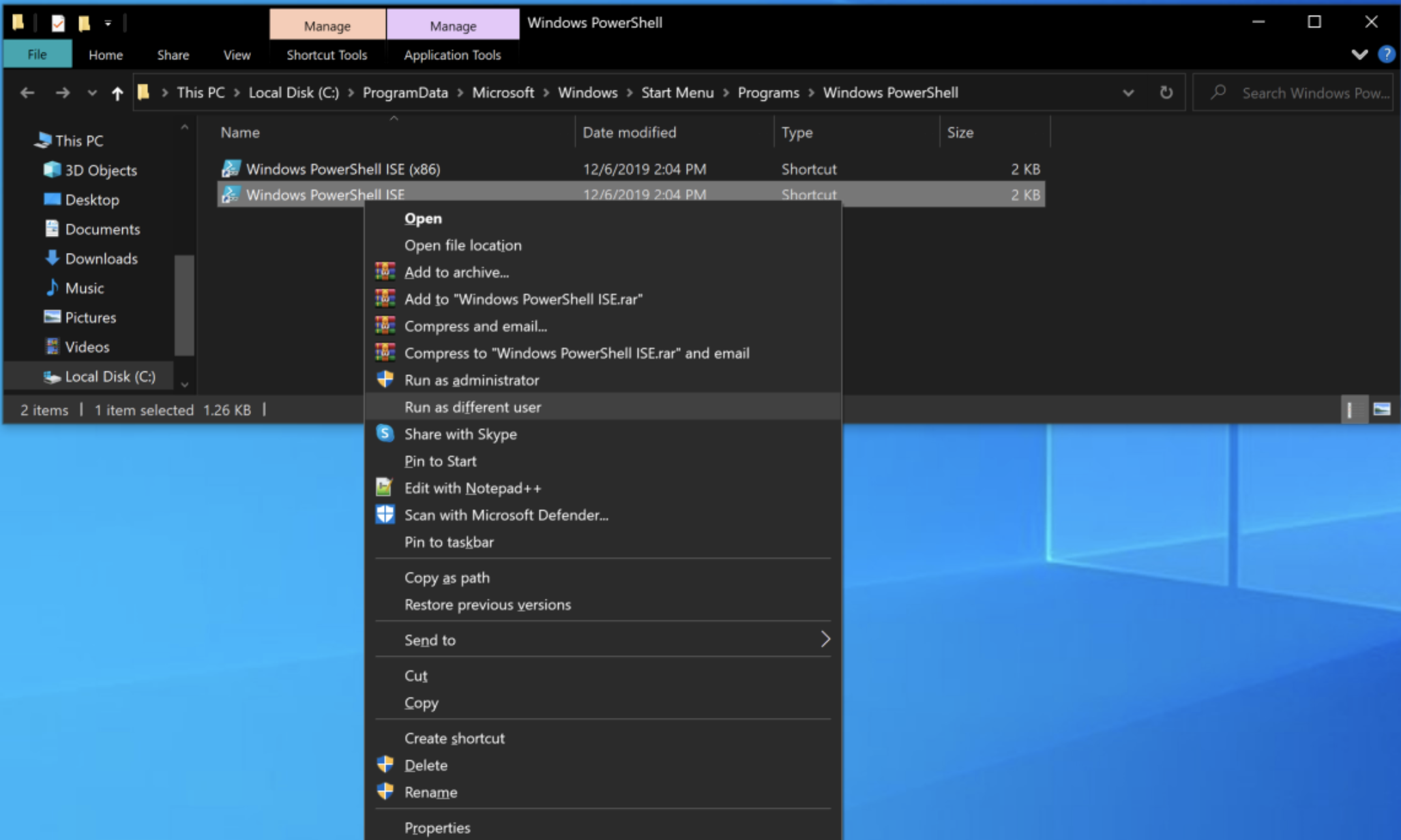

  • Open the PowerShell as another user, and for this:
    • Press shift, Right-click on the PowerShell file, and click on “Run as a different user.”
    • (Auto-migrated image: description temporarily unavailable)
    • Make sure that the Windows user is inserted in the same Domain of the servers, application, and database.
    • Depending on the structure of the Domain Group of the user, a Local Admin User of the database server can be used to run the installation script
