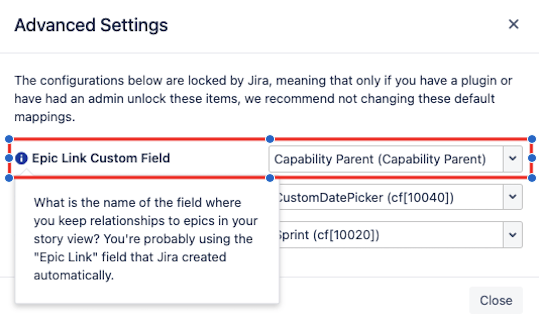

The issue is caused by a configuration mismatch in JET’s advanced settings as shown in the sample below where "Epic Link Custom Field" is mapping to "Capability Parent (Capability Parent)":

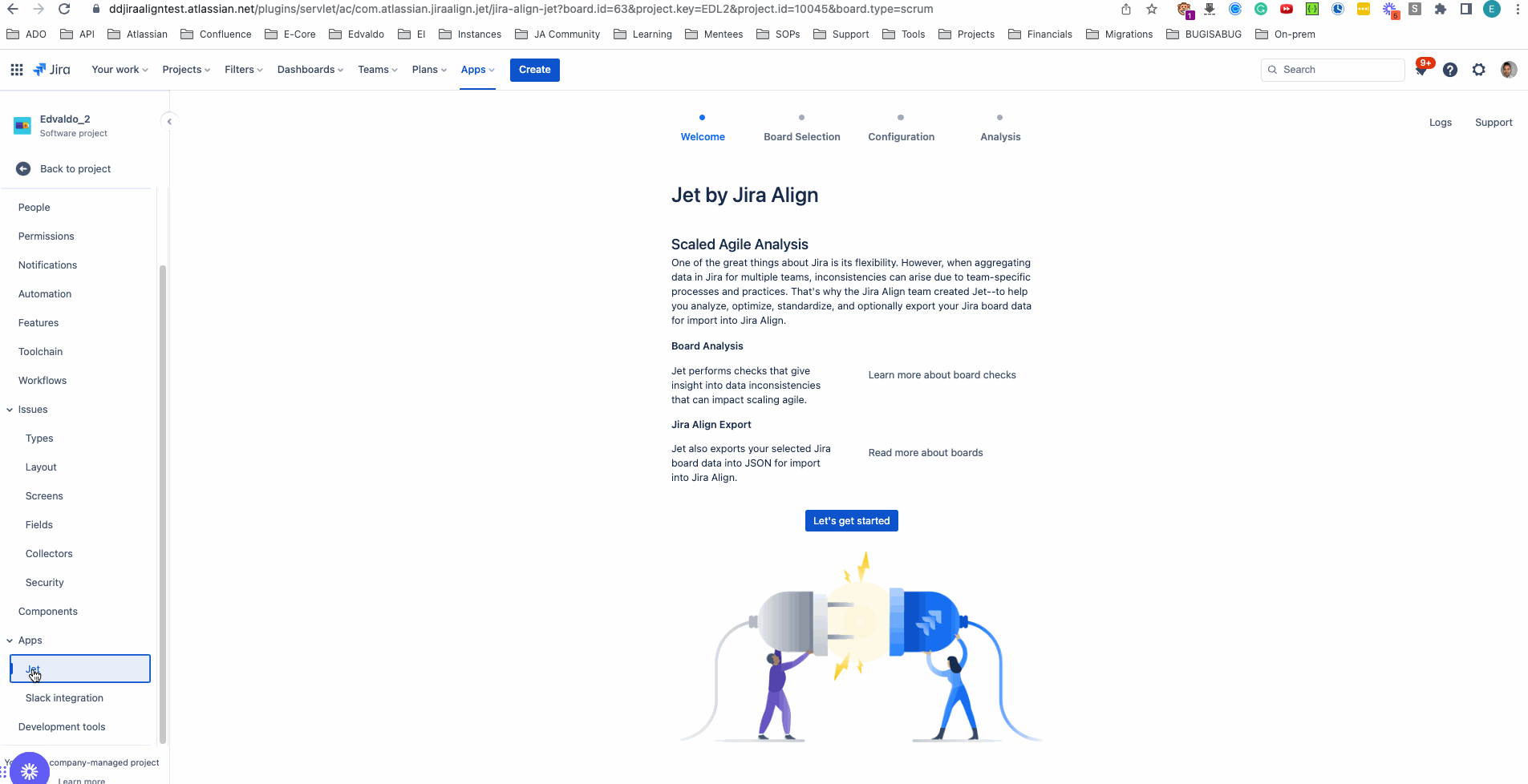

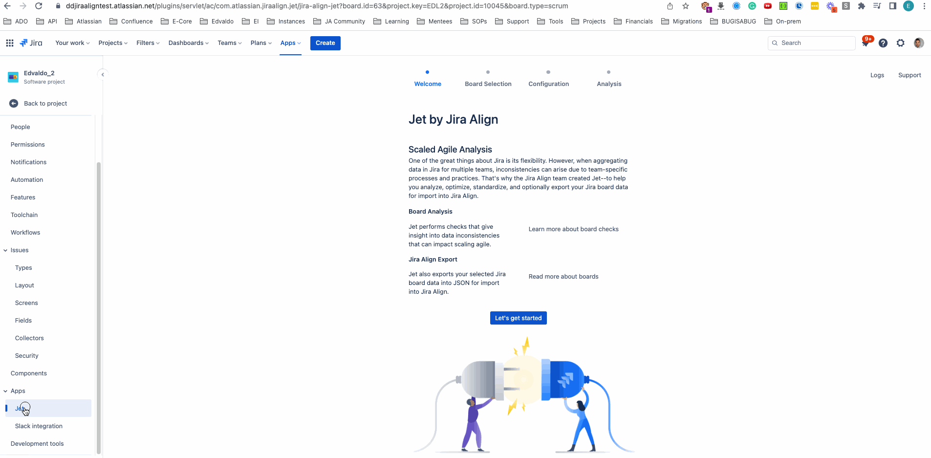

To fix the issue we need to ensure the "Epic Link Custom Field" is mapping to the "Epic Link” custom field.
This is accomplished following the steps shown in the illustration below:
