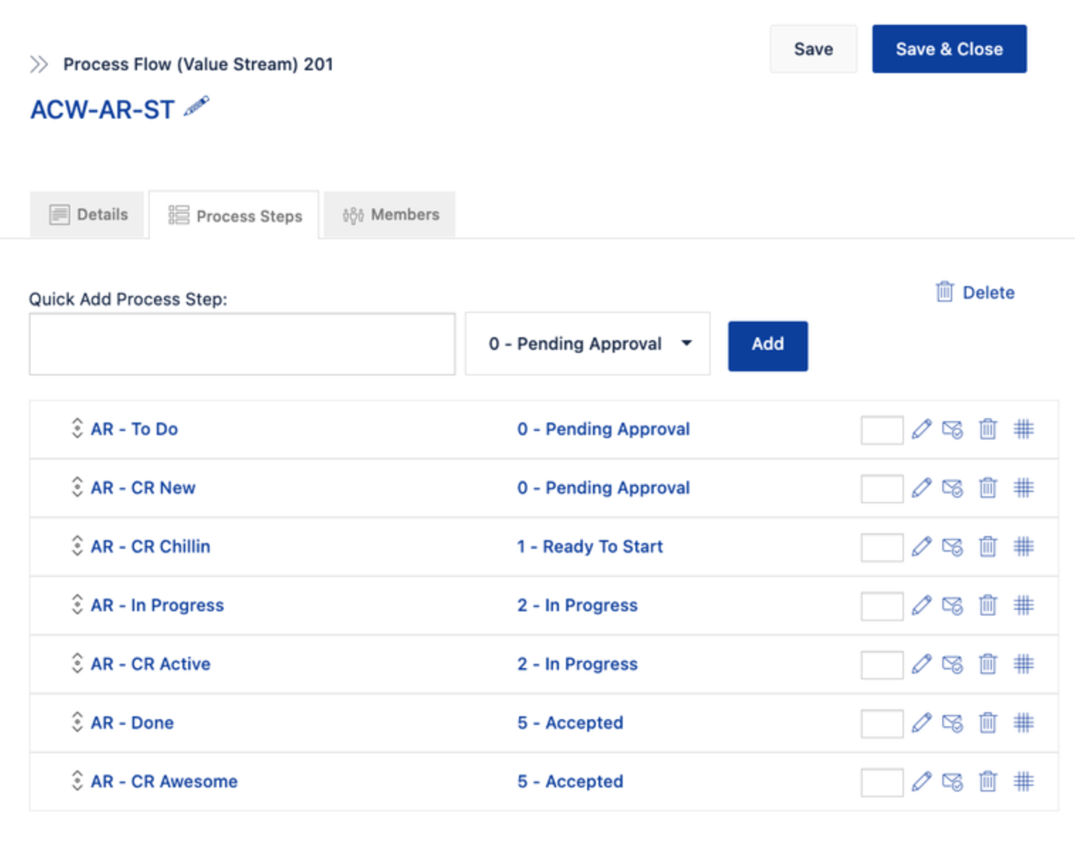

  9. Add one process step for each story level status identified in Jira Step 4 and Jira Step 6 (in effect covering all of the statuses for all of the story types in the same project).
  10. It is strongly recommended to have a naming convention for the Process Steps that clearly identifies which Process Step is associated with which story type.
  11. If Map to State is enabled, then this will result in some states being connected to more then one process step
  12. Adjust the order of Process Steps as required (in the example image shown below, any Process Steps with CR in the name, were Process Steps to be mapped to Jira statuses for a custom issue type called Change Requests, those without CR were for standard stories)
  13. Click Save and Close

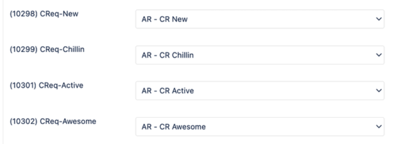

  7. For each of the Jira Statuses noted in Jira Step 4 and Jira Step 6 configure a connection to the correct Process Step. The following image shows the Jira Statuses used with the example of setting up a custom issue type for Change Requests. In addition to those entries shown in this image, the Jira Statuses for the standard story type were also configured but not shown as in our test environment there are hundreds of Jira Statuses in this list and you only need to configure those used in the same Jira project
  8. Click Update Steps and then close the pop-up page

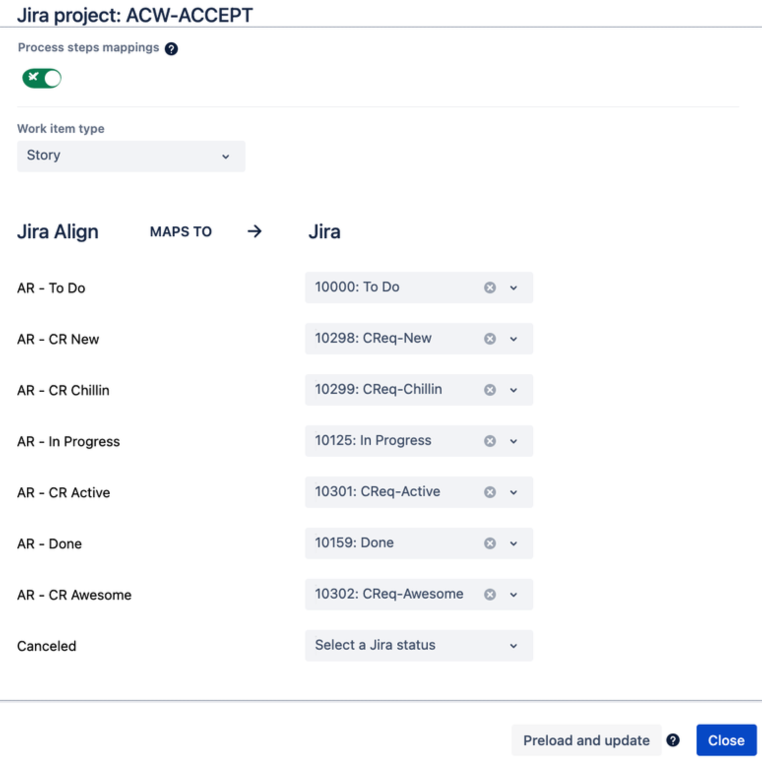

  9. In Settings/Administration > Jira Settings > Manage Projects locate the Jira Project from Step C:2 and click the State Mapping link for that project
  10. Make sure the Process steps mappings toggle is enabled and Work item type is set to Story (or if using an old version of Jira Align that the State / Process Step (green box) is set to Process Step with the Work Item type of Story)
  11. Configure each Process Step to connect to the correct Jira State (Status) based on the details noted in Jira Step 4 and Jira Step 6. The below images continues with the example of configuring a custom issue type for Change Requests
  12. Click Preload and update (or Update)and then close the pop-up page
