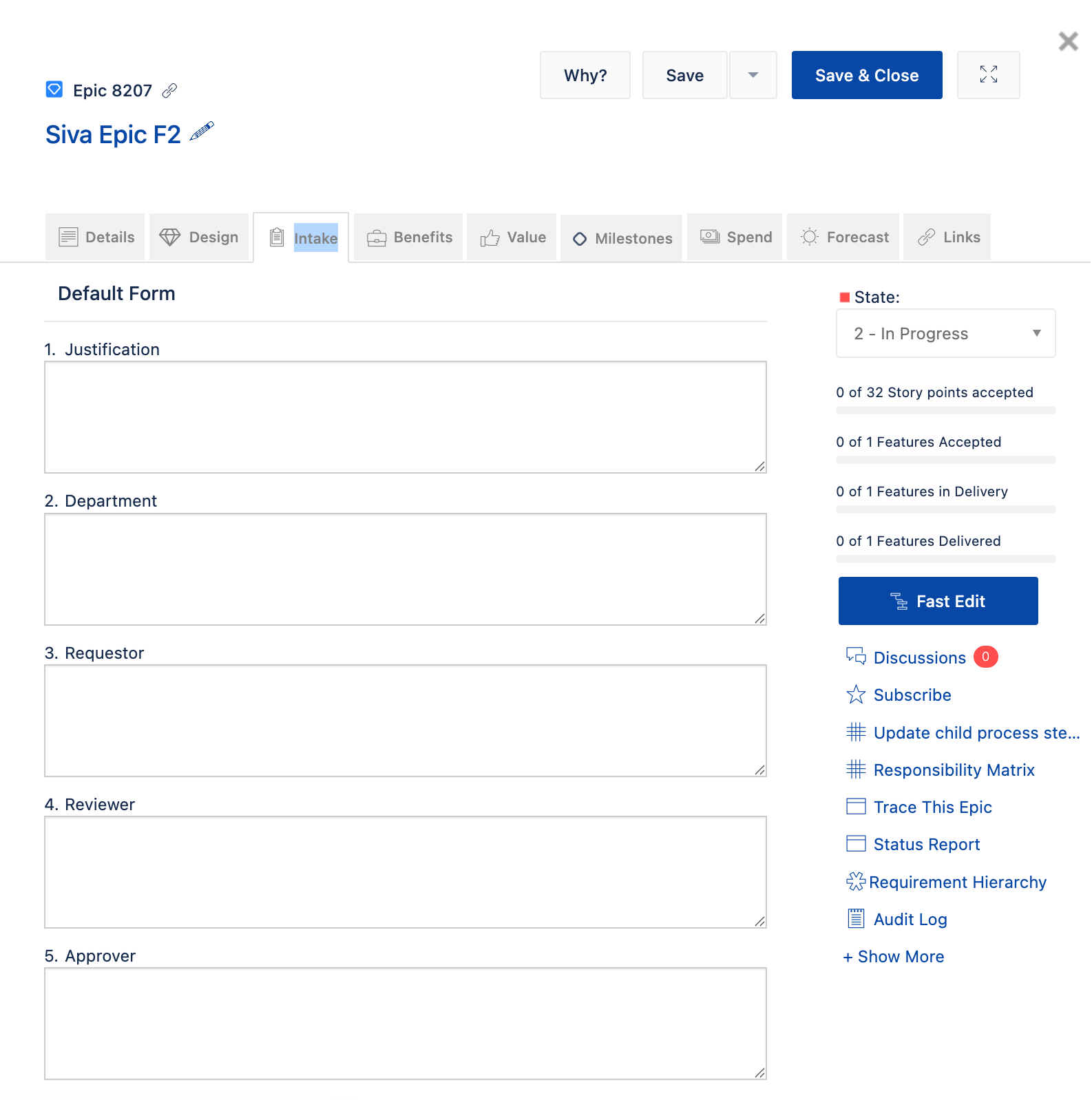

  1. We can use the below query to identify the custom field details for the Intake form data used in the Epics:
    1. https://<ja_instance>/rest/align/api/2/Epics/<epic_id>/editmeta
  2. Once we have the custom field IDs, we can update the values for the specific Intake form entries via a Patch request:
    1. https://<ja-instance>/rest/align/api/2/Epics/<epic_id>/
    2. Body should contain the data to be replaced.
Example Epic Intake form for Epic ID 8158 in Jira Align:
Using GET API request for fetching Custom field details:
https://<ja-domain>.jiraalign.com/rest/align/api/2/Epics/8207/editmeta
API Results:
1 2 3 4 5 6 7 8 9 10 11 12 13 14 15 16 17 18 19 20 21 22 23 24 25 26 27 28 29 30 31 32 33 34 35 36 37 38 39 40 41 42 43 44 45 46 47 48 49 50 51 52 53 54 55 56 57 58 59 60 61 62 63 64 65 66 "customFields": [        { "customfield_70001": { "type": 1, "required": false, "active": false, "name": "Justification", "schema": { "type": "string", "customId": 70001 }, "key": "customfield_70001" } }, { "customfield_70002": { "type": 1, "required": false, "active": false, "name": "Department", "schema": { "type": "string", "customId": 70002 }, "key": "customfield_70002" } }, { "customfield_70003": { "type": 1, "required": false, "active": false, "name": "Requestor", "schema": { "type": "string", "customId": 70003 }, "key": "customfield_70003" } }, { "customfield_70004": { "type": 1, "required": false, "active": false, "name": "Reviewer", "schema": { "type": "string", "customId": 70004 }, "key": "customfield_70004" } }, { "customfield_70005": { "type": 1, "required": false, "active": false, "name": "Approver", "schema": { "type": "string", "customId": 70005 }, "key": "customfield_70005" } }
PATCH request to modify the string "Department" whose ID is 'customfield_70002':
Path should indicate the position of the custom field (in our case, the array location is 1 as per the above GET request)
1 2 3 4 5 6 7 8 9 10 11 12 13 14 15 [ { "op":"replace", "path":"customFields/1", "value": { "customfield_70002": [ { "value": "test Siva" } ] } } ]
