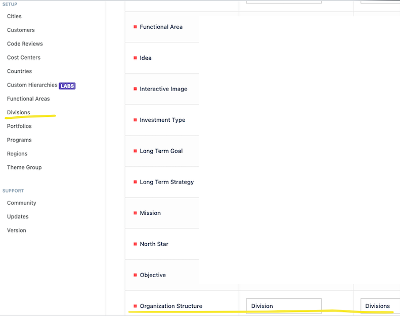

  • The Enterprise Hierarchy list is found in the Jira Align (JA) user interface at Administration > Setup > Organization Structure (default platform terminology).
  • The Jira Align default platform terminology can be checked at Administration > Settings > Platform Terminology.
  • The sample screenshot highlights the Organization Structure (Enterprise Hierarchy) on the left menu bar with the platform terminology name 'Divisions' and the right side showing the platform terminology configuration for the same:
Organization Structure (Enterprise Hierarchy) on the left menu bar with the platform terminology name 'Divisions' and the right side showing the platform terminology configuration for the same.
