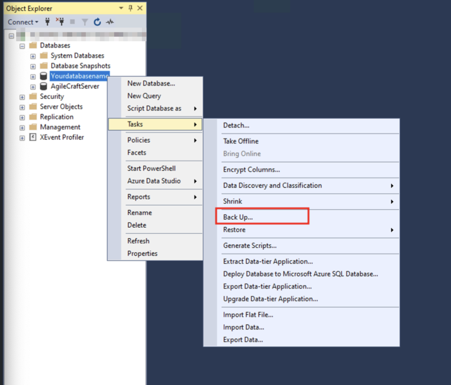

  2. Execute a Full SQL backup of the PROD Database in the PROD instance by right-clicking on the PROD Database then Tasks > Back-Up.., in this example, it is “Yourdatabasename".
    1. (Auto-migrated image: description temporarily unavailable)

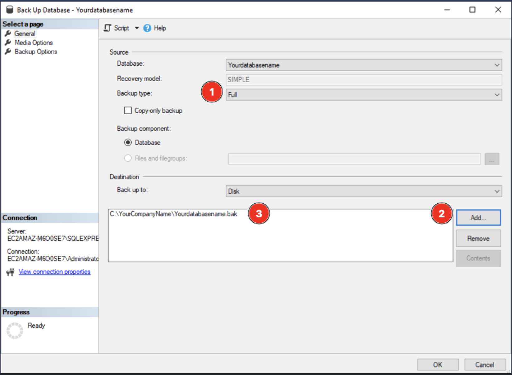

  3. Let the Default Backup type option set as “Full” and select the destination folder and filename.bak by clicking on the ADD button. In this example, the backup is being stored on the Jira Align Folder “C:/YourCompanyName/Yourdatabasename.bak”

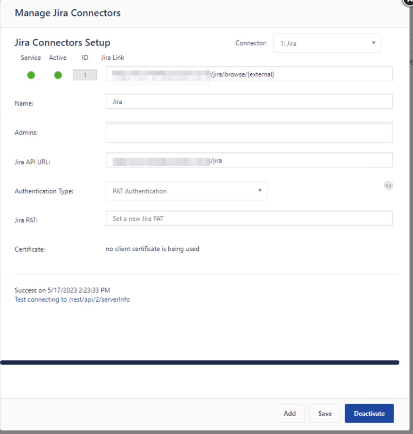

  2. Take screenshots of each connector of the TEST instance on the Administration>Connectors>Jira Settings>Connector dropdown menu:

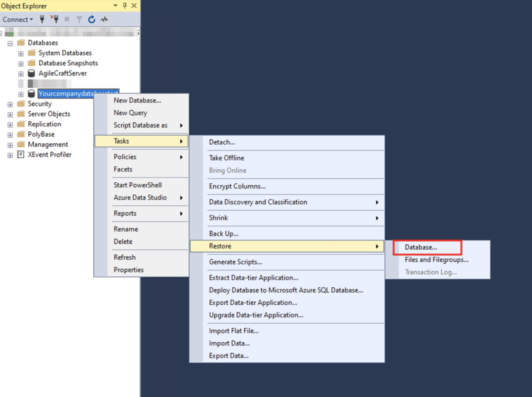

  7. Restore PROD (in this example Yourdatabasename.bak) Database backup on the TEST database by right-clicking on “Yourcompanydatabasetest” and selecting Tasks > Restore > Database:

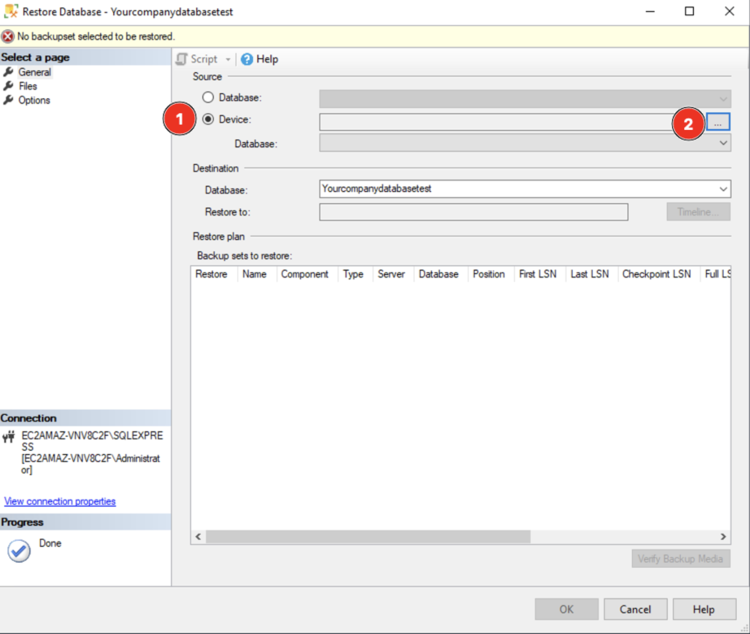

  8. Select the file by enabling the toggle "device” and click on the “…” button:

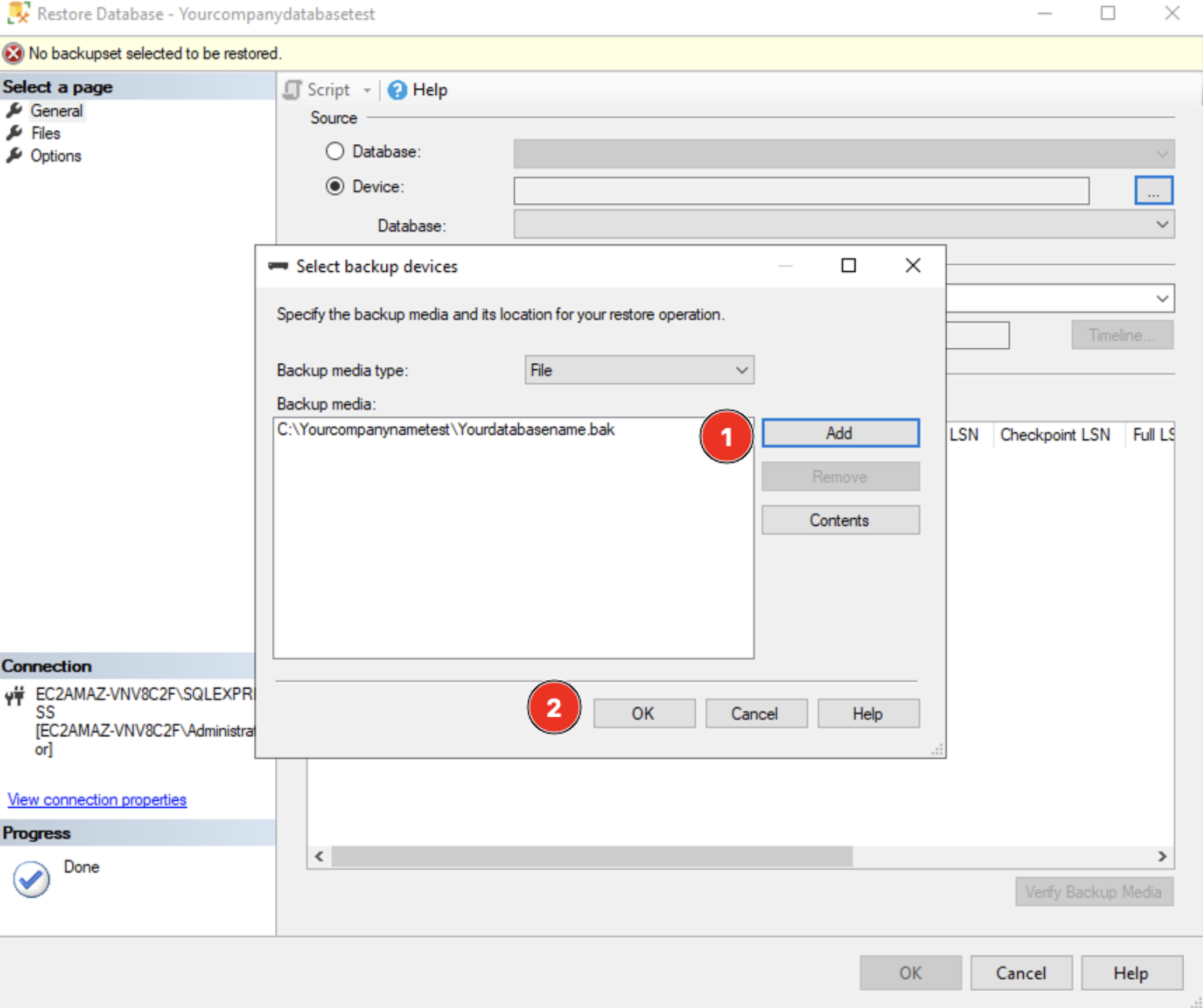

  9. Then Select the PROD Database Backup file by clicking on Add (in this example the file is “Yourdatabasename.bak”) and confirm by clicking on the “ok” button:

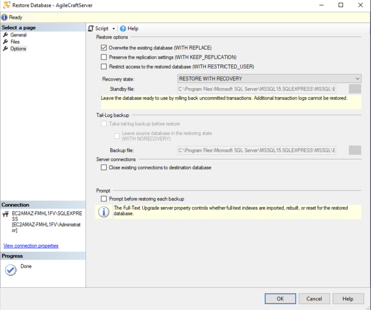

  10. Clicking on the Options tab the "Overwrite the existing database"(WITH REPLACE) option should be enabled:

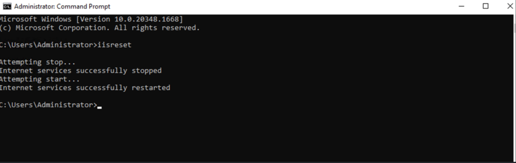

  17. Reset IIS
