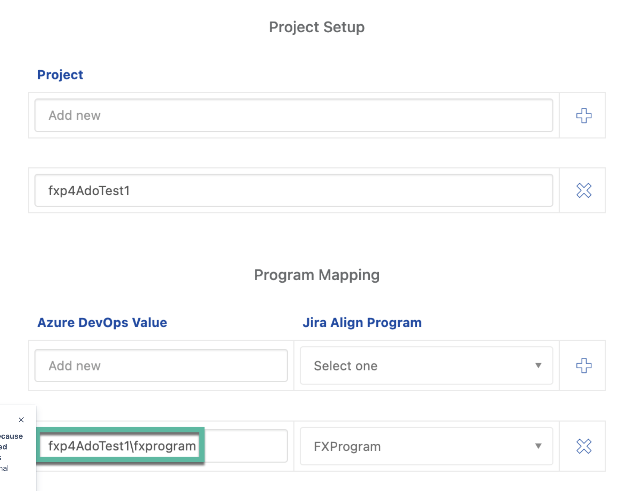

  1. Set the Program mapping to be: {ado-project}\{ado-project-area} to {ja-program} like below:
    1. (Auto-migrated image: description temporarily unavailable)

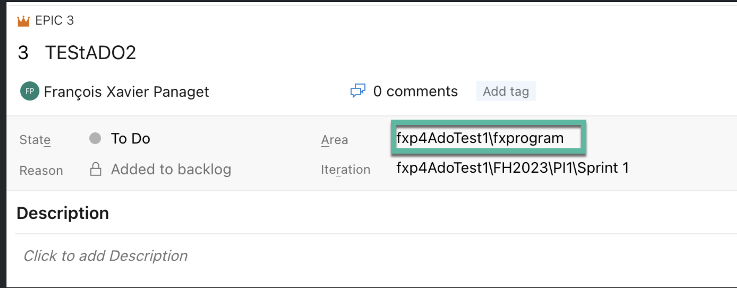

  2. Create an EPIC in Azure DevOps (or any work item mapped to a Jira Align feature) under the area path (e.g. ‘Fx4AdoTest1\fxProgram') you have mapped to your Jira Alig program (e.g. 'FXProgam’) like below:

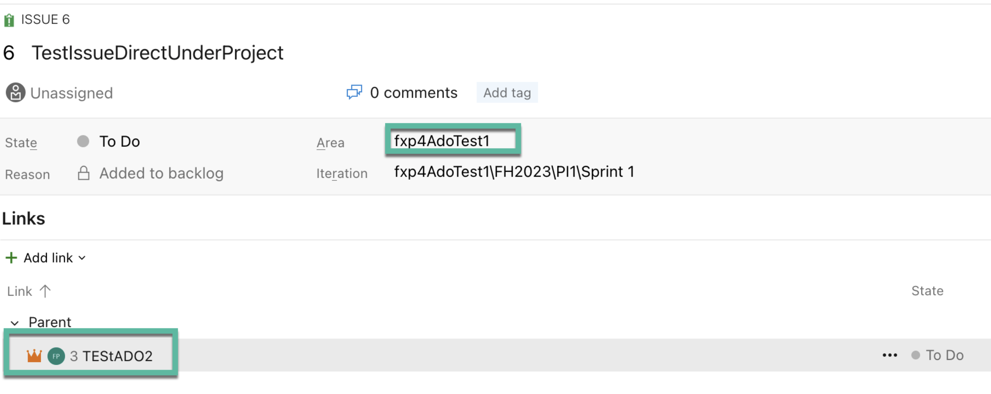

  3. Create an Issue in Azure DevOps (or any work item mapped to a Jira Align Story) under the area 'Fx4AdoTest1' and link it to an Epic (i.e Feature) created before like below:

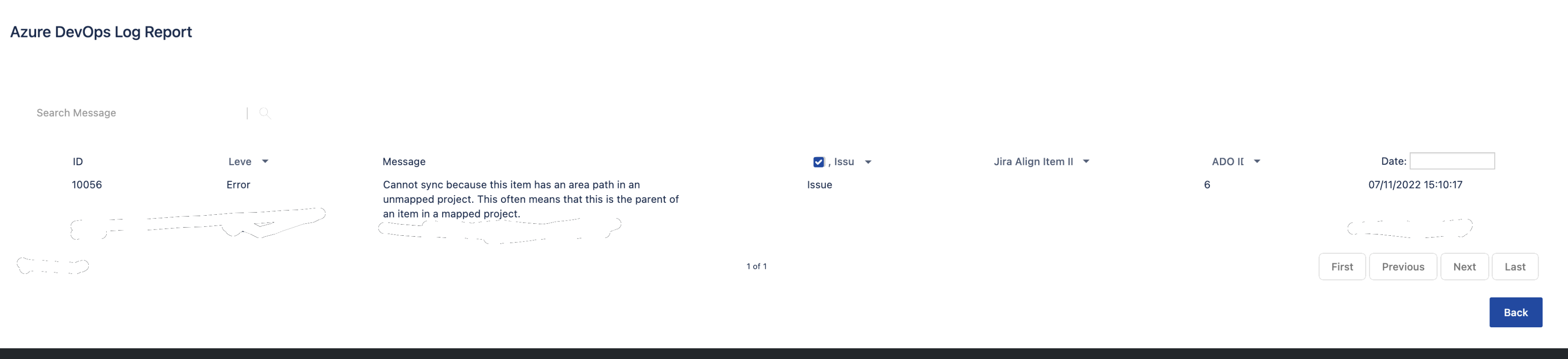

  4. Go to the Azure DevOps Log Report under Azure DevOps Settings > Azure DevOps Connectors > {Connector Name} > Logs and the error will be seen when the synchronization kicks in:

To resolve the error, correct the area path of the ADO work item to not be at the same hierarchy level as that program but rather the one of its parent.
In the above example, it should be ‘Fx4AdoTest1\fxProgram'; the same as for the parent Epic/Feature rather than 'Fx4AdoTest1'.
