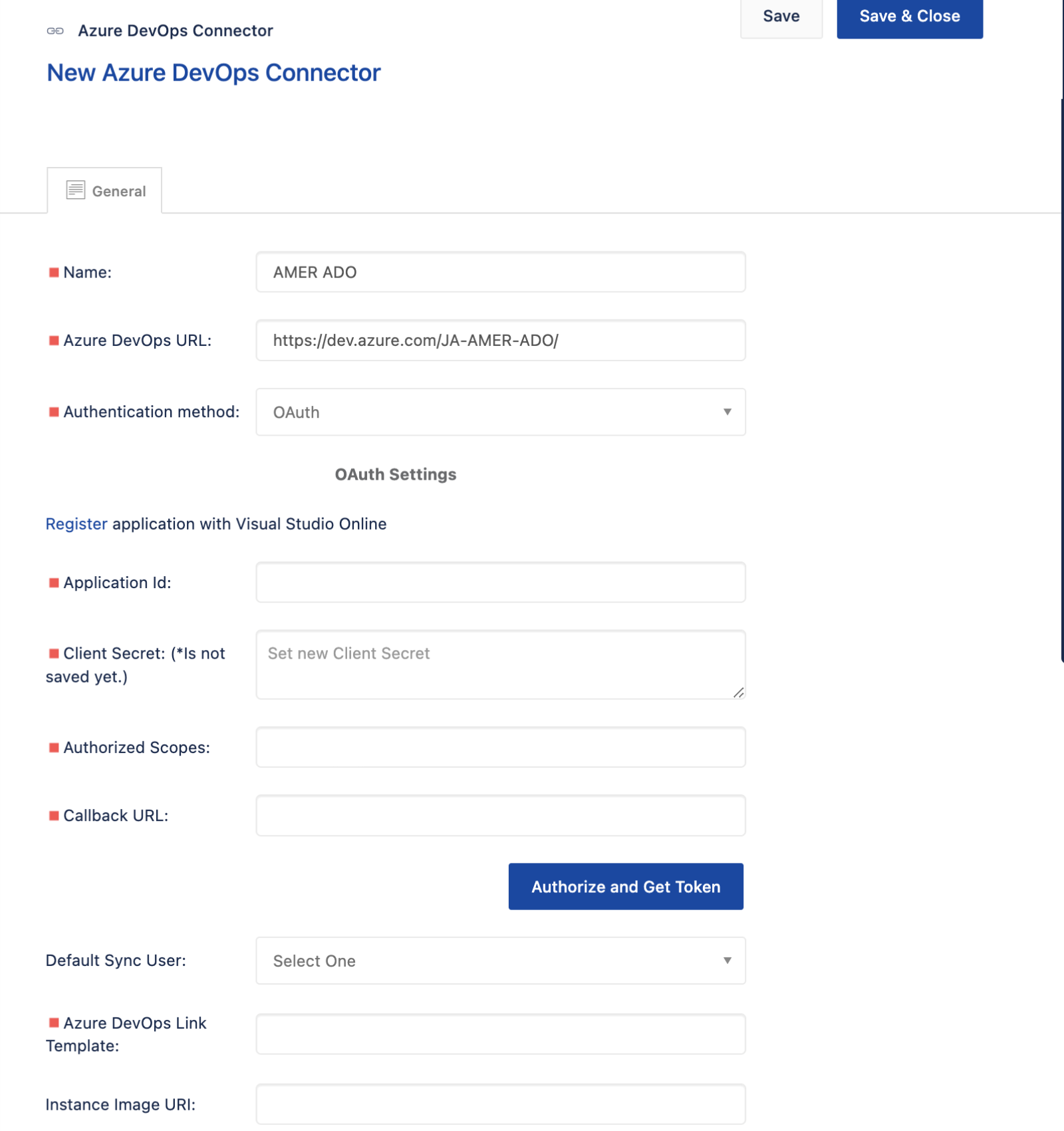

1 - Go to Admin > Azure DevOps Settings > Add Connector (for a new connector), or open the panel for one that already exists.
2 - Enter the Name of the connector, the Azure DevOps URL, and select the Authentication Method as OAuth

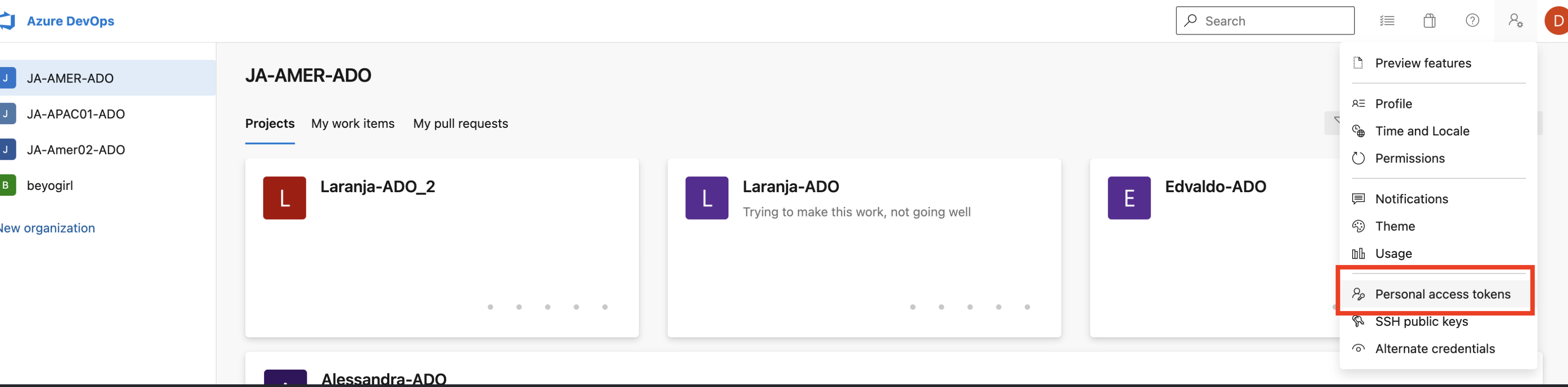

4 - Log in to Azure DevOps with the account that will be used to create the OAuth token. Click on User Settings > Personal Access tokens

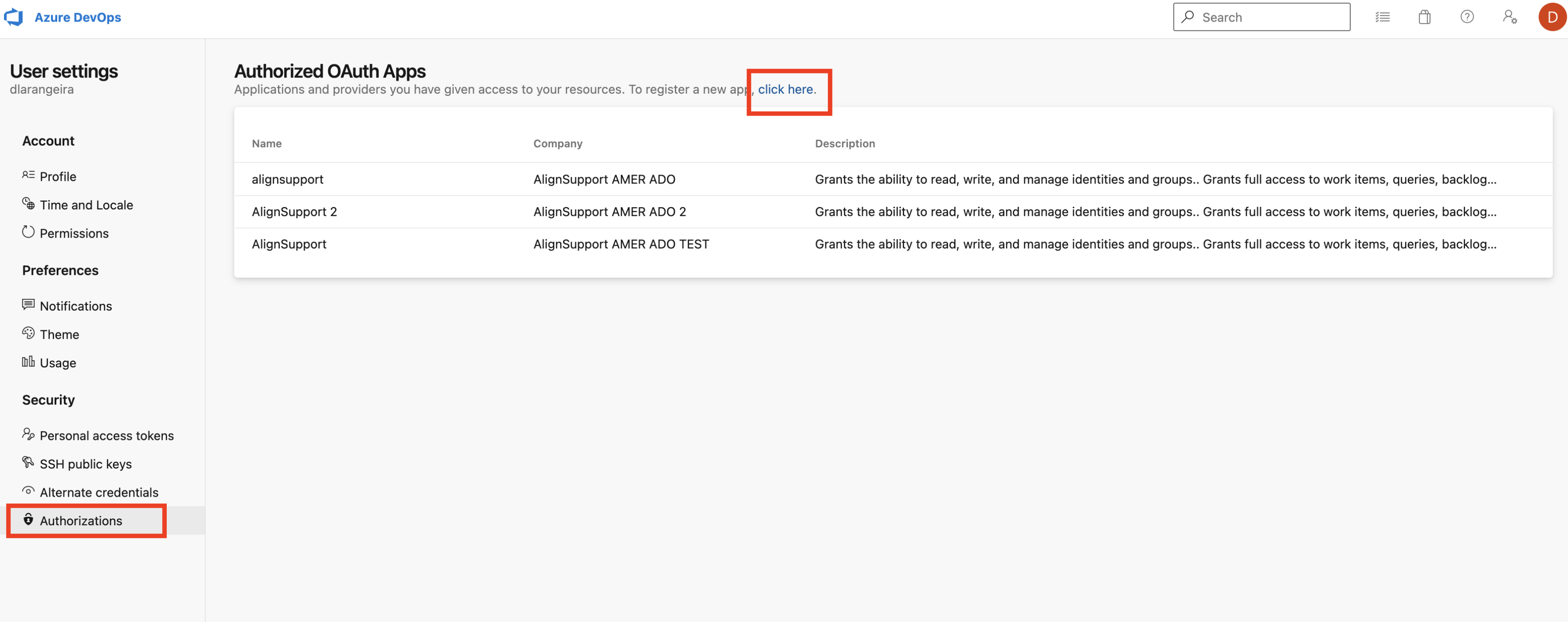

5 - Click on Authorization > click here to create a new one

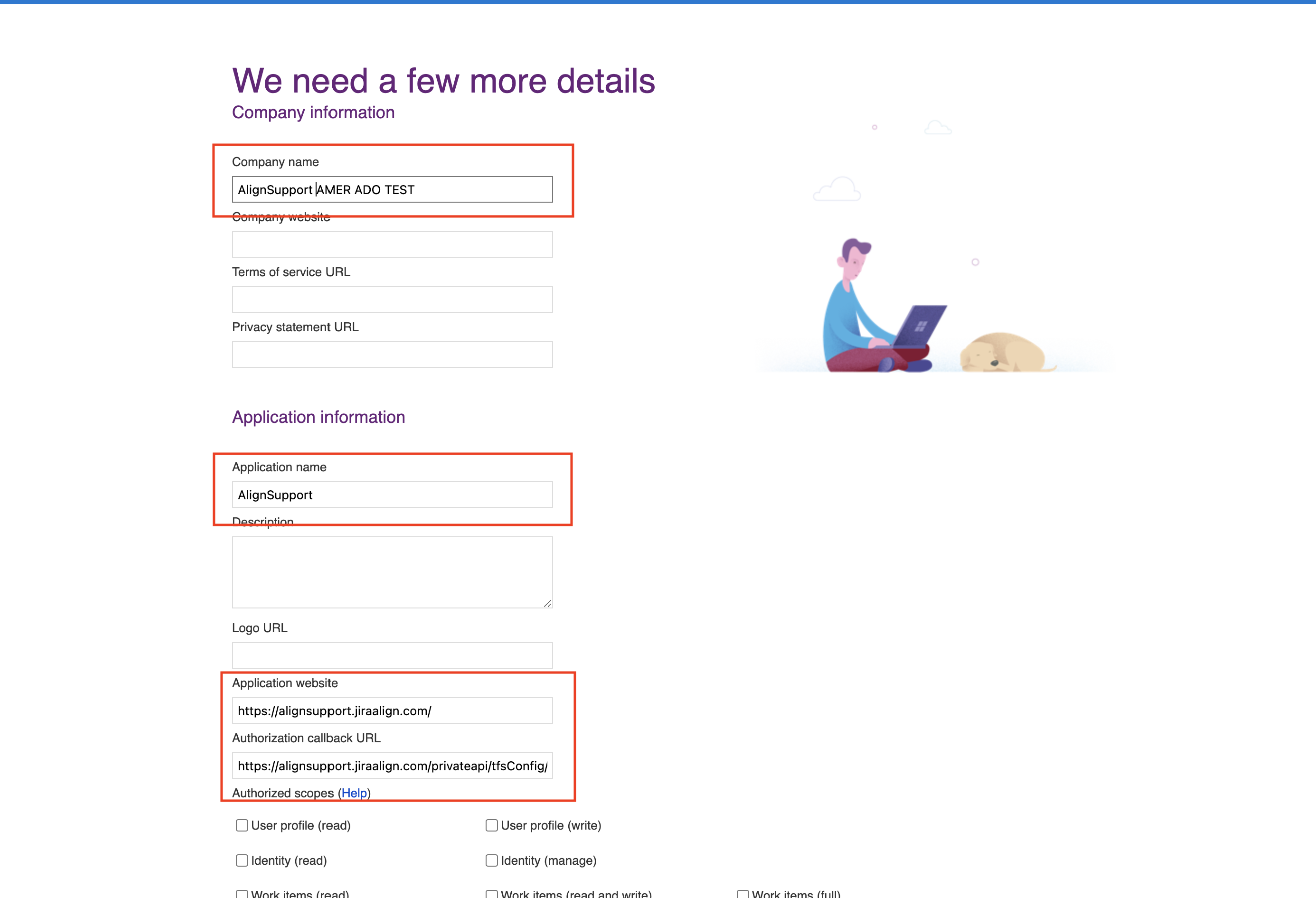

6 - On the new screen, the fields that need to be filled in are:
  • Company name = the name your company uses
  • Application name = the name you want the link to have
  • Application website = the JA URL
  • Authorization callback URL = the URL should be "https:// {yourinstancename}/privateapi/tfsConfig/oauth/callback/", where you change the JA instance path that is on {yourinstancename}

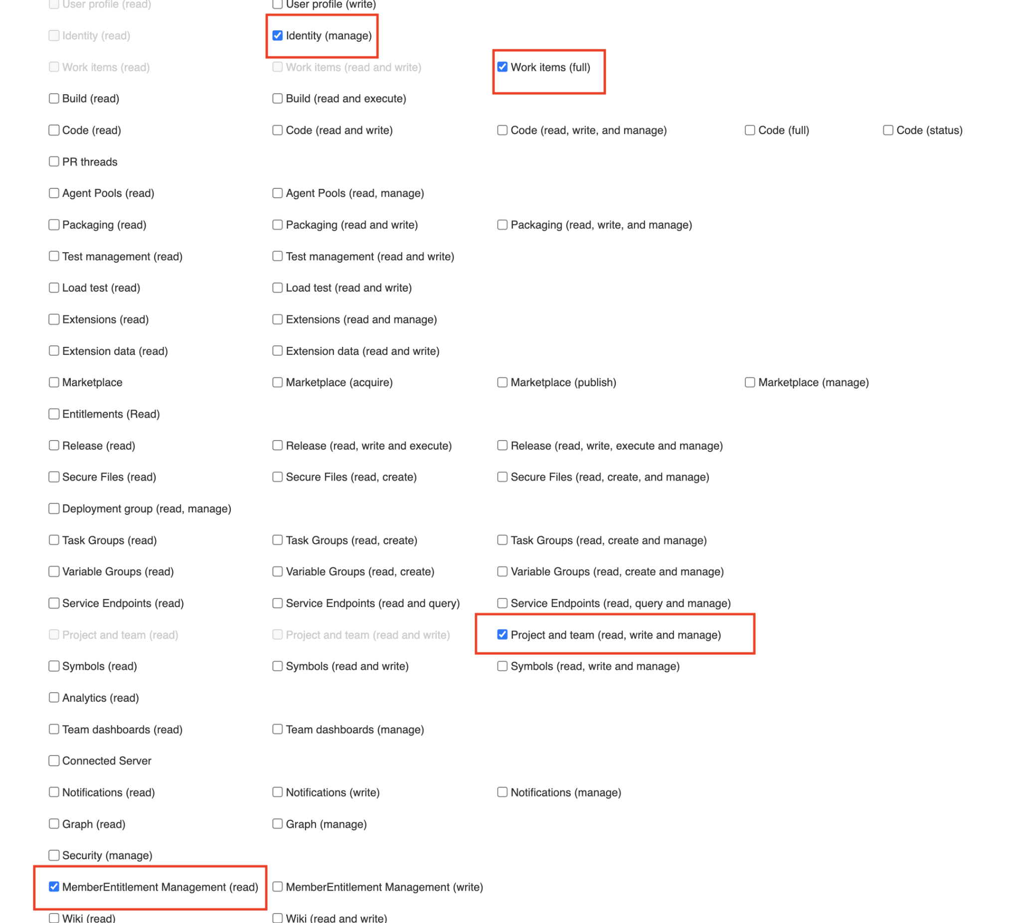

7 - At the bottom of the page, select the required Authorization scopes:
  • MemberEntitlement Management (read)
  • Identity (manage)
  • Work items (full)
  • Project and team (read, write, and manage)

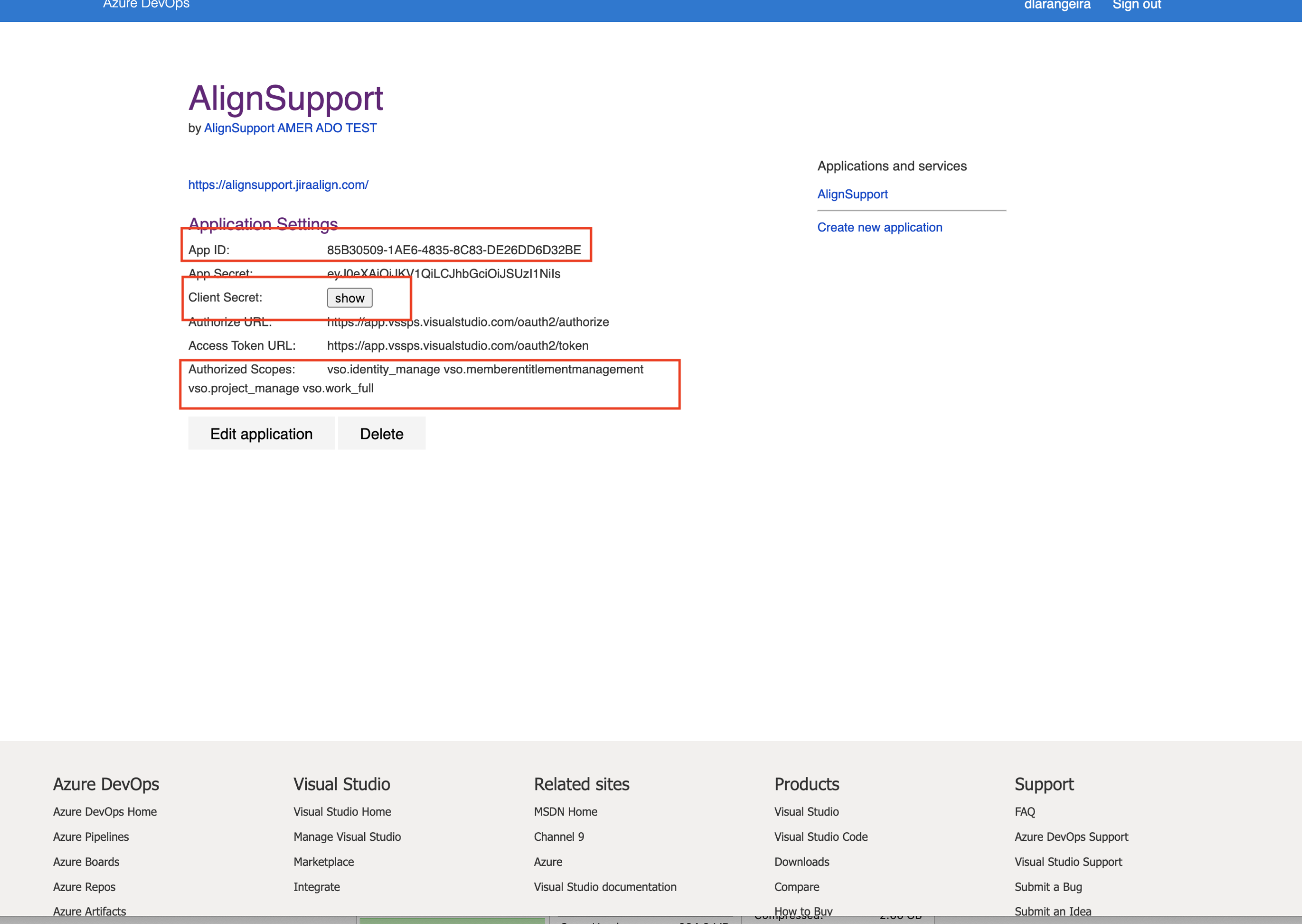

8 - Click Create (at the bottom of the page), and it will show you the details of the link created.
9 - From these details, we will need the APP ID, Client Secret, and Authorized Scopes

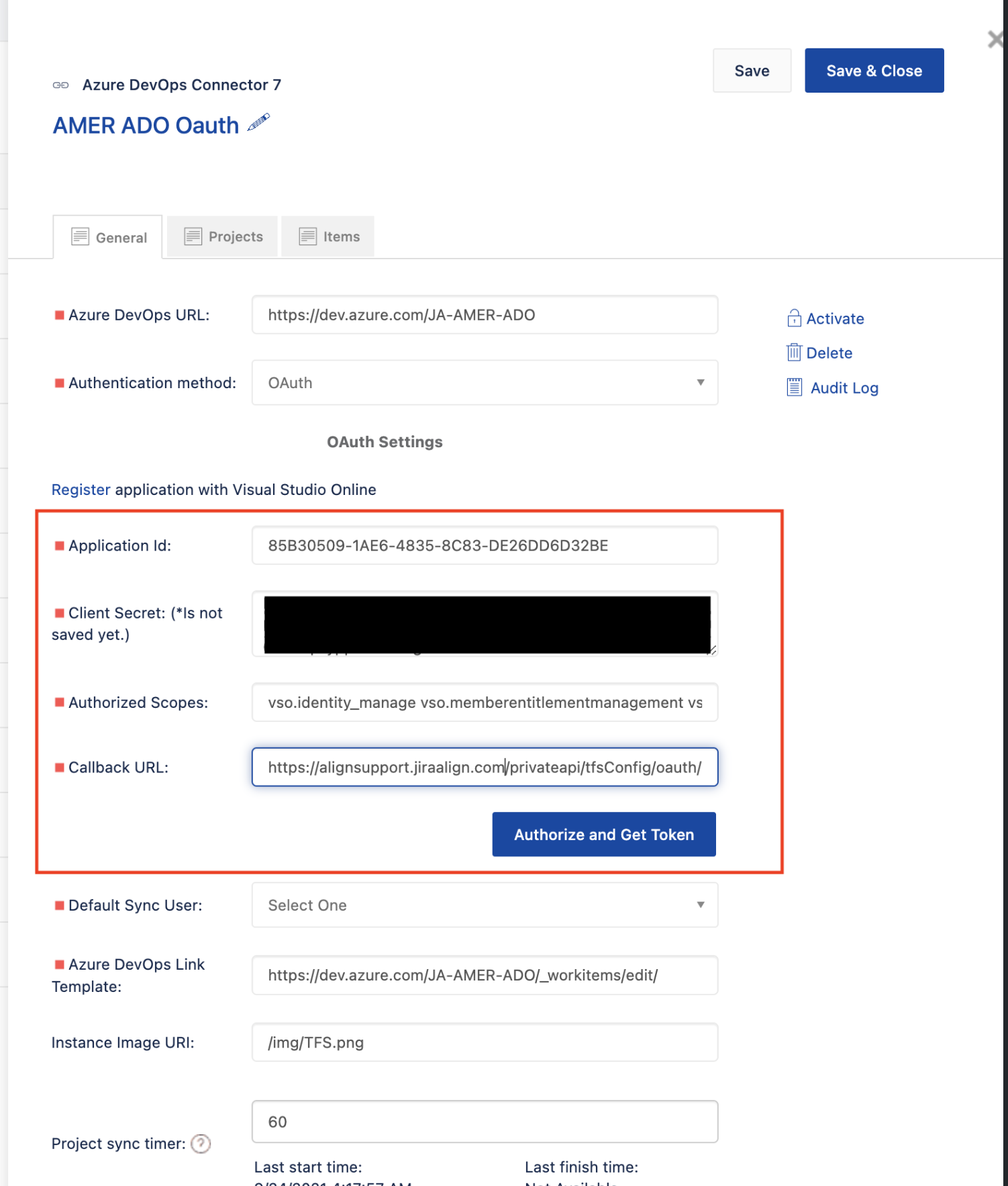

10 - Come back to the JA ADO panel, and fill in the appropriate fields with the data above. For the Callback URL, we will use the same as the one used on the Authorization callback URL.
11 - Click Save to keep the information
12 - Click Authorize and Get Token, which will redirect you to a page to Accept the token/link
13 - After that, come back to JA, and the Authorize and Get Token should change to Re-Authorize And Get Token (if it didn't, hit it once again and/or refresh the screen).
14 - At this point, if no errors were observed, the configuration for the OAuth is complete. You can now finish the configuration of ADO as normal, and activate it.

Once done, you can see the details on the link created by going to: https://app.vssps.visualstudio.com/profile/view
On the left side, under Authorizations, you can see the authorizations that exist and their grants, under Applications and Services you can find the ones created with the details from Step 9 (and edit/update them as needed).
Here you can confirm as well that the user is correct and that the instance of ADO where this was created is the one expected.
