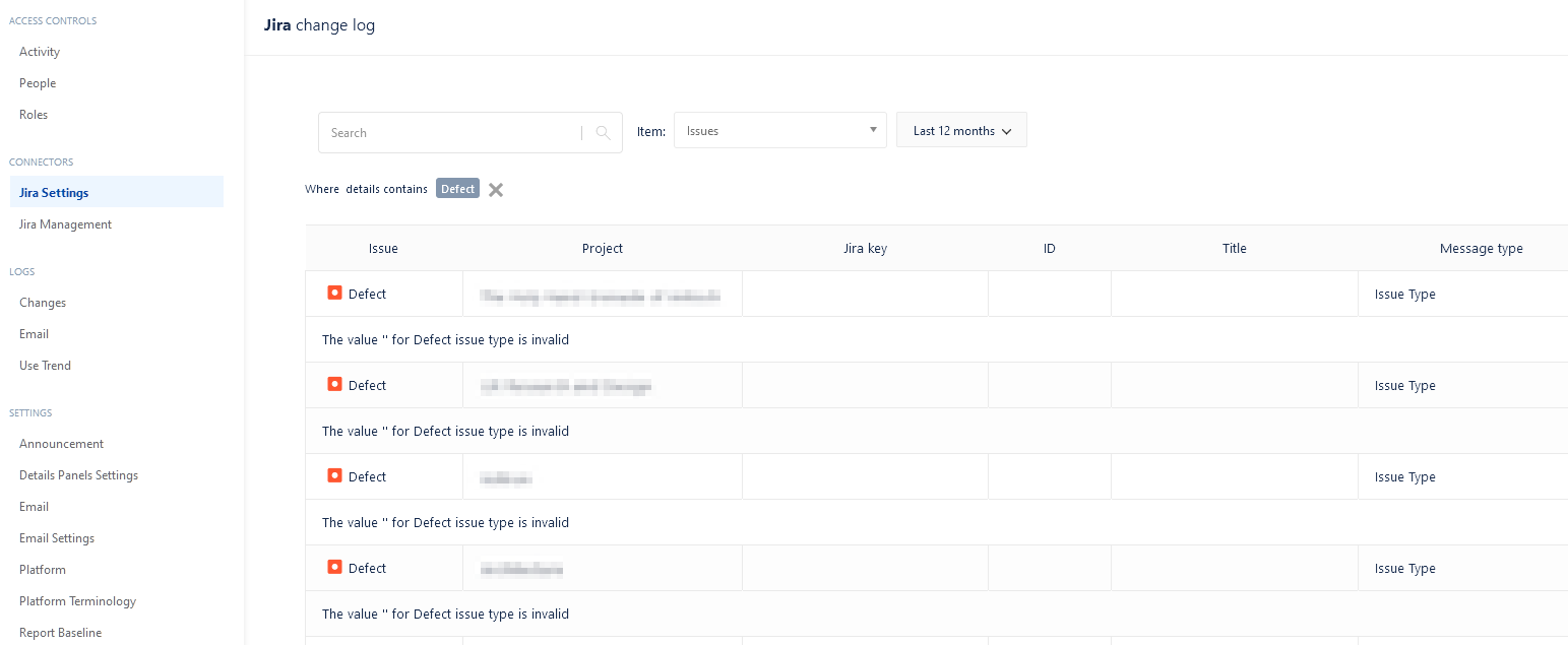

The following error is reported in the Jira change log:
"The value '' for Defect issue type is invalid"
Environment
Diagnosis
The following error is reported in the Jira change log under: Settings > Jira Settings > Manage Projects tab > View Logs button
