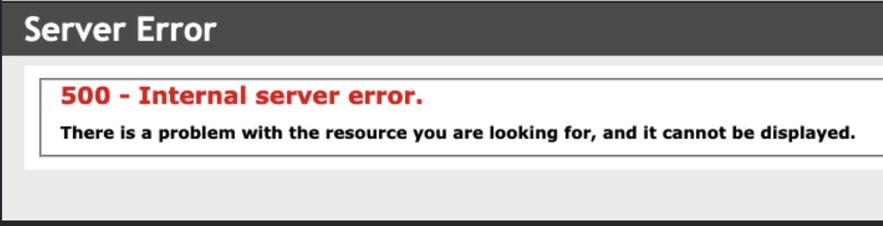

    • Access your API application (Swagger): <Your Jira Align URL>/rest/align/api/docs/index.html
    • Blocked by error 500
  • Error message sample:

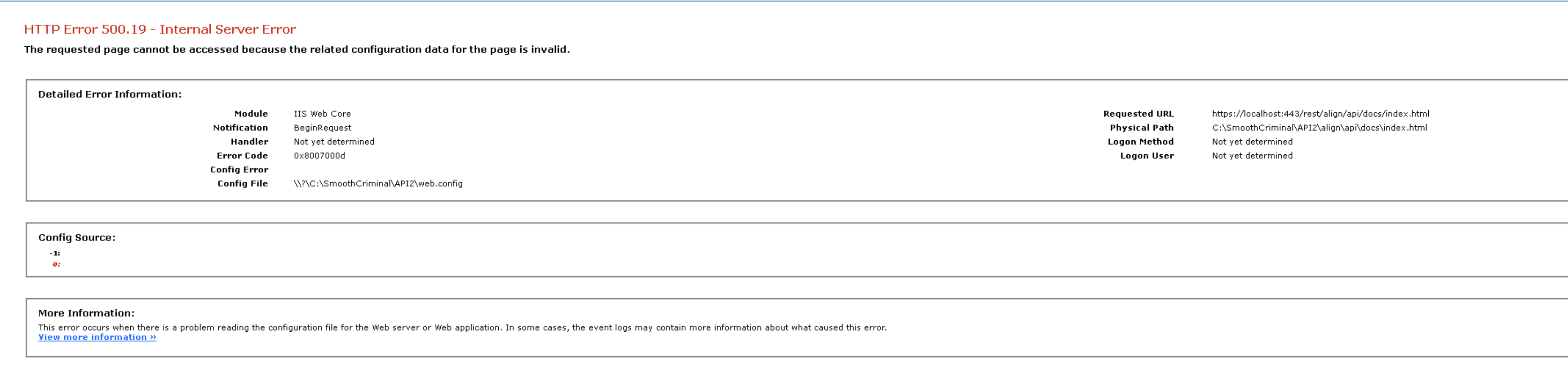

    • Error 500.19 once you’re using detailed errors with the following points:
      • Error Code = 0x8007000d
      • Config Error = Empty value
      • Config Source = No line reference or -1 and 0 (Meaning the error is before the webconfig opening)

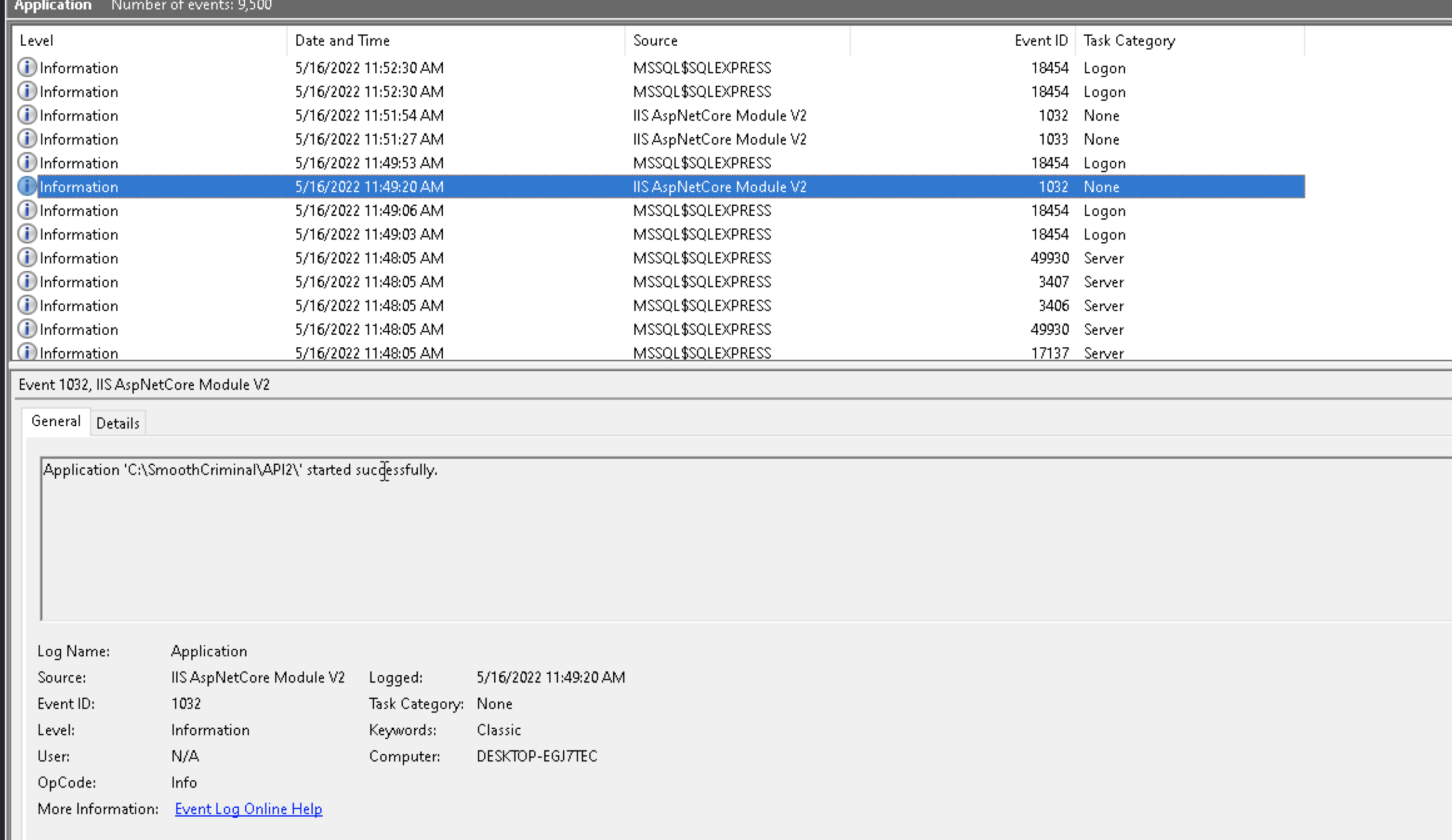

      • Missing the entry C:\EnvironmentName\API2 started successfully by the IIS AspNetCoreModuleV2 into Event Viewer

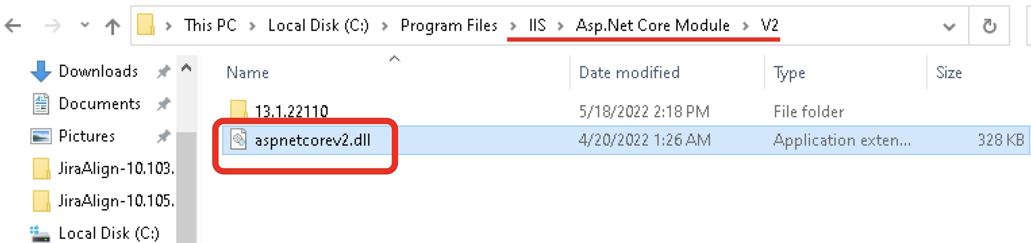

      • Missing the IISAspNetCoreModuleV2 DLL (Aspnetcore2.dll) installed into IIS folder
