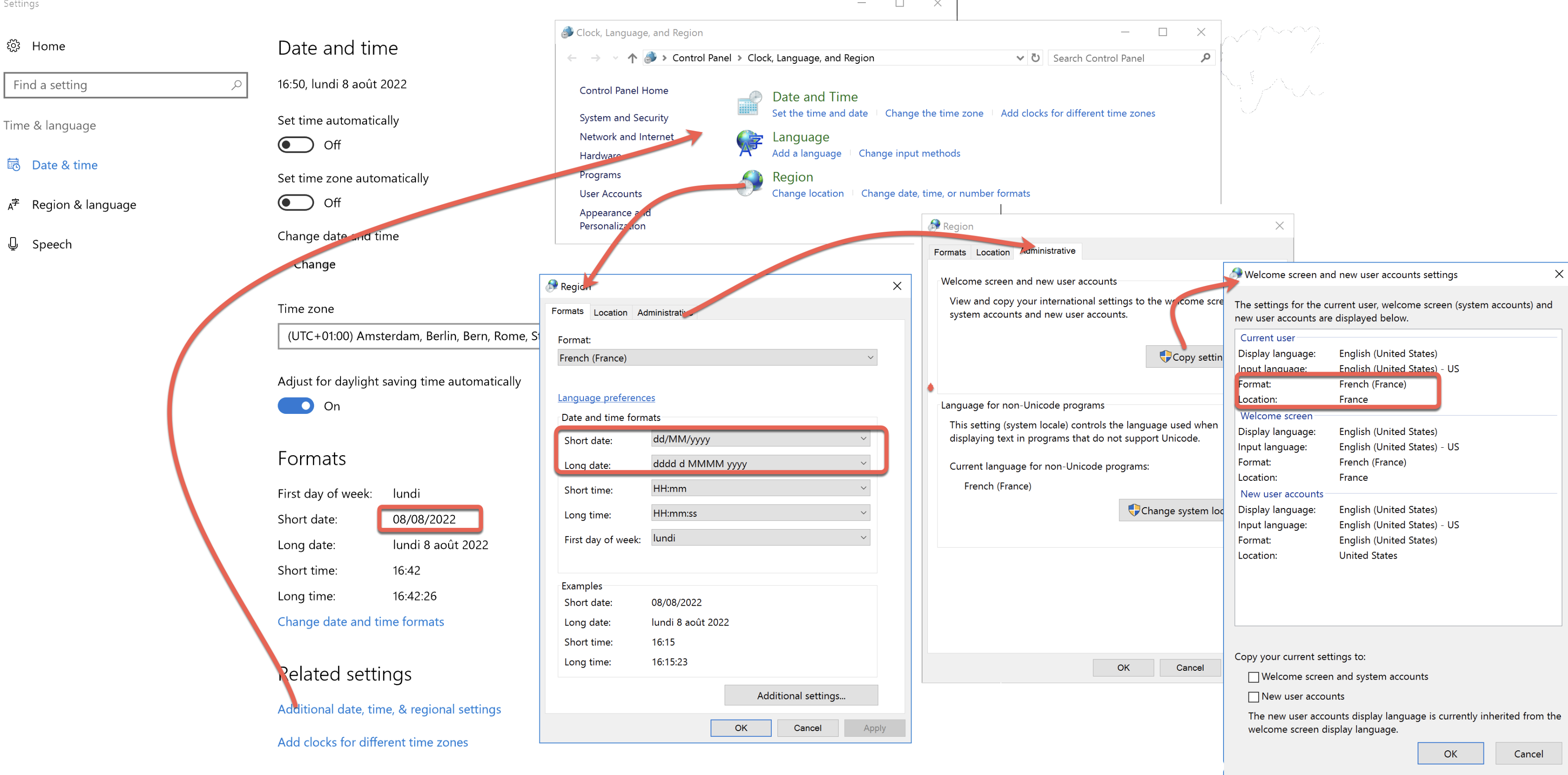

The current Windows System-locale settings, where the Jira Connector service runs, are set to use a different format than English (United States) under Control Panel > Region.

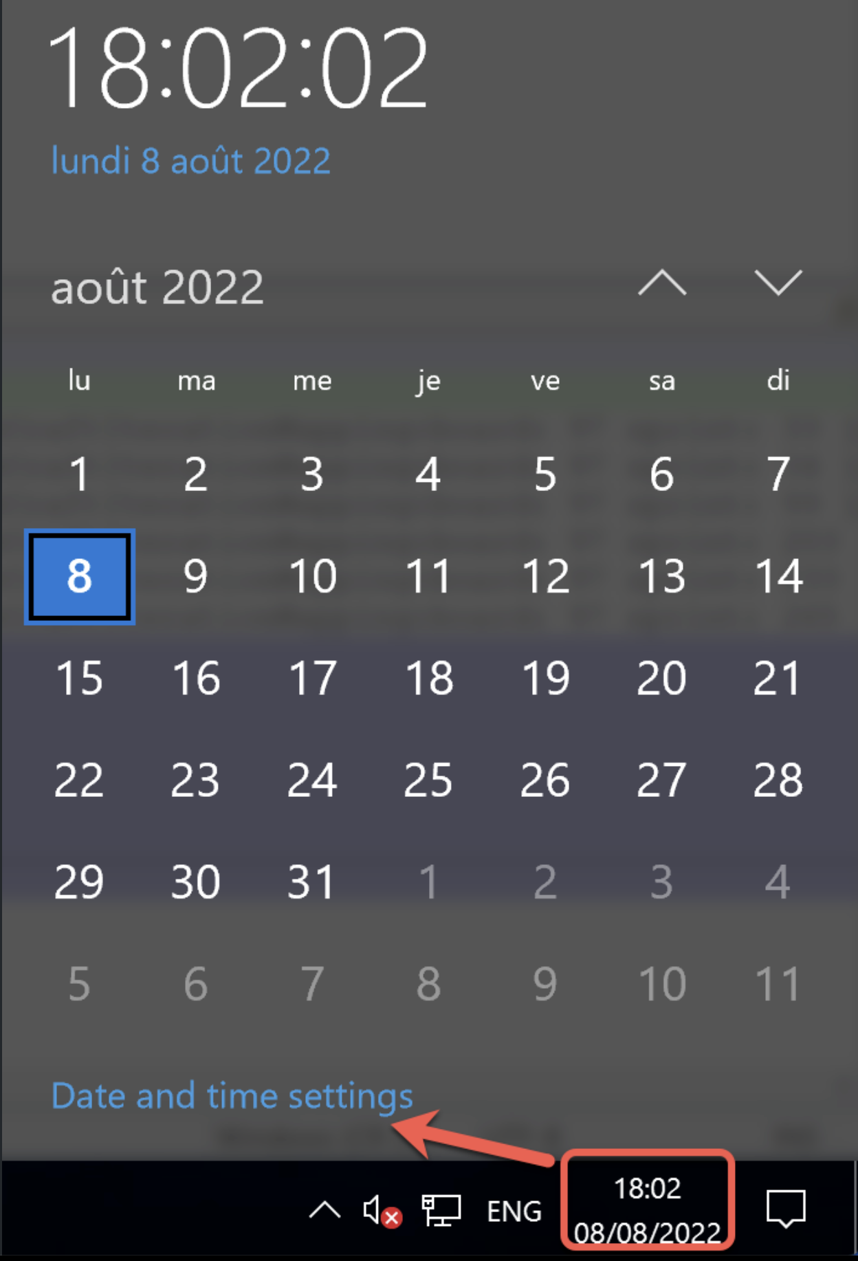

For example by going to the date and time section of the Windows taskbar:

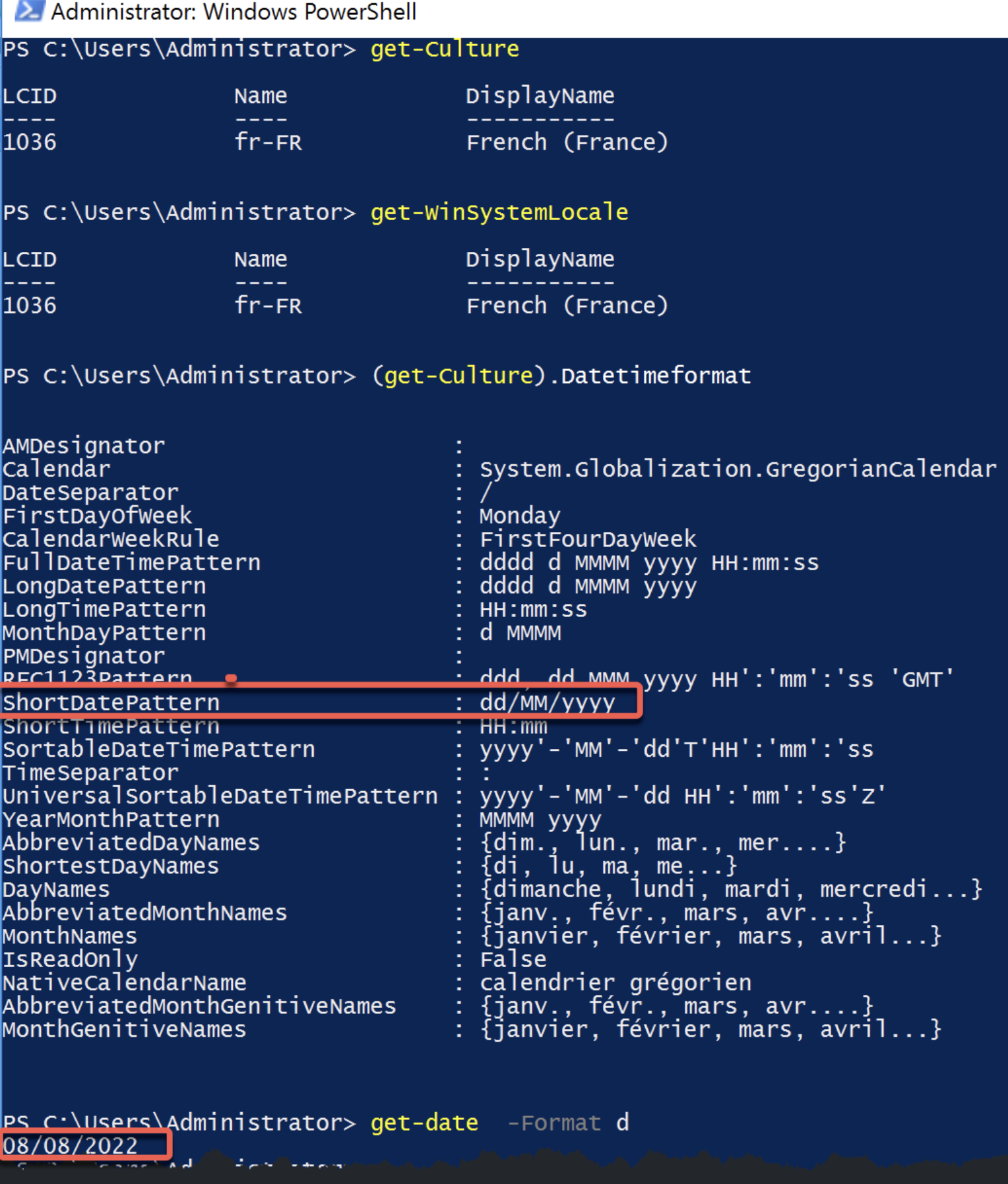

Or from a Windows PowerShell:

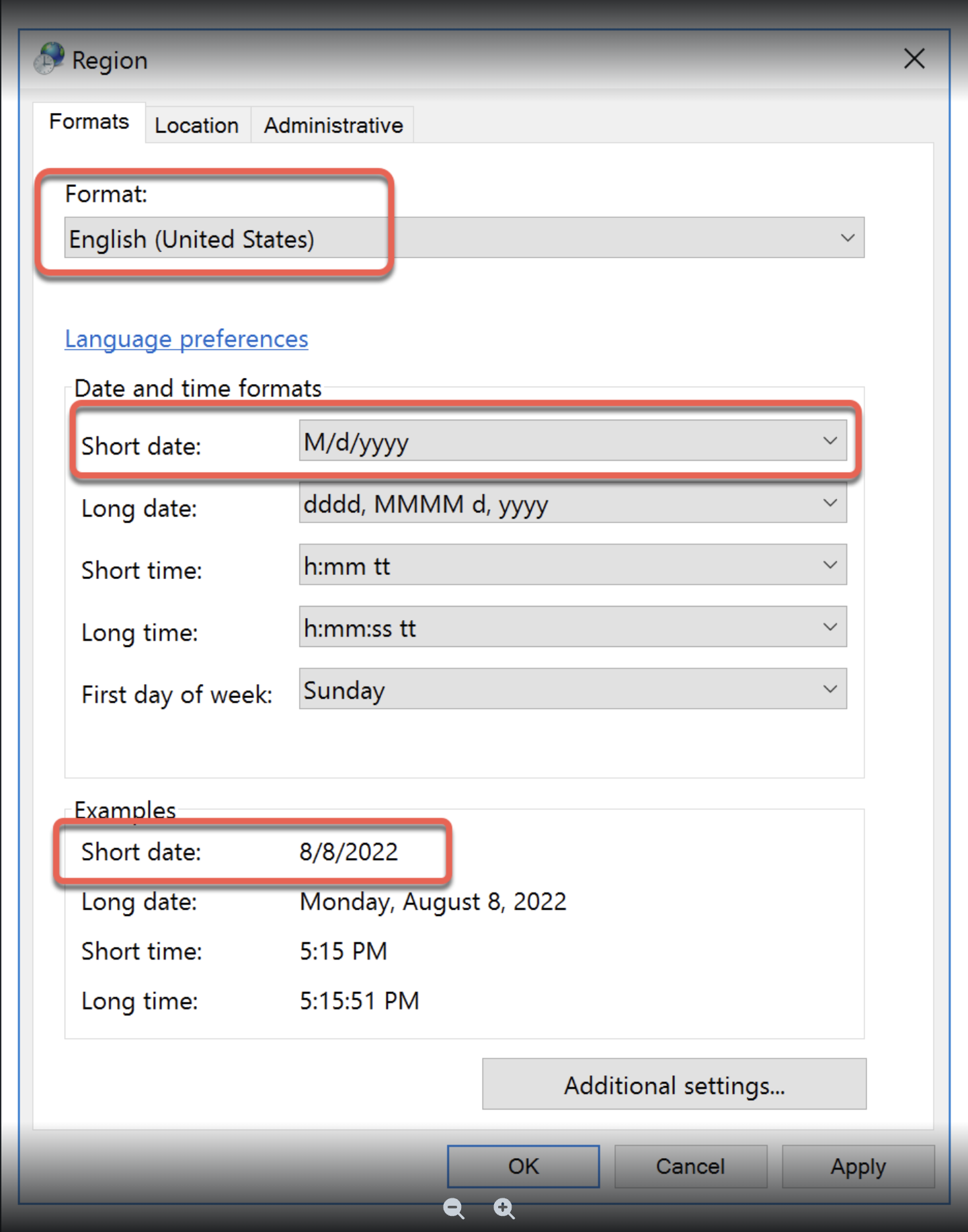

1- Set the Region Format to use English (United States) for the Windows local system or for the user running the Jira Connector Service.

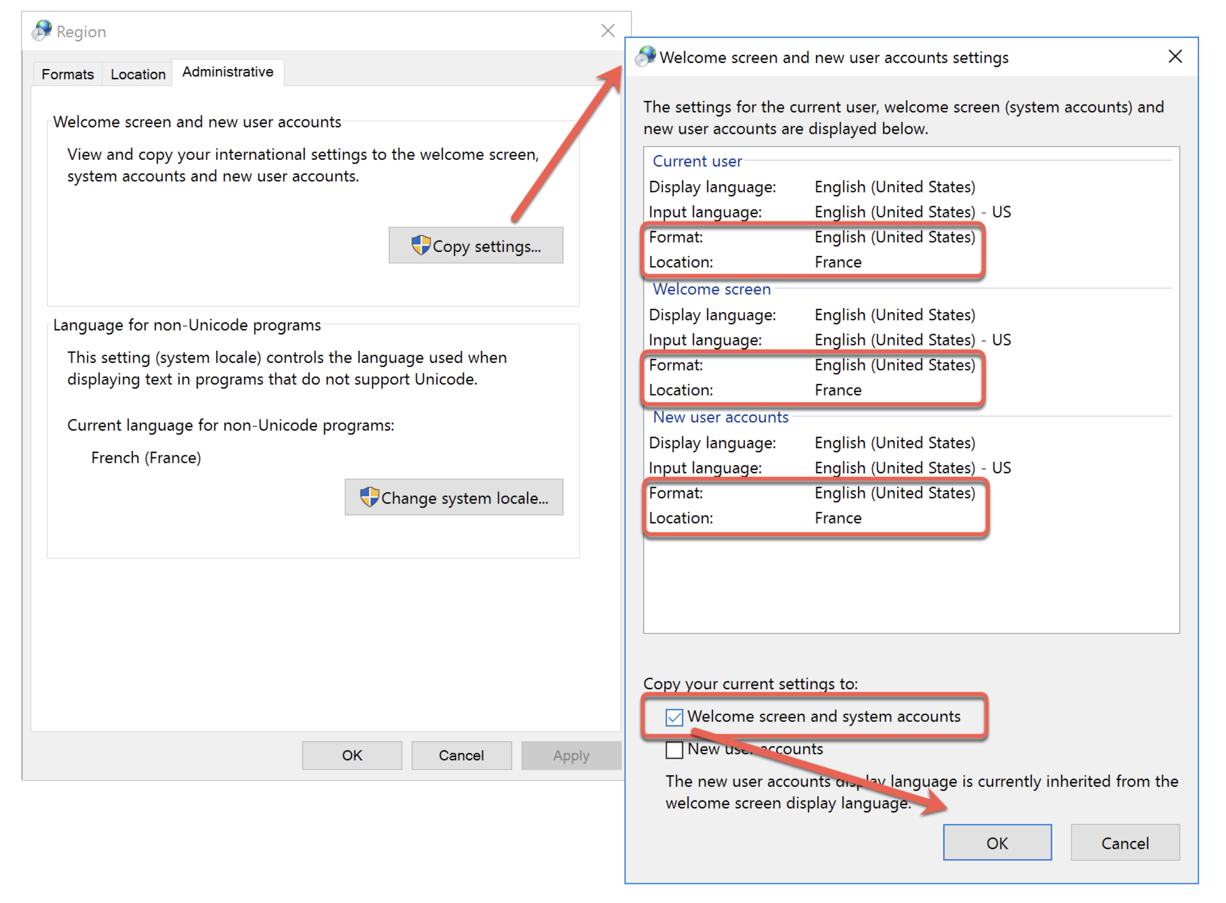

2- Copy the settings to the Welcome screen and system accounts:
Format change:
Administrative settings copy:
Without copying the settings the change is not taken into account.

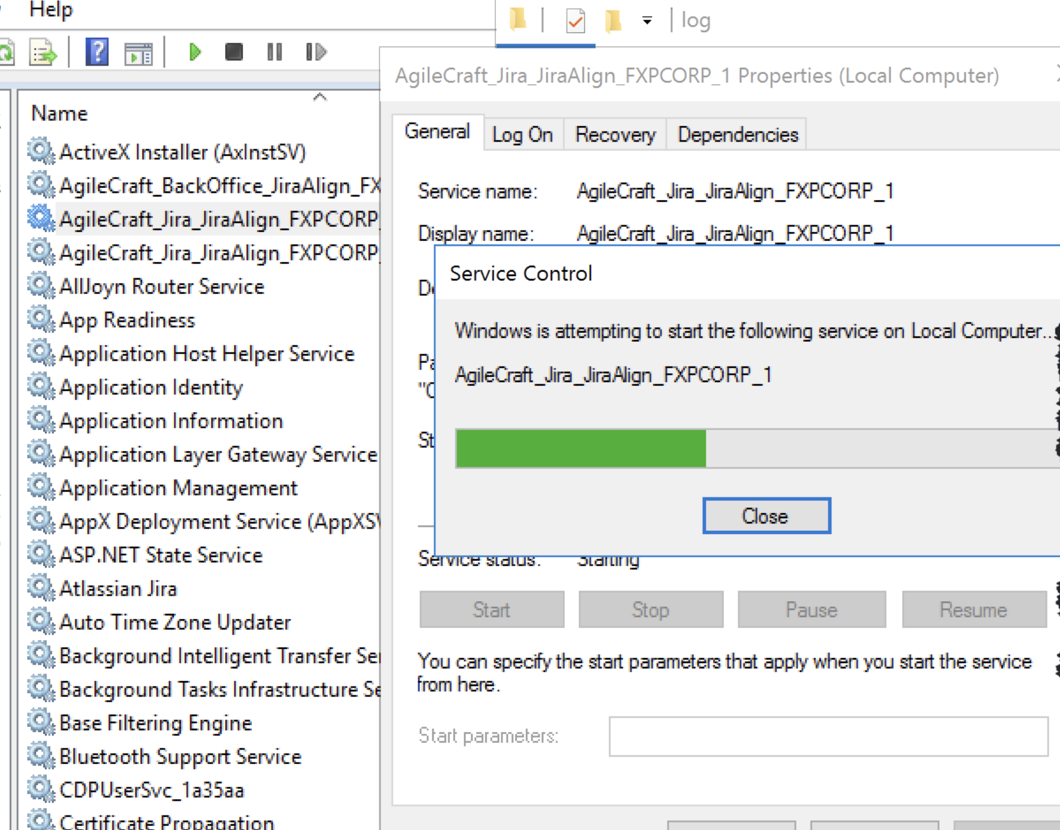

3- Once this is done, stop and start the Jira Connector service so that the changes are taken into account.
You may have to reboot the machine for the settings to take full effect.
