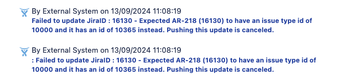

  • The Jira Align Audit log of the Feature may show an entry by External System containing text similar to
    "Failed to update JiraID : 16130 - Expected AR-218 (16130) to have an issue type id of 10000 and it has an id of 10365 instead. Pushing this update is canceled."
    ℹ️ This message will only be seen if a sync from Jira Align into Jira has been attempted since the mismatch began.

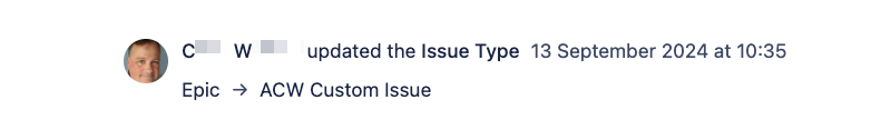

  • The Jira History log of the linked issue with the custom issue type shows that a "User updated the Issue Type" changing it from Epic to another type

The Jira issue was initially created as an Epic and this was synchronized as a Feature into Jira Align. Then a Jira user moved the Jira issue, keeping the same Jira project relationship but specifying a different Issue Type during the move operation.
As Jira Align does not support multiple issue types being connected at the feature level, this change of issue type is not shown in Jira Align and sync operations from Jira Align back into Jira will fail.
