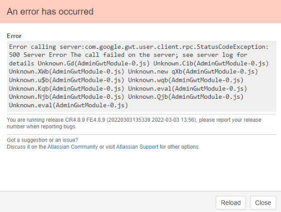

When accessing the repositories page under Administration, the following message is displayed on screen:
An error has occurred Error Error calling server:com.google.gwt.user.client.rpc.StatusCodeException: 500 The call failed on the server; see server log for details Unknown.p6b(Unknown Source) Unknown.$8b(Unknown Source) Unknown.Xyb(Unknown Source) Unknown.zzb(Unknown Source) Unknown.<anonymous>(Unknown Source) Unknown.etb(Unknown Source) Unknown.htb(Unknown Source)
A similar error is seen on UI:

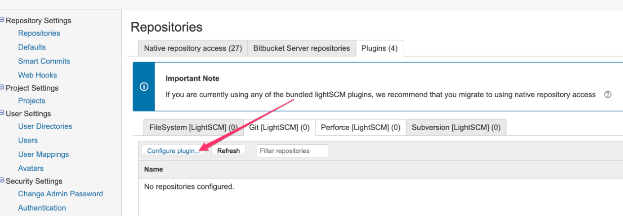

The issue is with the Git LightSCM configuration:
In Fisheye 4.8.9 the repos added under the Git Light SCM are not being loaded and are throwing the error in the UI. When loading the Administration page the default page that loads up is the Repository settings > Repositories and that's where the configuration for the Git Light SCM is found and hence the error.
